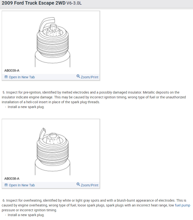

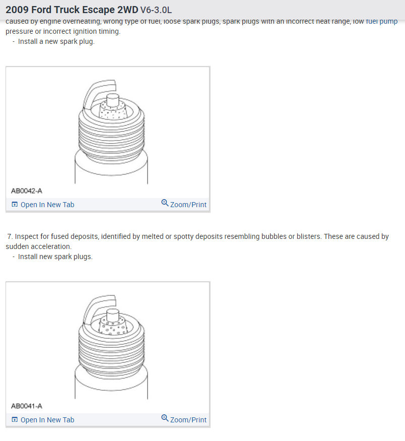

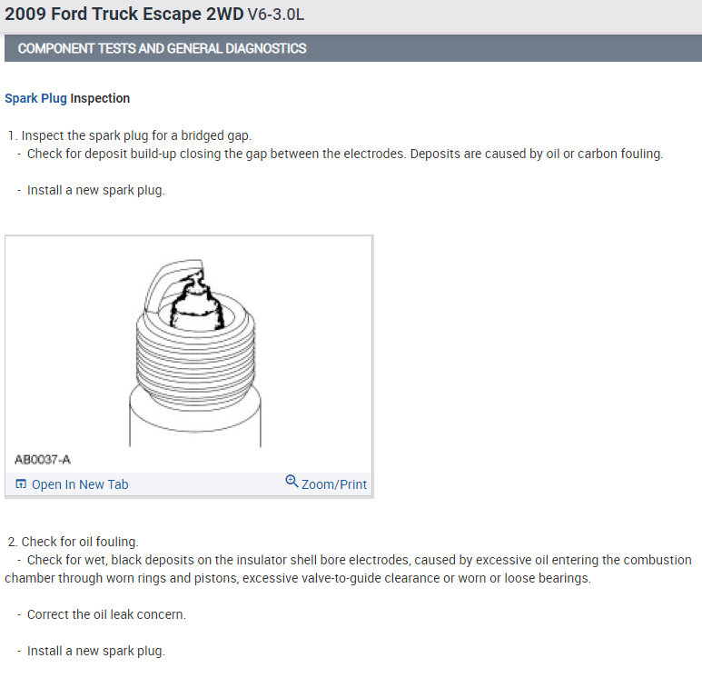

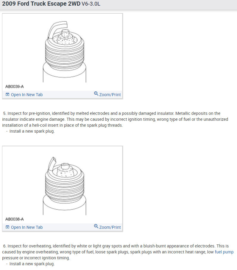

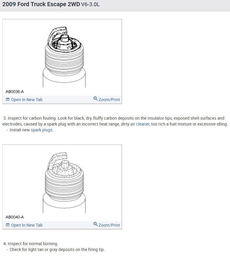

So after switching out with a working coil, you still have no spark.
Have you checked the spark plug? It does sound like the plug could be the issue.
Try changing out the spark plug on that cylinder and see what happens.
You might find this article helpful:
https://youtu.be/QTE8k06MzwQ
I have attached a basic inspection guide for spark plugs.
Please let me know the outcome.
