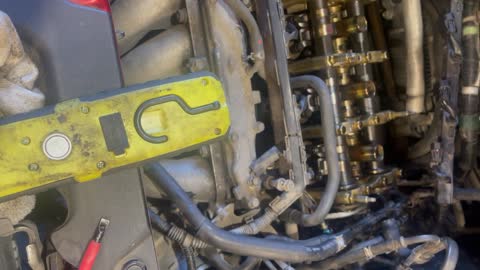

fires on one cylinder, won't start. Check fuel pressure, good. Checked spark to all cylinders, good. Pulled fuel rail with injectors intact, all squirting fuel. Replace cam sensors and crankshaft sensors. Any ideas? And checked fuses.

The compression was from 145 to 150 on all cylinders. Could it be the VTEC solenoid?
Apr 5, 2025 at 6:42 AM
  • 55,433 POSTS

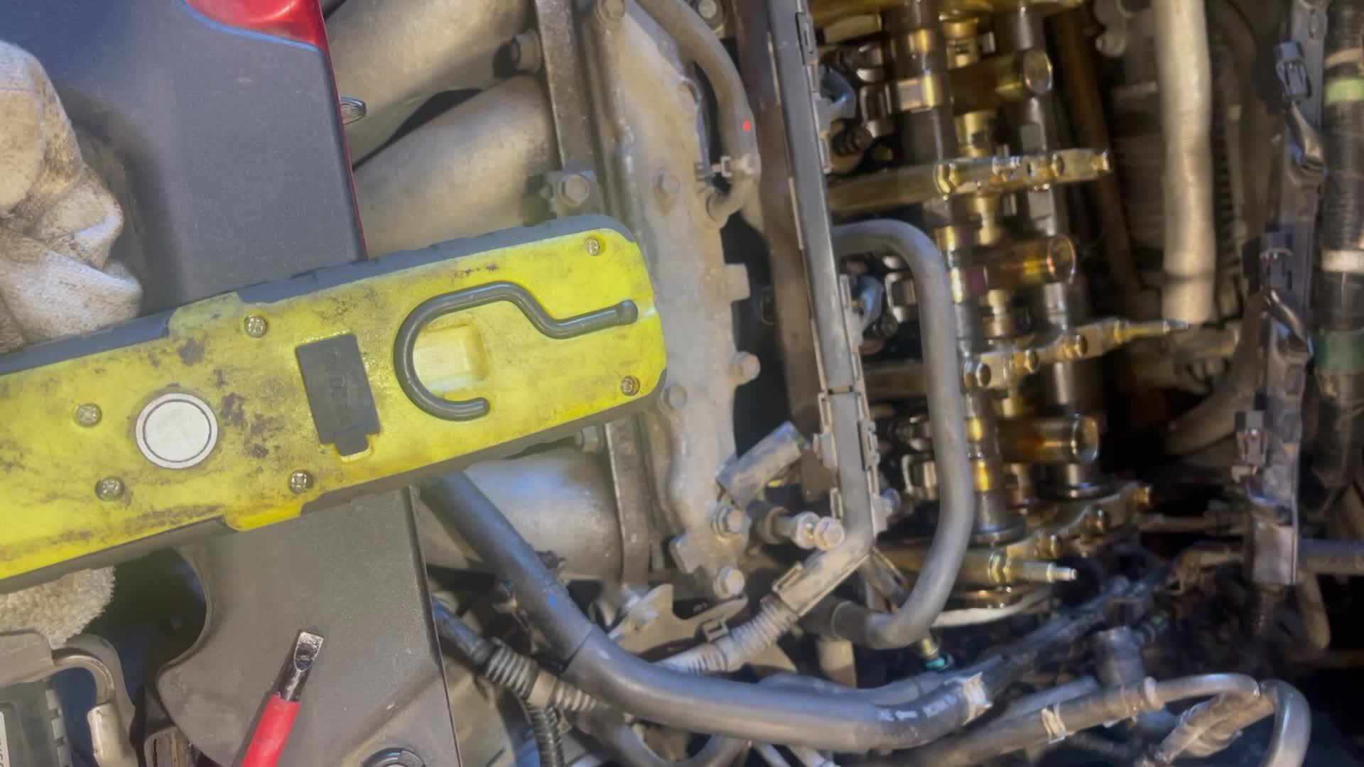

Yep, it sounds good, thanks for the video. It could be the VTEC system, I see you have the valve cover off can you see the VTEC system engaged? Did you ever run the codes to see if any are stored?

No codes stored that is what is puzzling. Just to recall my original post. Son-in-law said it wouldn't start. Towed it to a shop and they replaced the fuel pump. He started it right up and drove it home. Next day wouldn't start again. I would have thought it might be out of time but since it started at the shop and drove home that kind of ruled that out. How do I tell if the VETEC is engaging?
Apr 6, 2025 at 10:26 AM
  • 55,433 POSTS
You can tell if the VETEC valve is working along side of the regular intake valve will be operational. So, to recap, you have compression, fuel and spark with pulses from the exhaust so we know that it is not clogged, and the engine will not run, correct?
