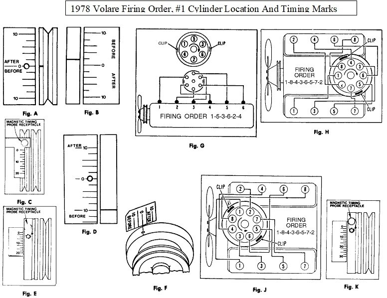

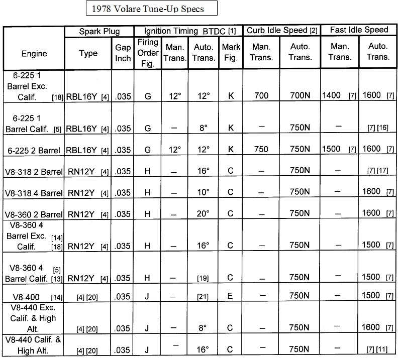

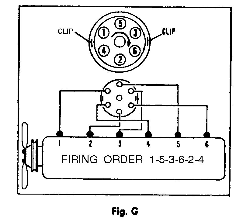

What is the firing order on engine and location number 1 cylinder?
1978 PLYMOUTH VOLARE
665,509 MILES • 6 CYL • 2WD • AUTOMATIC
STUU NU
MEMBER
1 POST
Tried too many times to get firing order location of cylinder #1.
Nov 11, 2022 at 8:21 AM
CARADIODOC
Experienced Mechanic
34,414 POSTS
These can be hard to read. I'll expand the six-cylinder drawing and post it for you shortly.
