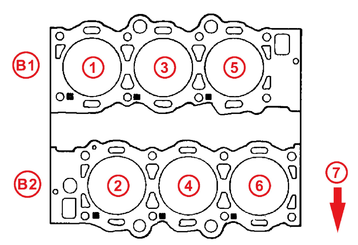

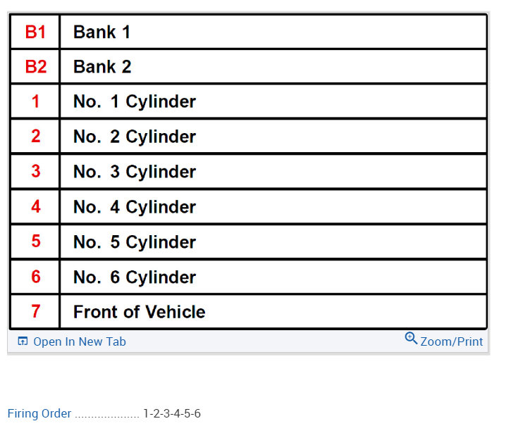

Need the firing order for the vehicle listed above.

Hello, it's reading on All Data that the Firing Order is not listed, but this looks correct. Many other Toyota firing orders are 123456.
