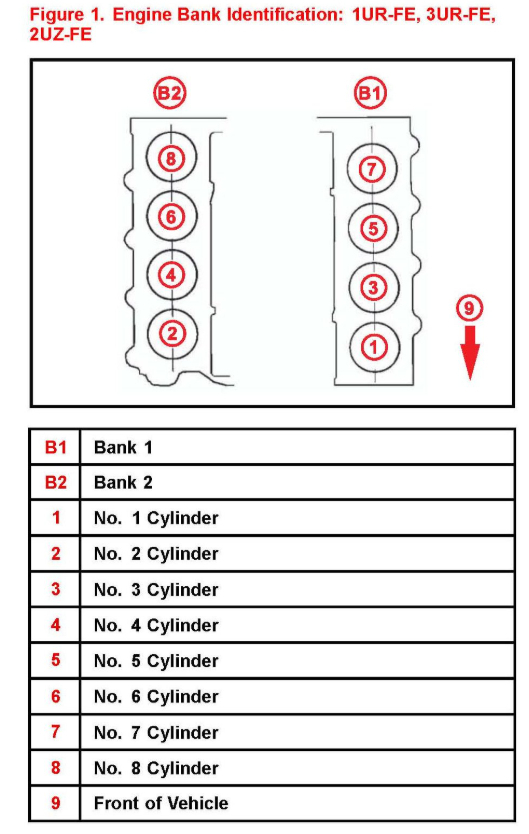

Fire order for 1vd engine?

No problem Firing order?

Hello, I got you on this, here is the engine ignition firing order.
1-8-4-3-6-5-7-2 which is the same on a chevy V8 engine.
Check out the images (below). Let me know if you need anything else.
Image (Click to enlarge)
