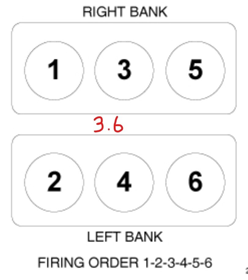

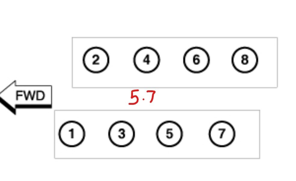

Which is cylinder one please?
2014 DODGE DURANGO
138,000 MILES
ANGEL17
Fire diagram.
Apr 3, 2025 at 8:57 PM
STEVE W.
  • 15,200 POSTS
On the 3.6 it is the right front cylinder. On the 5.7 it is the left front cylinder. As shown in the attached.
