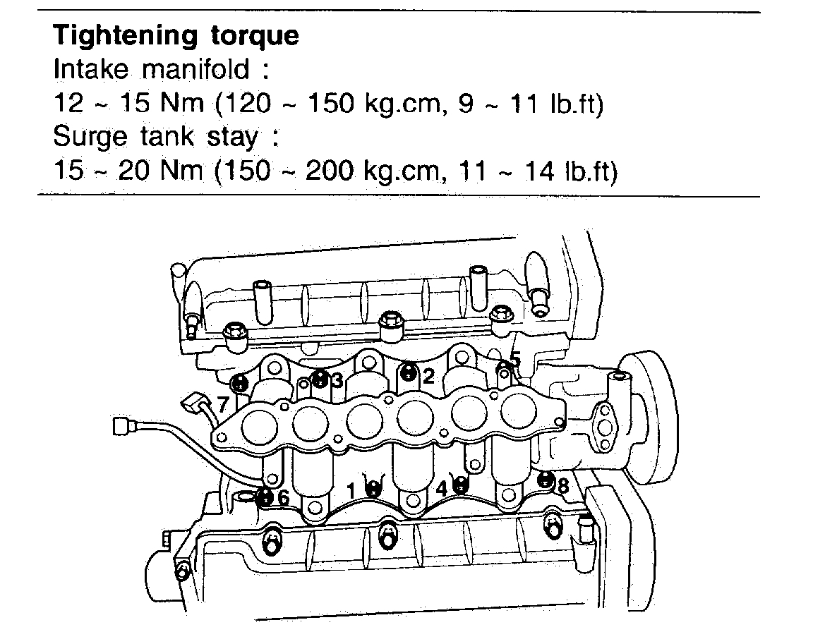

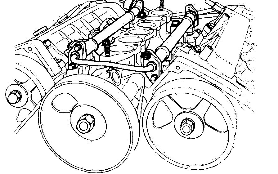

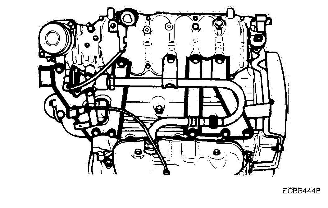

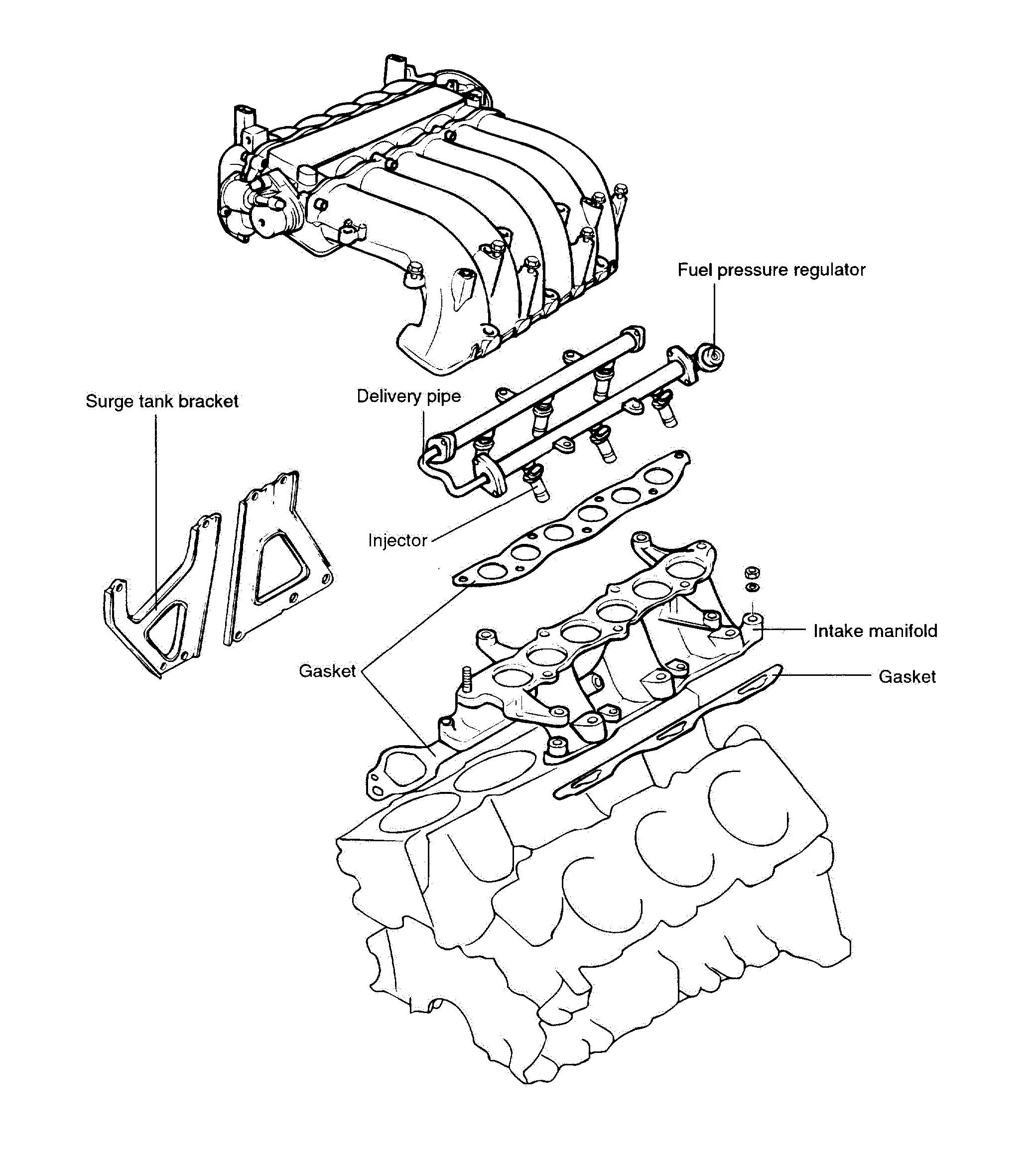

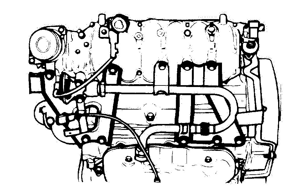

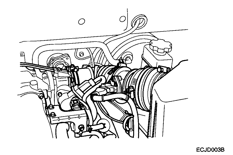

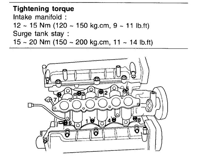

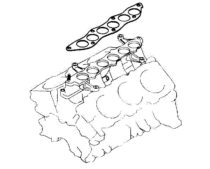

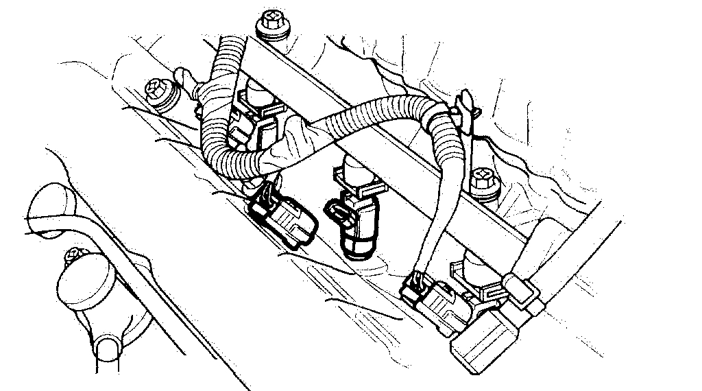

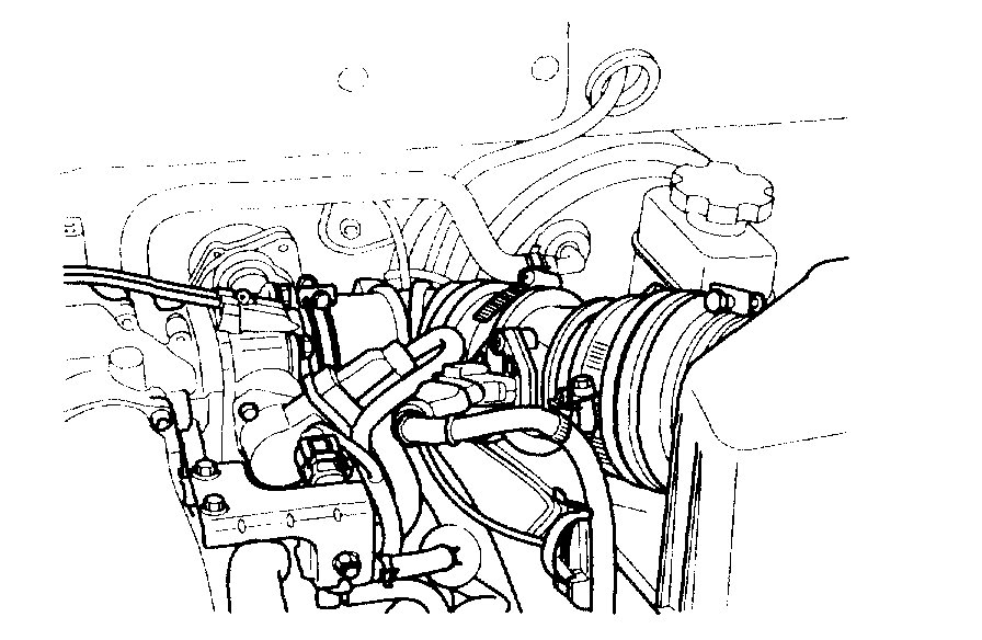

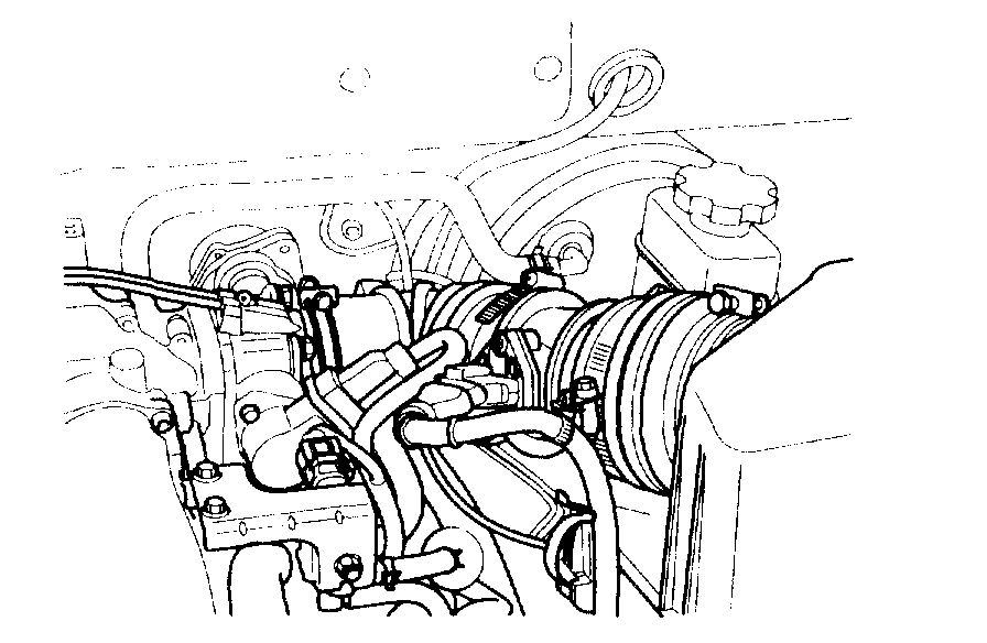

Yes, but where did it come from. I am going to provide the directions for removal of the intake. The attached pics will correlate. See if you can pinpoint where it was located. If you still have the broken part, can you take a pic of it and upload it for me?
__________________________
2005 Hyundai Truck Santa Fe V6-3.5L
Procedures
Vehicle Engine, Cooling and Exhaust Engine Intake Manifold Service and Repair Procedures
PROCEDURES
INTAKE MANIFOLD
pic 1
COMPONENTS
REMOVAL
pic 2
1. Remove the air intake hose connected to the throttle body
2. Remove the engine coolant hose and throttle body.
pic 3
3. Remove the P.C.V hose and brake booster vacuum hoses
4. Disconnect the vacuum hose connections.
pic 4
5. Remove the surge tank stay.
6. Remove the surge tank.
pic 5
7. Remove the surge tank and gasket.
pic 6
8. Disconnect the fuel injector harness connector.

INSTALLATION
pic 8
pic 9
Install the intake manifold and delivery pipe reversing the order of the removal procedure.
____________________________
Let me know if you can tell which pic or location it was found.

In the first picture the upper intake. It was inside the upper intake on the right side where the throttle body disconnects from it. Does that help?
Feb 16, 2020 at 10:54 AM
  • 110,248 POSTS
By any chance, did you save the part? In that location, there really isn't much. I would think it would have come through the air intake / air box if it was there.
