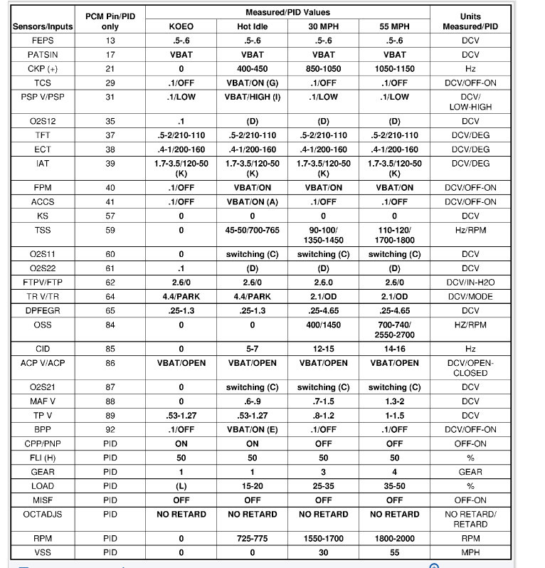

Can I get the pinout for the PCM?
2004 FORD ESCAPE
170,000 MILES • 3.0L • 6 CYL • 4WD • AUTOMATIC
NATEAG
I have to find some possible intermittent in wire going to the PCM.
Aug 12, 2022 at 4:05 AM
  • 55,273 POSTS

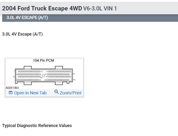

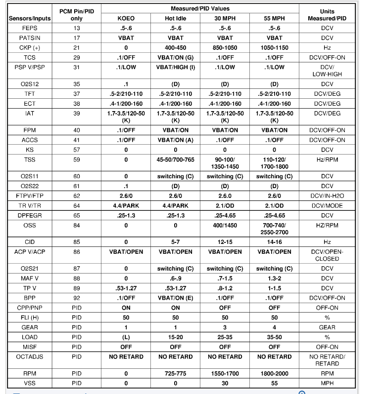

Sure, here is your pinout for the 2004 Ford Escape 3.0 liter engine in the images below. Check out the diagrams (below). Please let us know if you need anything else to get the problem fixed.
Aug 12, 2022 at 5:51 AM
NATEAG
Hi, thank you for your fast reply, Ken L.
Presently i am okay with the picture of the terminal (104 pin) The terminal seems to be exactly similar to my ''4 wd '' Escape 2004, i understand also the similarity of this connector to all Escape 2004 V6 AT 2wd and 4 wd , and probably all those 2001-2004 . Now i am looking at the electrical diagram with the pin number (color if available) and the destination off those wire (coil, injector, IAC, O2.)
Considering my Escape and this electrical diagram, do you need more detail about options of the truck (ABS, etc.).
The second picture you sent me will be helpful later, if i have some particular test to made with this chart .
Thank you , best regards

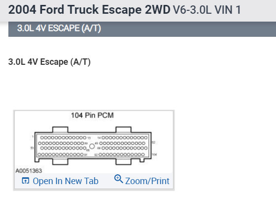

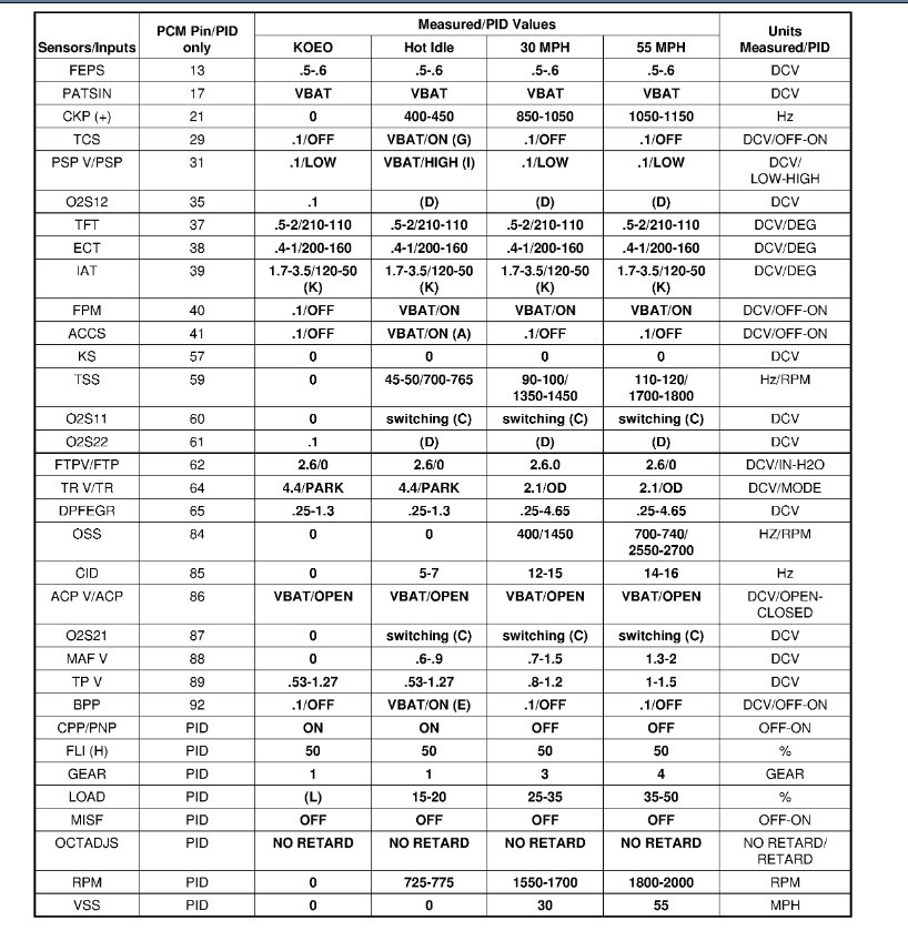

DOH! sorry, here is the 4x4 version.
Aug 13, 2022 at 4:20 AM
NATEAG
Sorry, I have also posted on other section about Escape with electrical diagram.
Hi, I have an Escape 2004 v6 4wd 3,0l , same pinout PCM connector ( 104 pin )...In this tread you have posted here with 8 picture , is this diagram for 2wd is applicable to my escape 2004 4wd ? Or do we have to find a new one specially applicable for the 2004 version ... I need more explanation on this aspect about those diagrams please?
Concerning my case, i have taking the first step to begin to check the '' Ground Wire '' of the motor and PCM , to be sure of all good connection . My truck have been shooted with oil since the beginning, but some loose or broken wire can induce some intermittent problem with misfire in acceleration ... Something sure presently i have some intermittent noise pickup over the air on weak radio station on the AM band . I have all ready change the antenna kit . same result ... When the truck was newer no noise was present...
Thank you
Aug 15, 2022 at 1:52 AM
  • 55,273 POSTS
If the pin out is the same, then there is no difference between 2wd and 4wd. For the radio problem please post your new question here, you must be logged in.
