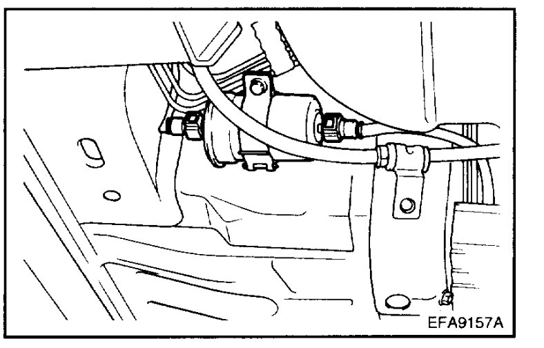

Can't find the fuel filter. some sites show it is in the gas tank other show it is inline, but none give a good description where the inline one is.
Jan 28, 2023 at 8:56 AM
  • 110,240 POSTS
On this vehicle, the fuel filter is an inline filter. The fuel filter is located underneath the chassis on the left-hand side of the fuel tank.
I attached a pic below showing its location. See pic 1. Also, here is a link you may find helpful:

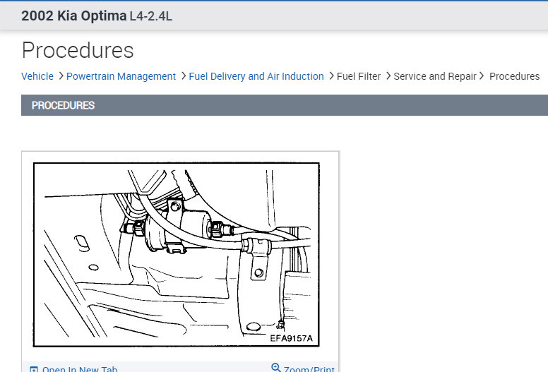

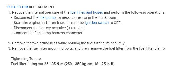

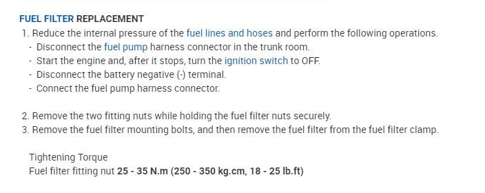

The remaining pictures are the directions for the removal and replacement specific to your vehicle.
