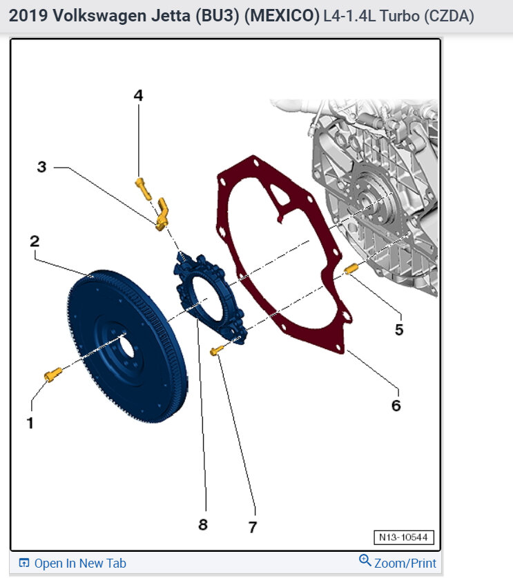

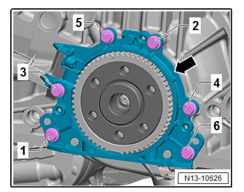

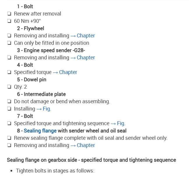

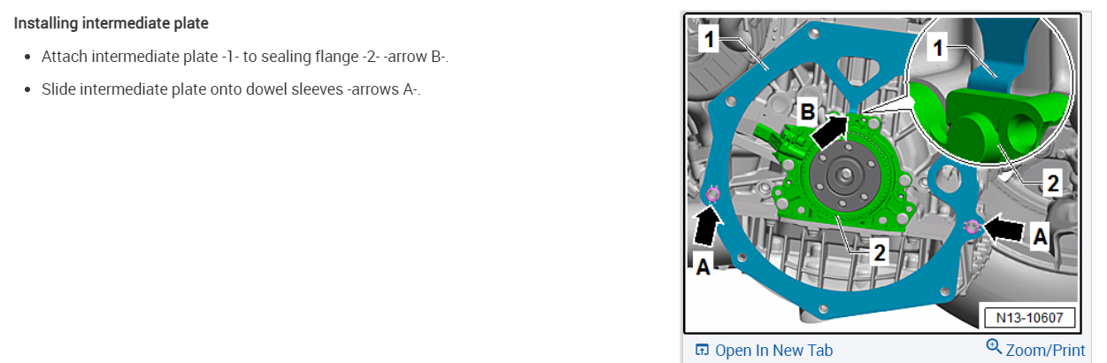

Car has p0017 code. replaced both camshaft sensors looking to replace crankshaft sensor but can't find a diagram,
Oct 6, 2023 at 3:04 AM
  • 55,721 POSTS
They put the crankshaft position sensor in a good spot, in-between the engine and transmission. so, the transmission will need to be removed and the flywheel will need to come off. Check out the images (below). Please let us know if you need anything else to get the problem fixed. Sorry about that.
