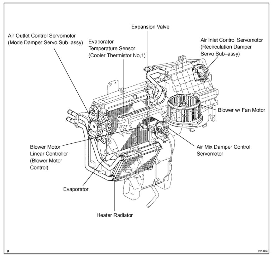

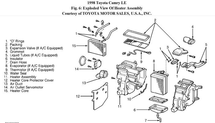

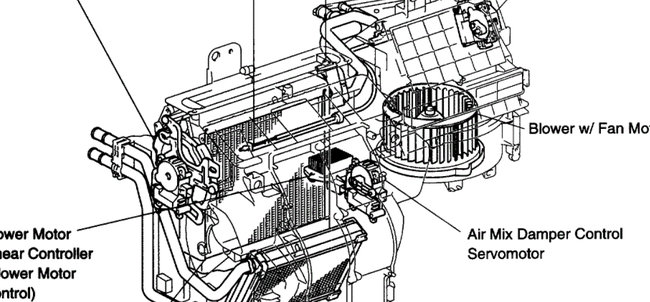

the blend door actuator appears to have failed, and I would like to know where it is and how difficult to remove. I have an Australian RHD version Altise
Regards and thanks in advance
Jan 7, 2016 at 5:07 PM
Here are the blend door actuators for your car. Check out the diagrams (Below). Please let us know if you need anything else to get the problem fixed.

RAYZA
That image appears to show a different model, I do not have a blower fan or heater controls under the bonnet, my car has all that stuff behind the dash

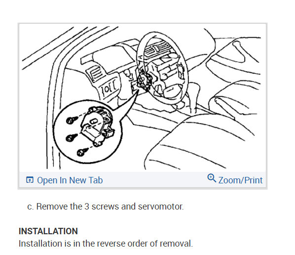

ac airflow mode does not change. Now it stays blowing front, can not change to floor or any other mode.
Dec 17, 2020 at 5:15 AM (Merged)
KHLOW2008
  • 41,814 POSTS
Check the air outlet servomotor. It is most probably stuck and not changing the air mode. Check out the diagrams (Below). Please let us know what happens.

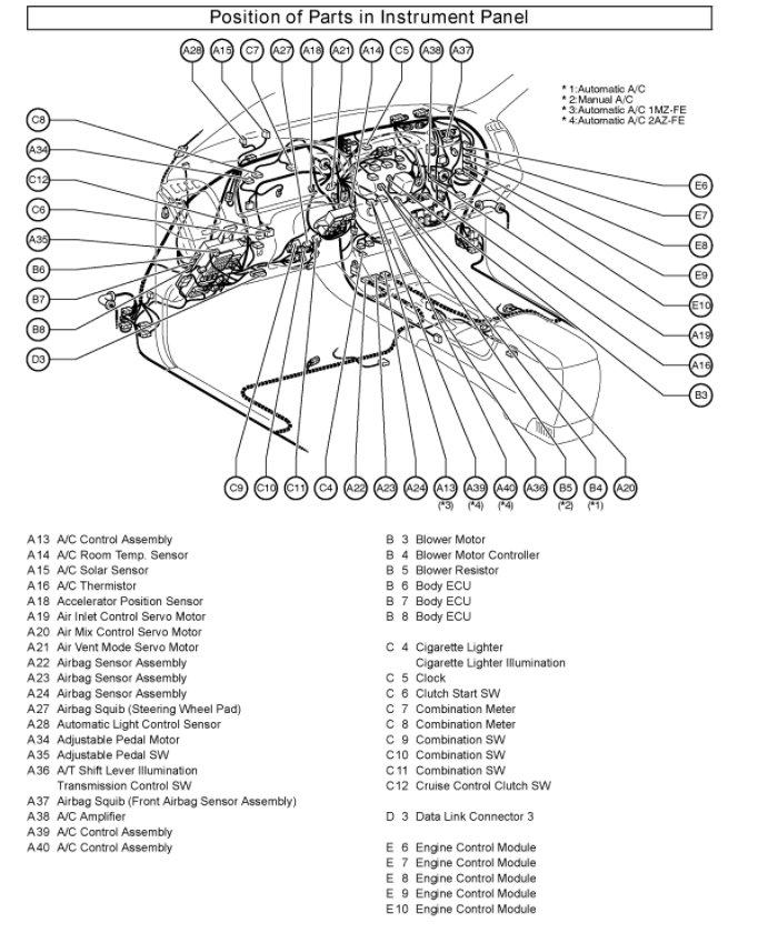

I opened central console and lower panel at drverside. Check the ac mode swith, it looks fine(That thing looks hard to have problem, but the continuity checking is different from manual(I think manaul is wrong, for different model or my car has diferent switch). I still have problem of reaching servomotor. can anyone give some hint?
thanks
WRENCHTECH
  • 20,761 POSTS
Look under the dash on the driver's side and look to the right. You may have to remove a hush panel and/or vent tube.

KHLOW2008
  • 41,814 POSTS
You need to remove the air duct # 13 to get at the servomotor.
Thses are the instructions from our database.
Removal & Installation
Disconnect negative battery cable. Remove instrument panel lower finish panel. Remove air duct. Remove air outlet servomotor. To install, reverse removal procedure.
Is yours manual or automatic climate control system? Our database only shows the manual system.

HIDME
  • 27 POSTS

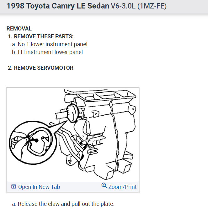

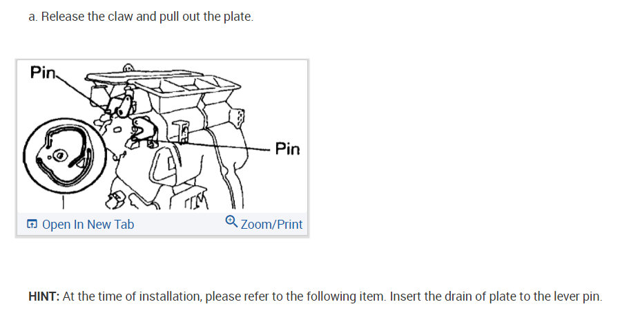

I finally got it off. It stop at some position when I try to to turn the switch. Is it repairable?
Thanks
WRENCHTECH
  • 20,761 POSTS
You have to determine whether the motor is bad or one of the doors is stuck/broken.
