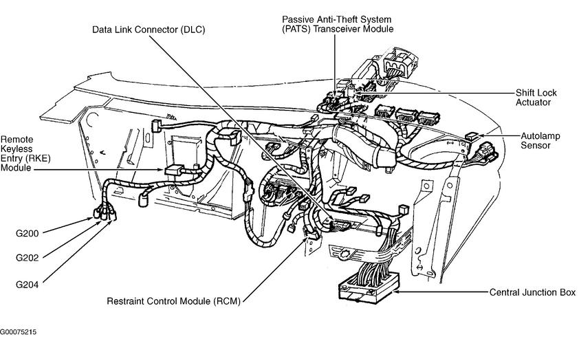

Where is the diagnostic port on my van?

Below dash on right hand side. See picture.

The picture is actually showing the back side of the dash so it will be under the drivers side dash to the right side of the steering column.

Good pick up JIS001, here in Australia we are so use to right hand drive cars that the picture just looked normal. I do have to think back to front.
