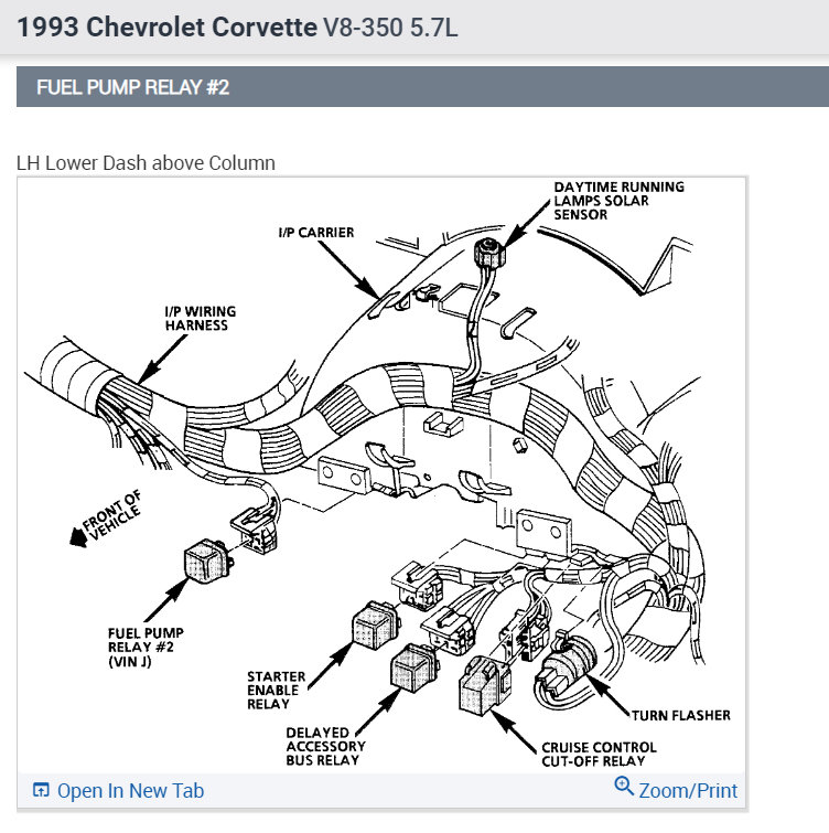

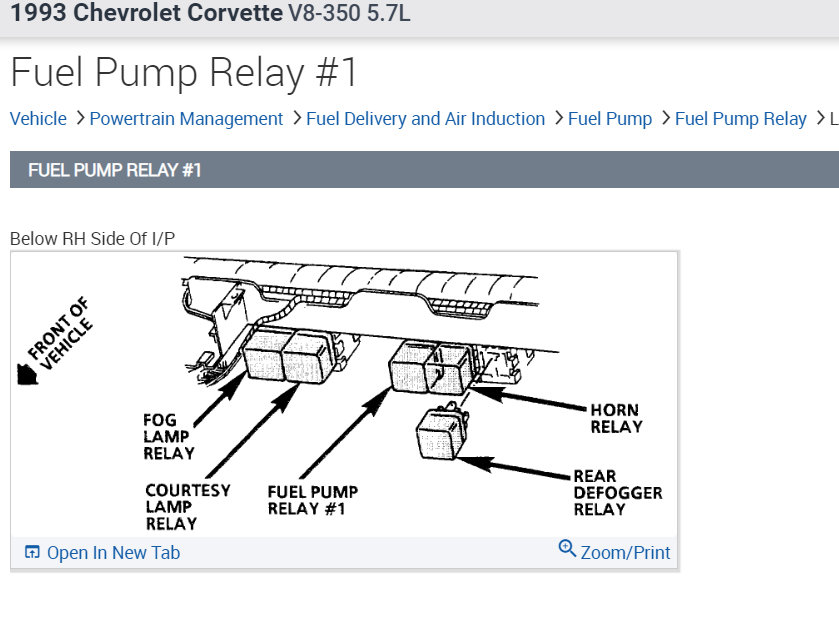

Looking for fuel pump relay rear window defogger horn relay supposed to near the fuse panel right side passenger interior how to pull the relay?
The car listed above is a 1993 Corvette c4 40th anniversary?
Sep 30, 2022 at 5:42 PM
  • 55,433 POSTS
There are two relays for the fuel pump or two locations. Please check it out in the images below. Also, I have included a guide for you to check the relay operation.
Check out the images (below). Please let us know if you need anything else to get the problem fixed.
