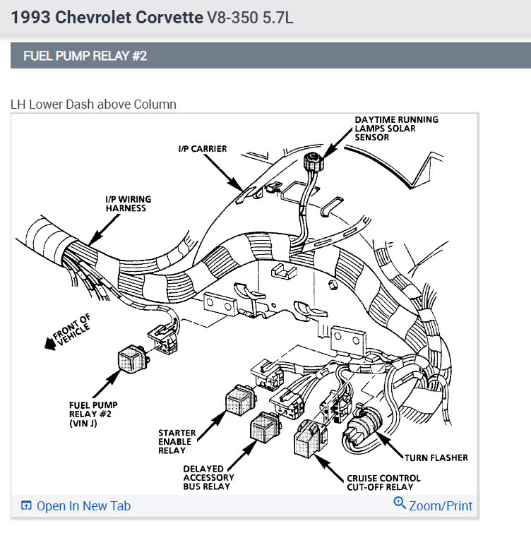

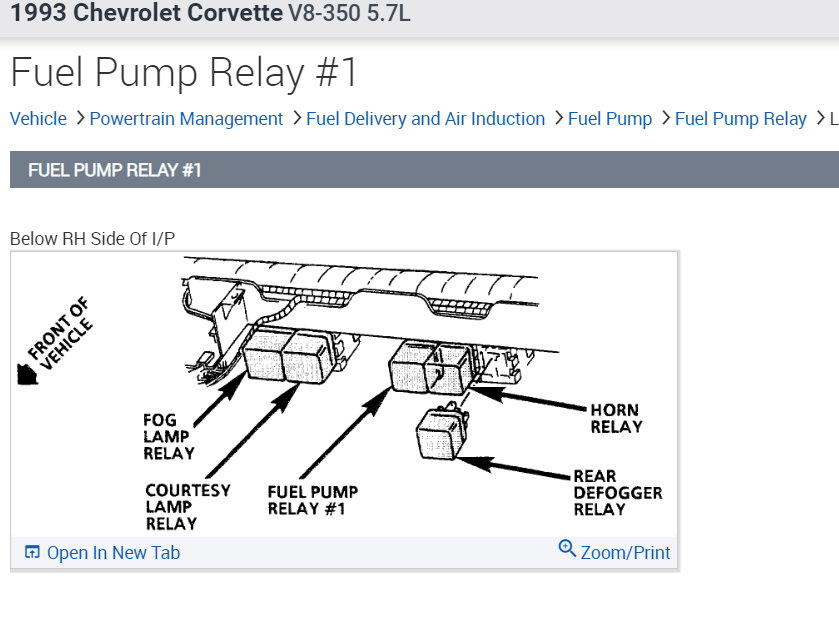

Where is the fuel pump relay located?
1993 CHEVROLET CORVAIR
50,000 MILES • V8 • 2WD • AUTOMATIC
JOHNESKEW
Looking for fuel pump relay rear window defogger horn relay supposed to near the fuse panel right side passenger interior how to pull the relay?
The car listed above is a 1993 Corvette c4 40th anniversary?

There are two relays for the fuel pump or two locations. Please check it out in the images below. Also, I have included a guide for you to check the relay operation.
Check out the images (below). Please let us know if you need anything else to get the problem fixed.
