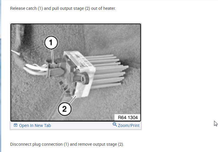

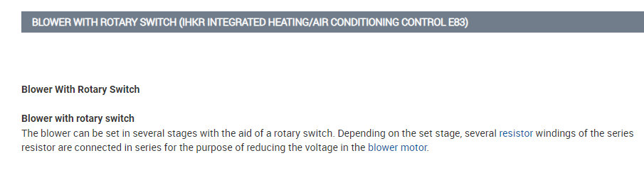

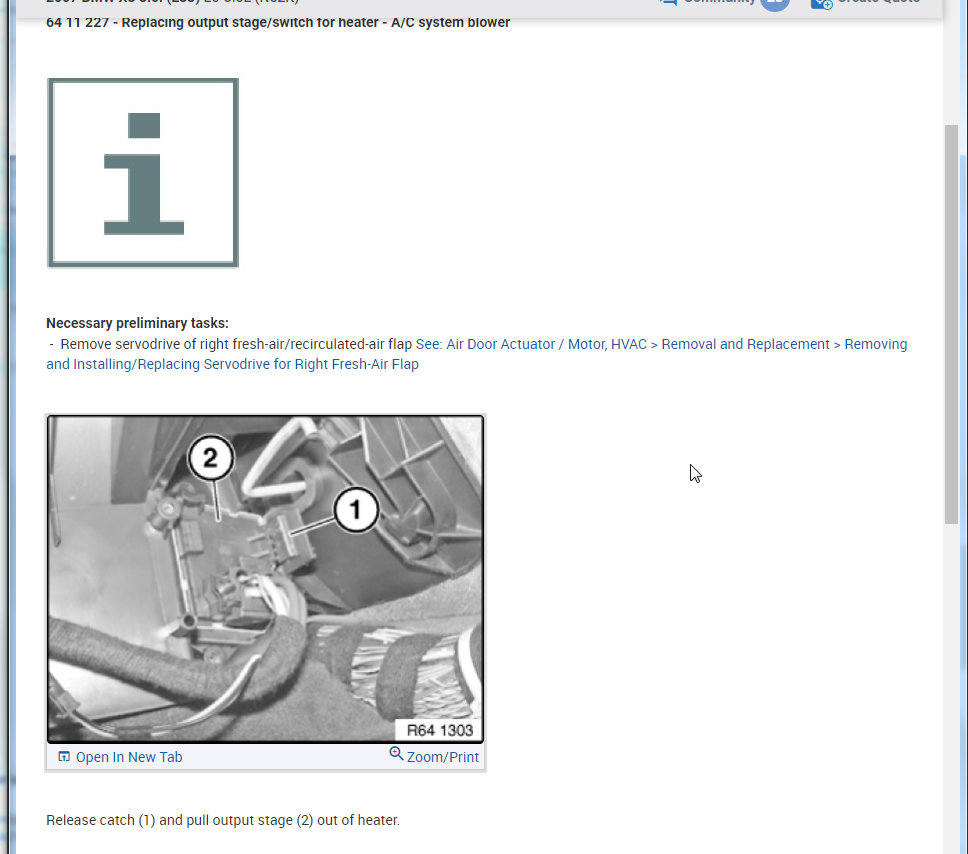

What side is the resistor on a U.K. spec X3 e83? as I can only find on YouTube USA spec x3s.
Dec 14, 2020 at 12:06 AM
Unfortunately we don't have a manual for the specific UK spec because we are located in the USA, but we do have one for the e83. What I can't tell you is if this is different here in the USA vs UK.
I attached the info that we have below. Hopefully that gets you what you need. Thanks
