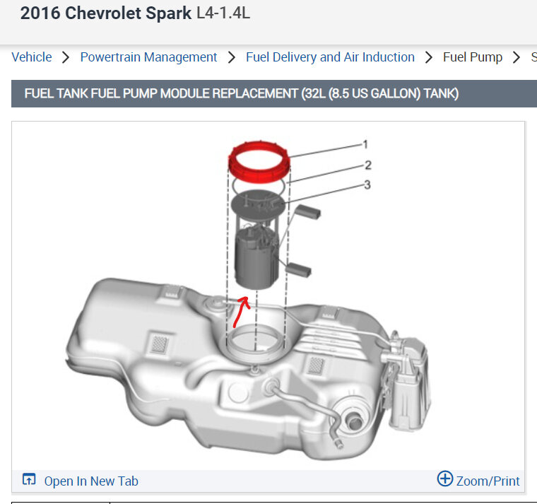

Where is the fuel filter located?

Trying to locate the fuel filter that is on fuel pump in my vehicle listed above.

This car does not have a fuel filter per say, it has a fuel strainer inside the fuel tank attached to the bottom of the fuel pump. Here is an image so you can see what I am talking about. Check out the images (below). Let us know if you need anything else.
