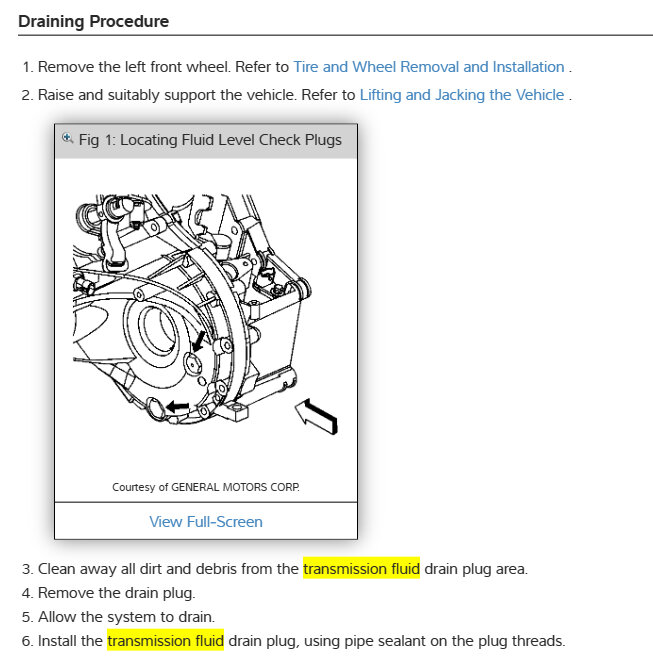

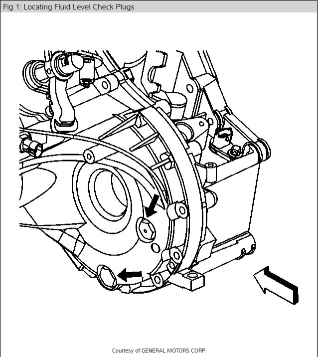

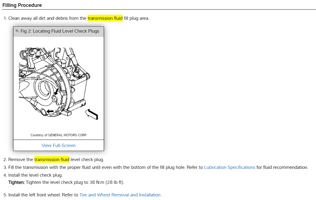

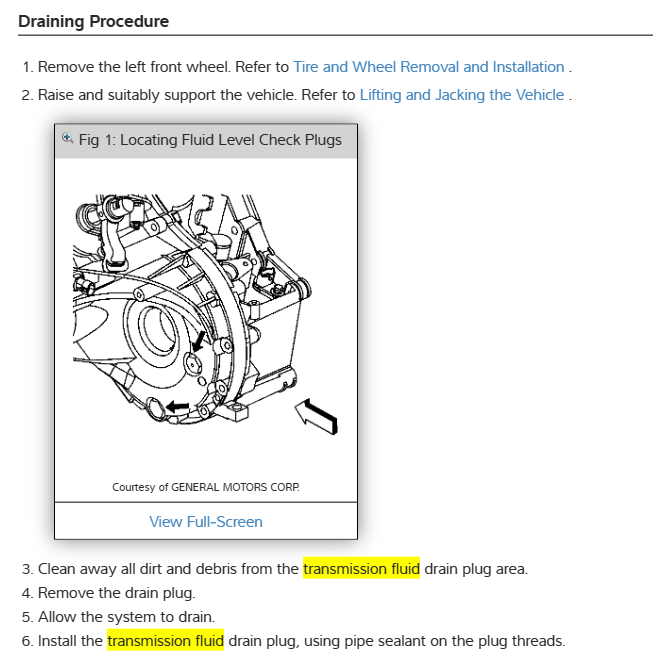

Need to know the quantity of fluid and where the overflow is located to remove to know when it's full of transmission fluid. Not the SS transmission so it's Dex VI fluid.
Apr 23, 2023 at 5:45 AM
BRENDON S
  • 653 POSTS
Good morning, AZDANNO04,
Your transmission takes 1.7 quarts of Dexton VI. Your transmission utilizes a drain and fill plug. There is no reservoir or dipstick. I am adding the drain and fill procedure for you. It will show you the location of these two plugs.

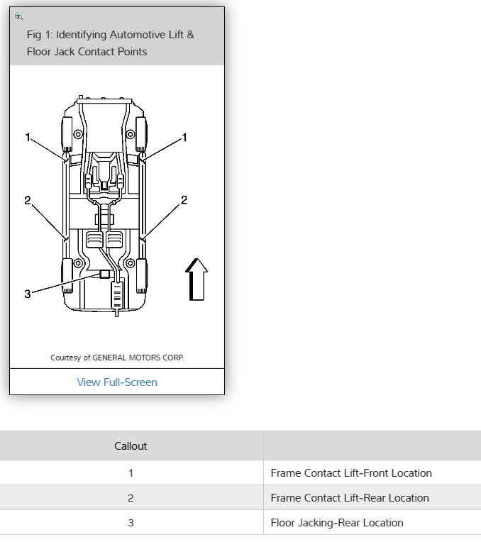

I am also adding some lifting and jacking information for you as well.
