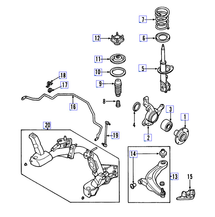

Hi, can I use made MPV complete strut 3.0 L engine and 2.5 L compatible to 2.3L engine Mazda MPV 2003?
Jun 21, 2024 at 12:36 PM
  • 55,711 POSTS

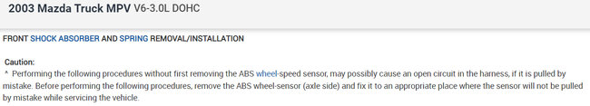

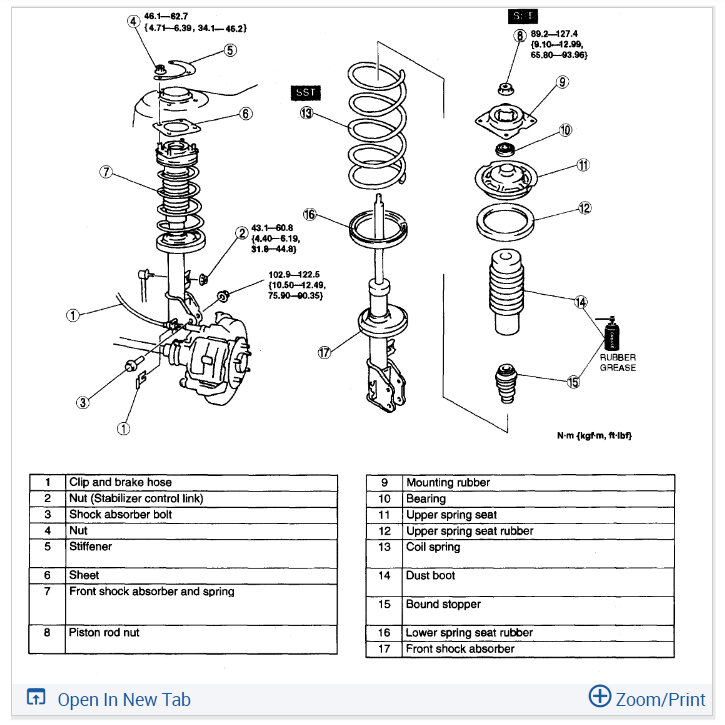

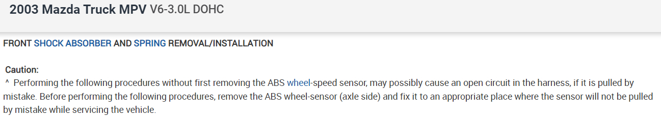

For a 2003 Mazda MPV, struts designed for a 3.0L or 2.5L engine might not be directly compatible with a 2.3L engine because the ride height might be different. If the struts look the same I would give it a try. Here is a generic guide to help you step by step with instructions in the diagrams below to show you how on your car.
