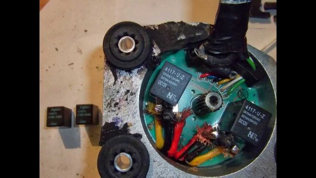

Steering has failed I suspect the steering motor. It is receiveing a voltage of 4V but it is dead. Is this the correct voltage delivered to motor from ecu?

the voltage should vary upon use .. have a technician check this for you

hi
voltage is ok but the problem is motor
you can repair just to change two relays inside motor and the problem gone
