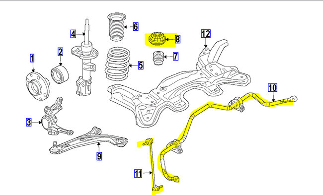

As far as the noise, that can be a few things. Commonly, a broken or bad stabilizer link can cause that kind of noise. Also, a strut plate that is at the top of the assembly, can do that as well.
I attached a pic below from a Fiat 500. It should be similar. I highlighted the strut plate, stabilizer link, and stabilizer bar.
Number 11 in the pic is the link, 10 is the stabilizer bar, and 8 is at the top of the strut where it mounts. Specifically, check the link (number 11) for play or if it is broken.

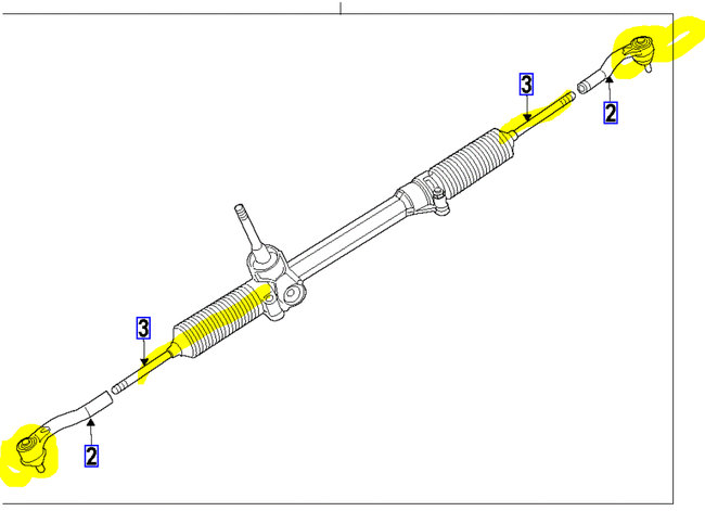

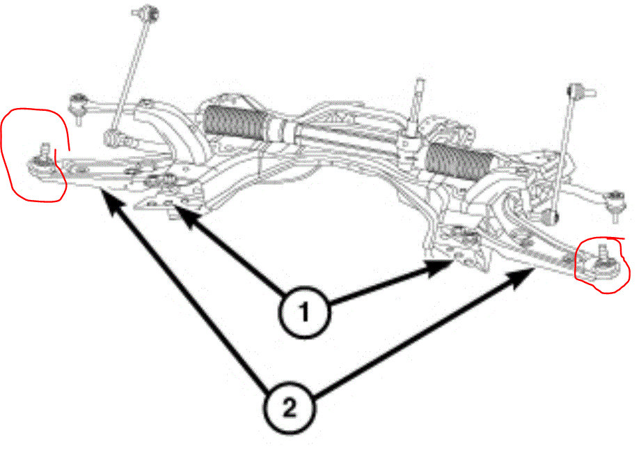

If that checks good, and the other components appear good, safely lift one front wheel at a time. Place your hands at 6 and 12 o'clock and see if there is play that may indicate a bad ball joint. Also, place your hands at 3 and 9 o'clock to see if there is play in the tie rods.
Pic 2 below shows tie rods. Each side has an inner and an outer. The inner goes into the rubber boot. Pic 3 shows you the locations of the ball joints. There is one on each side.

The noise could be the stabilizer bar bushing, link, a control arm bushing, or even a strut plate. Have you inspected any of those things to see if there is evidence of damage or if anything is loose? See the pic I attached above.
