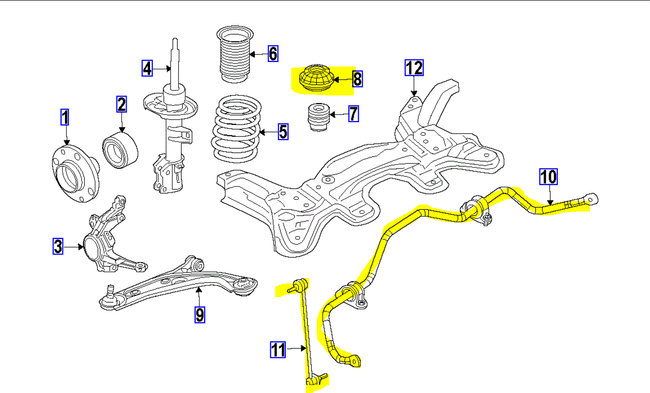

My boot won't open automatically and passenger front side door won't lock?
None of the buttons on the dashboard work?
I put a new battery on the key fob and the lights on the car come on when I press a button but nothing happens? It's unresponsive.
Also, whenever I go over a speed cushion, my front passenger wheel makes a noise?
What could that be?

First, this vehicle isn't offered in the US, so I have very little information on this model. However, I will try my best to help.
As far as the fob, since the lights turn on, the fob is recognized. Have you checked fuses to see if there are any blown for door locks or what isn't working?
As far as the noise, that can be a few things. Commonly, a broken or bad stabilizer link can cause that kind of noise. Also, a strut plate that is at the top of the assembly, can do that as well.
I attached a pic below from a Fiat 500. It should be similar. I highlighted the strut plate, stabilizer link, and stabilizer bar.
Number 11 in the pic is the link, 10 is the stabilizer bar, and 8 is at the top of the strut where it mounts. Specifically, check the link (number 11) for play or if it is broken.

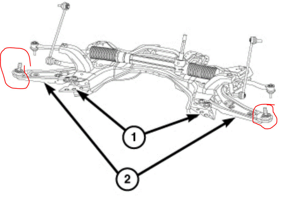

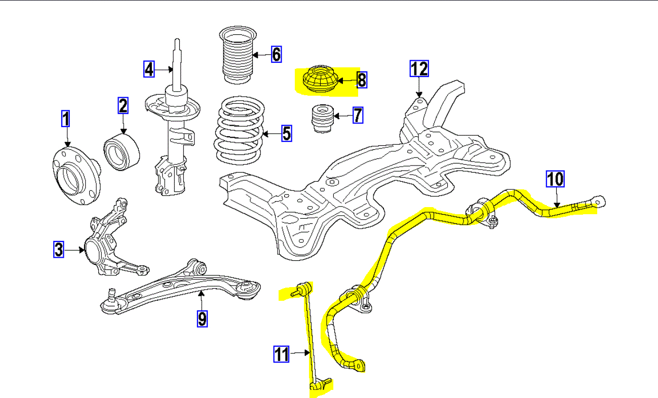

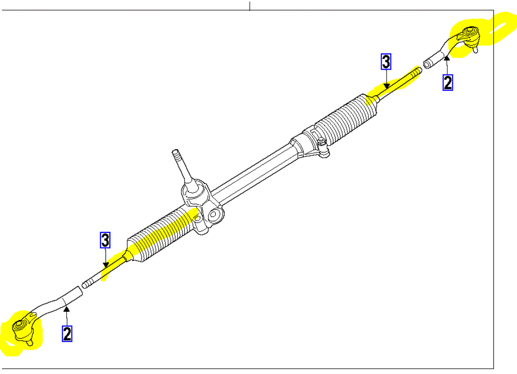

If that checks good, and the other components appear good, safely lift one front wheel at a time. Place your hands at 6 and 12 o'clock and see if there is play that may indicate a bad ball joint. Also, place your hands at 3 and 9 o'clock to see if there is play in the tie rods.
Pic 2 below shows tie rods. Each side has an inner and an outer. The inner goes into the rubber boot. Pic 3 shows you the locations of the ball joints. There is one on each side.

Could it be the anti roll bar links and the springs that are broken?
Thanks.
Adam.

No, I'm referring to the noise the car makes when going over a speed cushion.
Thanks.
Adam.
Aug 26, 2021 at 10:03 PM
  • 110,244 POSTS
The noise could be the stabilizer bar bushing, link, a control arm bushing, or even a strut plate. Have you inspected any of those things to see if there is evidence of damage or if anything is loose? See the pic I attached above.
