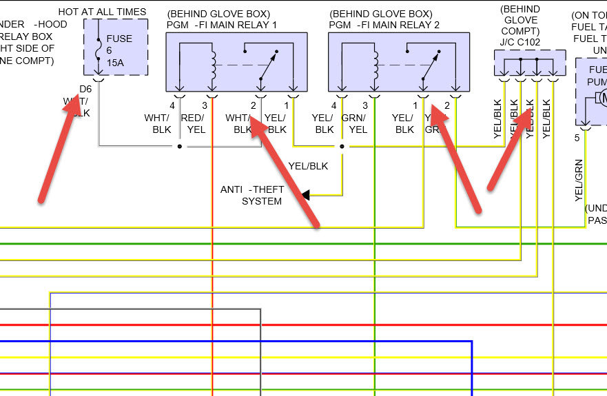

ECU what other circuits run off it?

if it's fuse 1 inside car it runs the ignition coils.

The fuse that has blew is the one under the hood and I tired a new fuse and it blew. Was wondering what else runs off the ECU circuit?Do you have any idea where I should look to find a short that could be causing this fuse to blow?

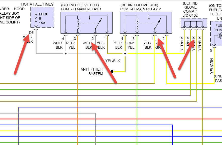

fuse 6 which is the one that blows goes to the items in pic the yellow blk wires go to pcm so it may be a connection problem or maybe a relay
