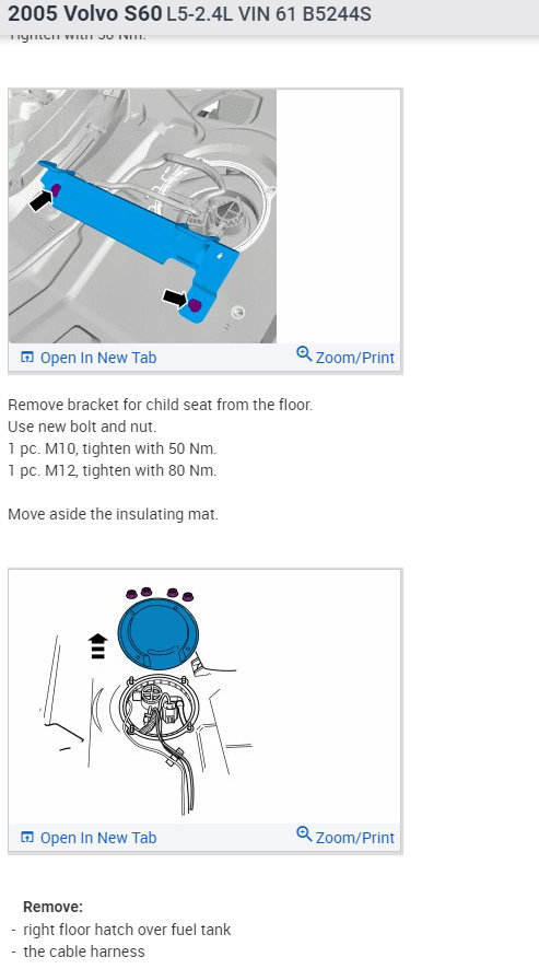

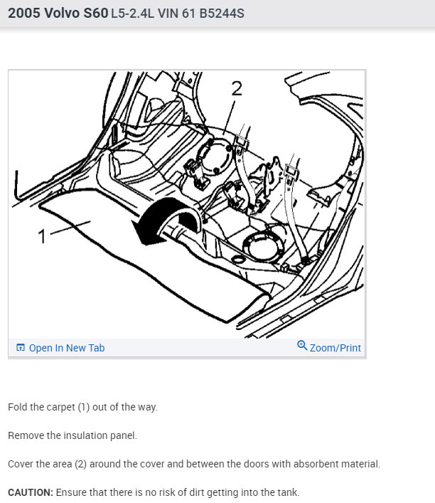

Fuel pump relay location needed.
Oct 16, 2021 at 3:52 AM
SQM
  • 6,383 POSTS

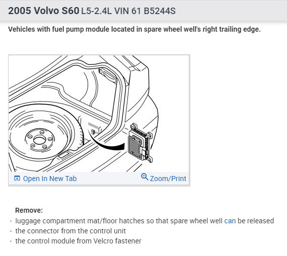

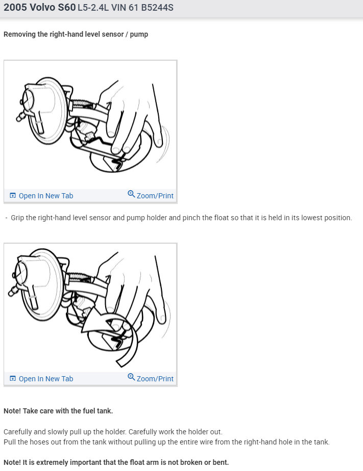

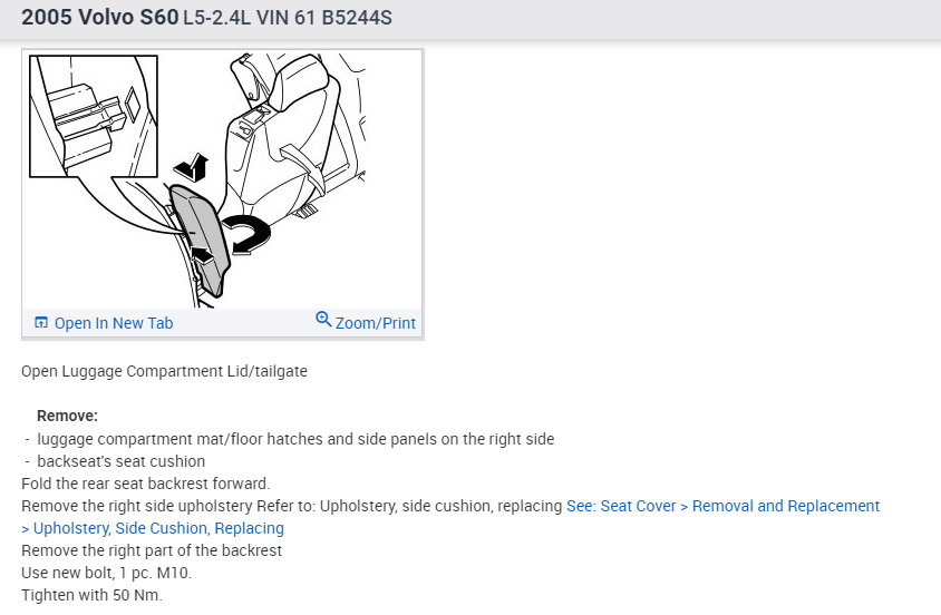

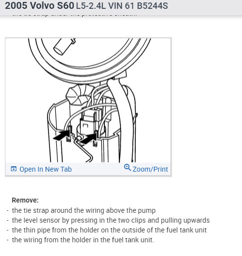

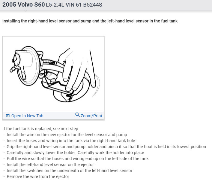

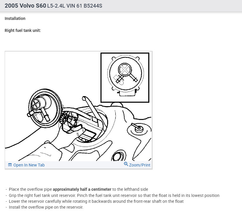

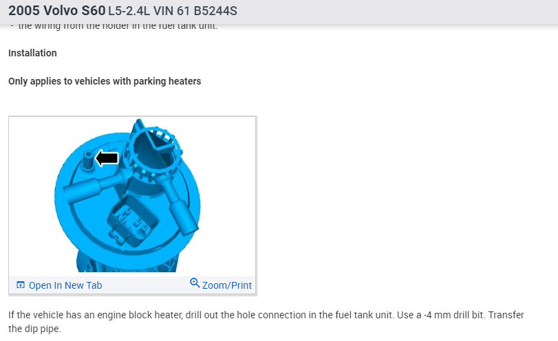

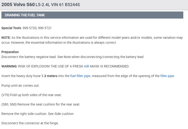

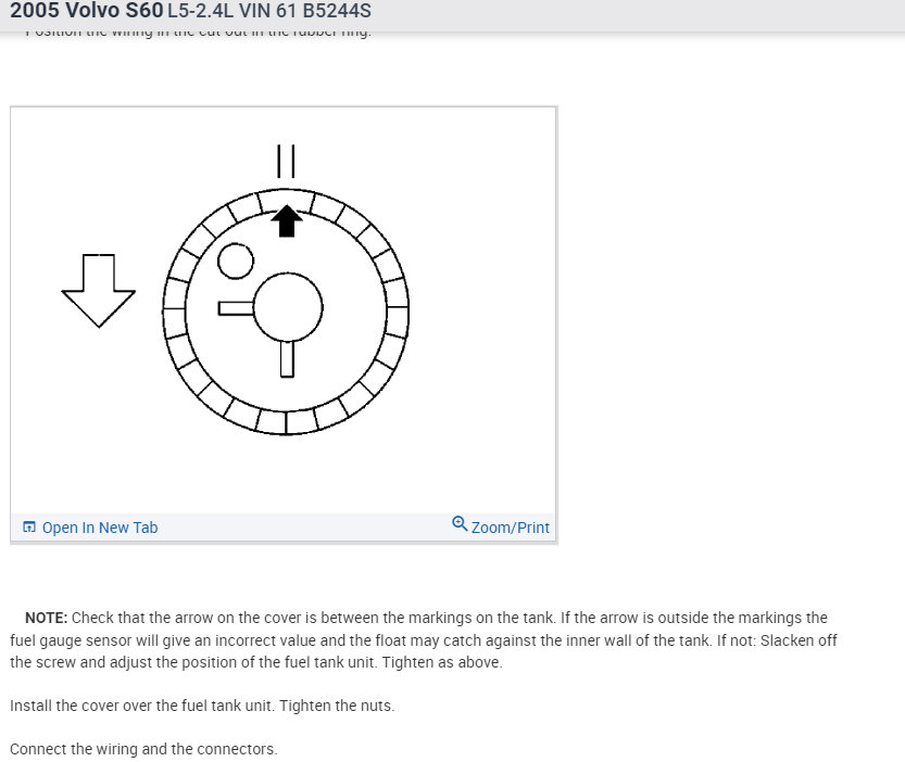

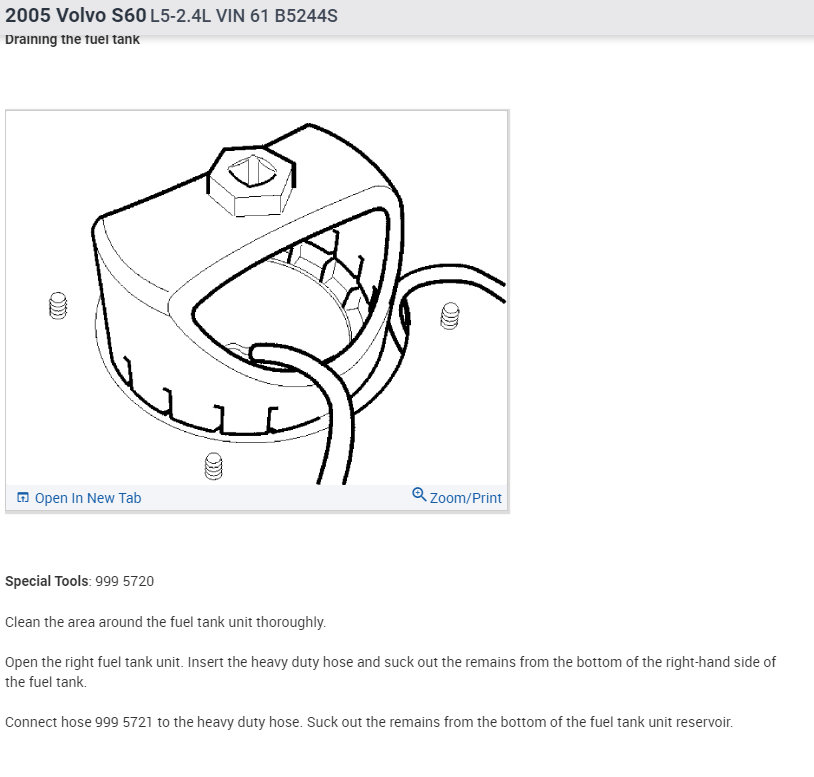

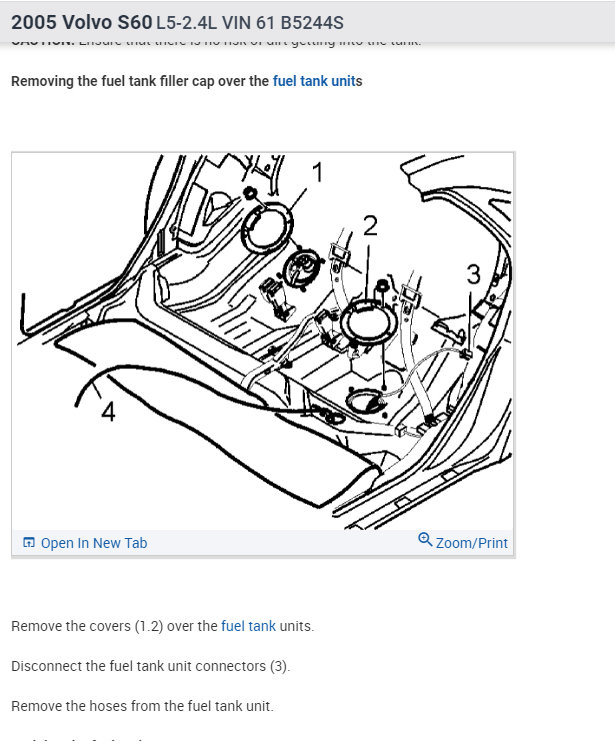

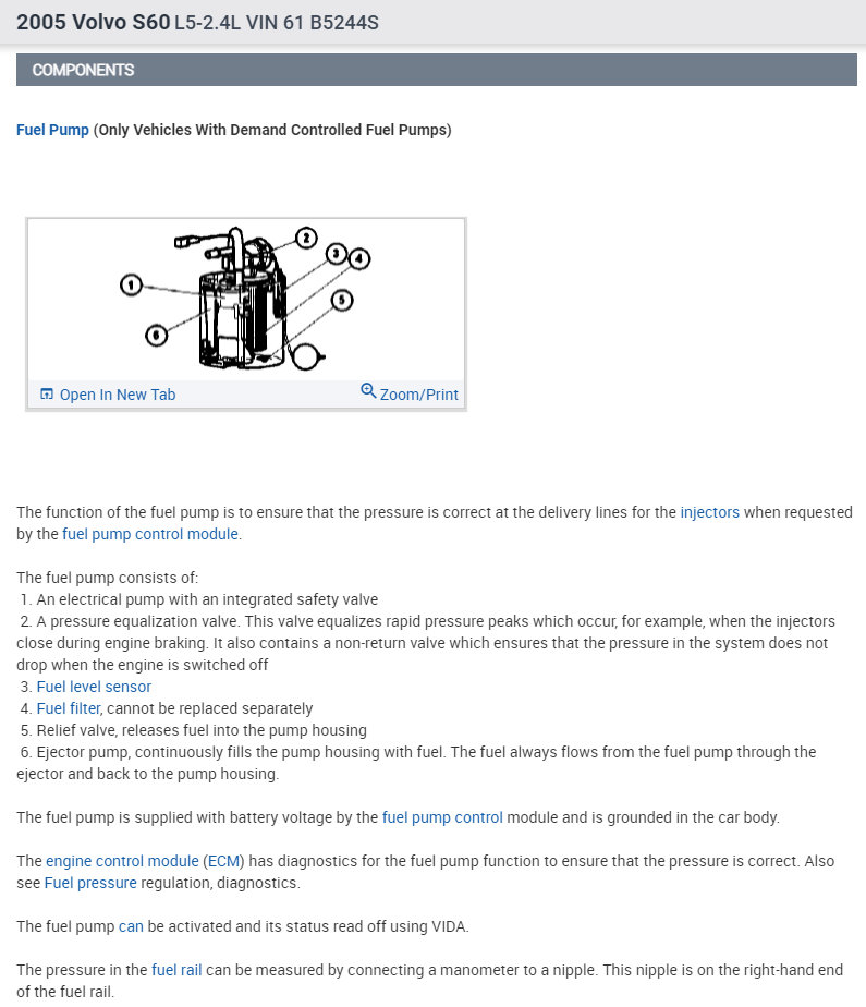

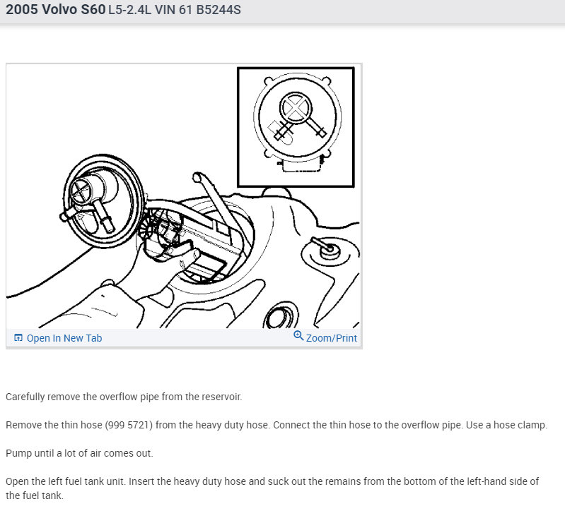

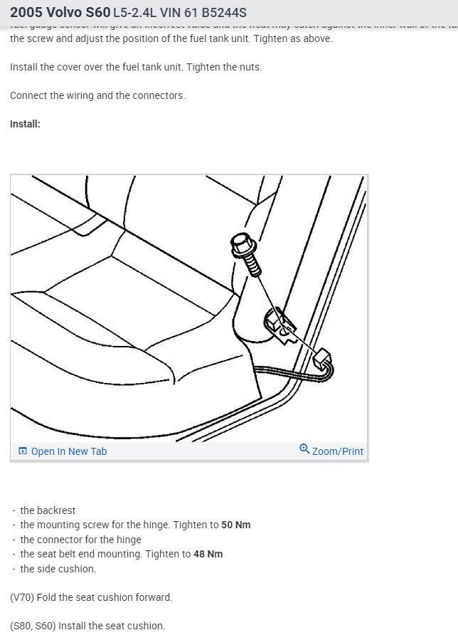

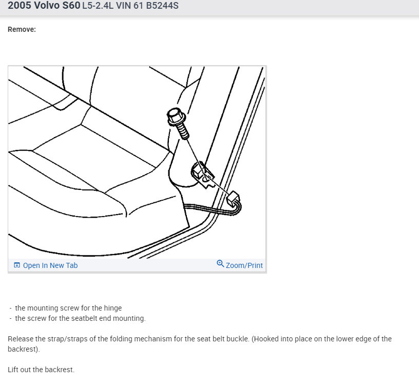

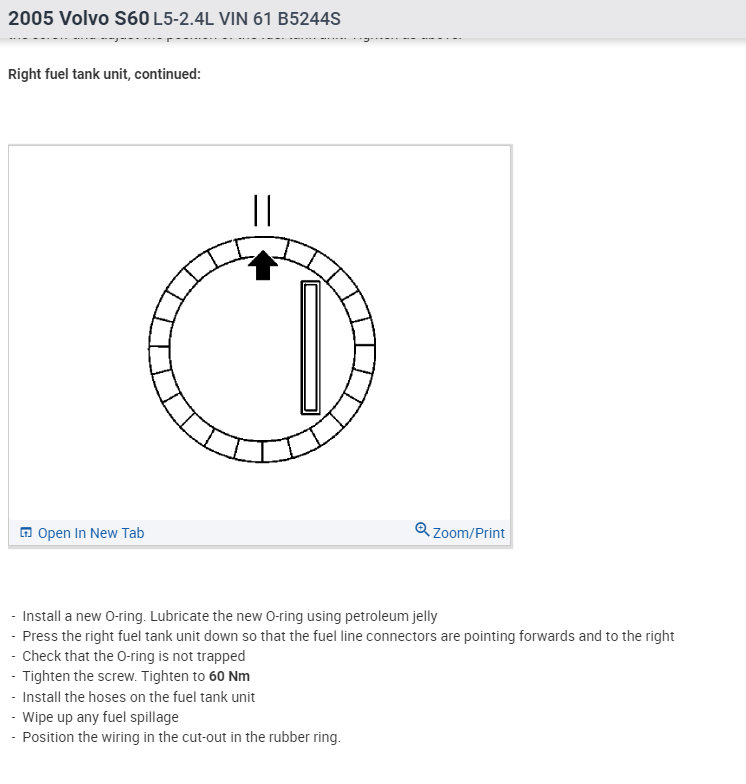

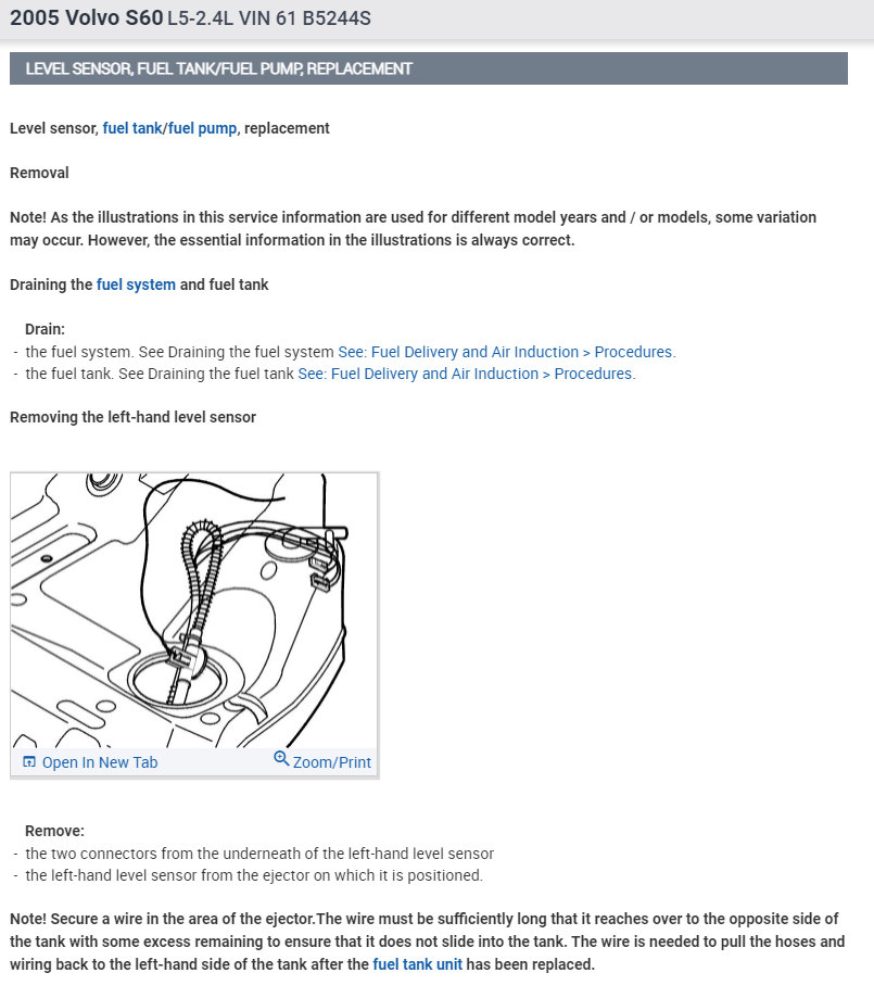

The fuel pump is located inside the fuel tank. To access the pump, you will have to remove the rear seats.

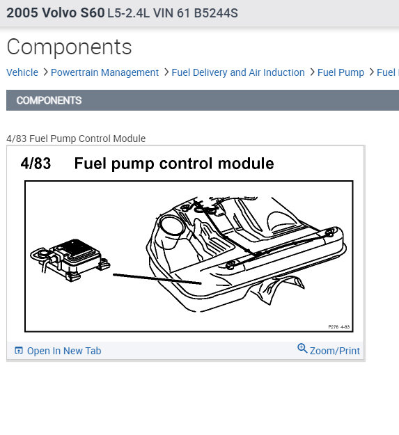

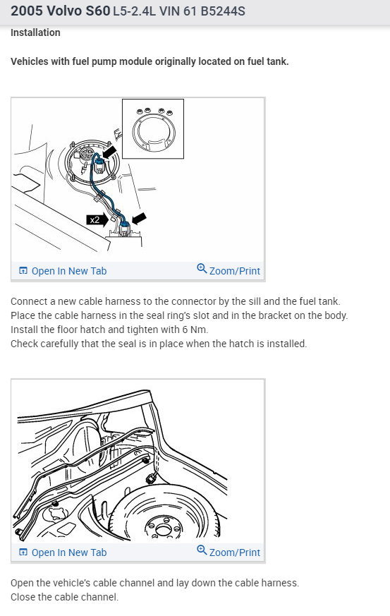

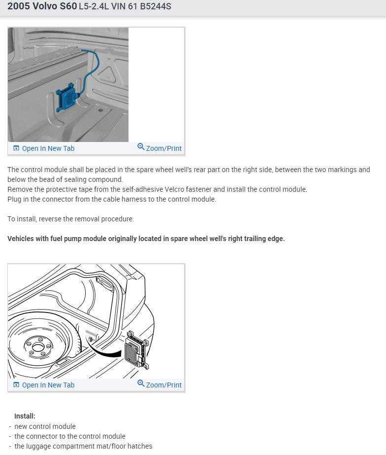

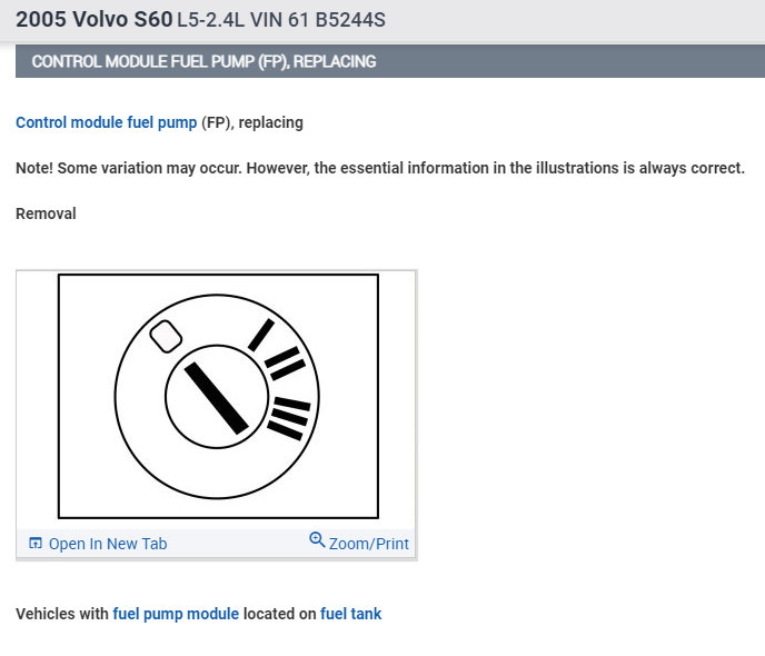

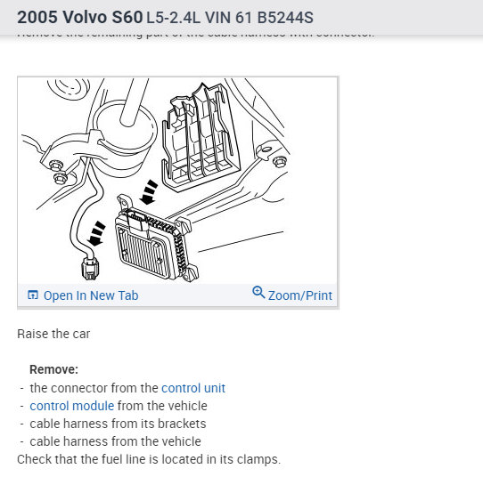

Also, this vehicle does not have a traditional fuel pump relay, the fuel pump is controlled by a module. Located in the trunk.

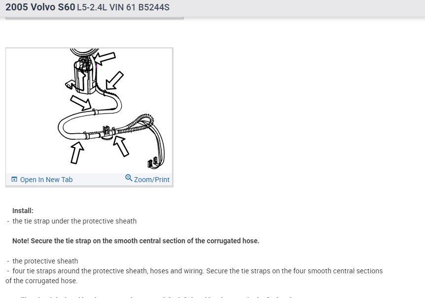

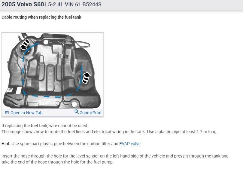

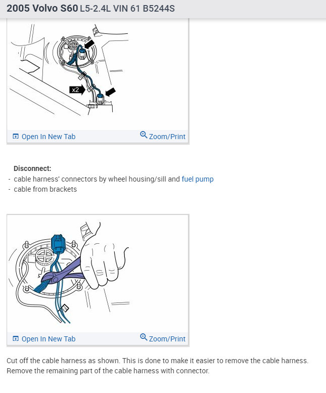

I have attached fuel pump and module instructions below. Please note that there are few different options for the module and the pump set up for this S60.
https://www.2carpros.com/articles/how-to-replace-an-electric-fuel-pump
