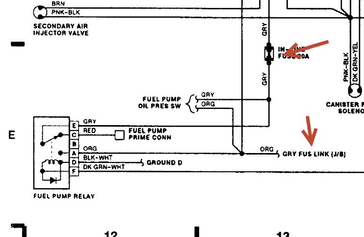

It still has no power to feul pump I changed the feul pump relay and oil pressure stwitch

check to see if the fuse is blown that is inline on the gray line and fusible link onother line shown in pic.
