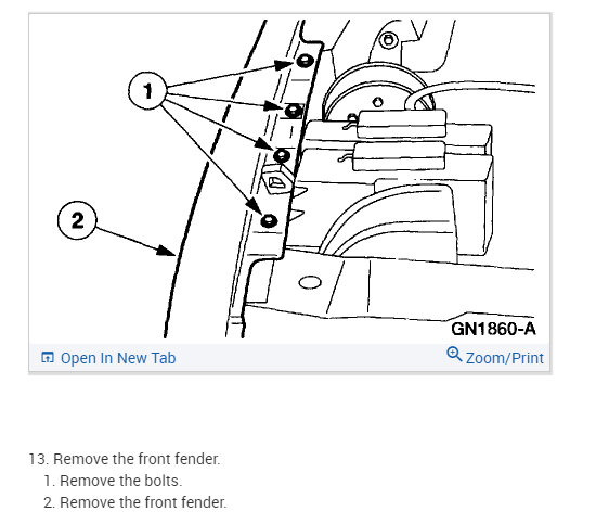

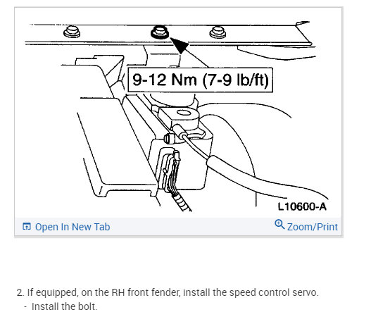

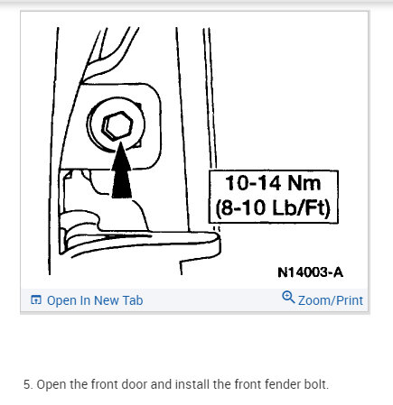

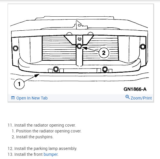

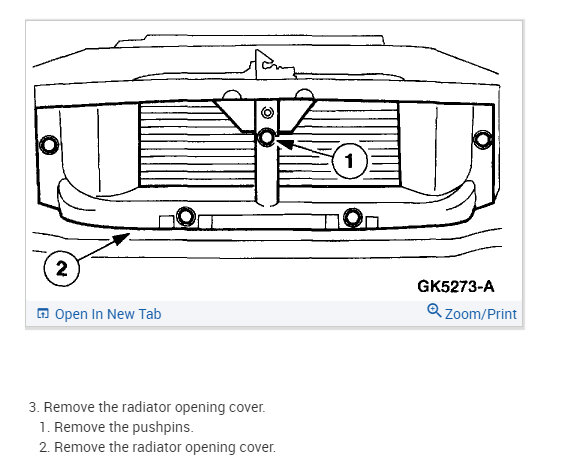

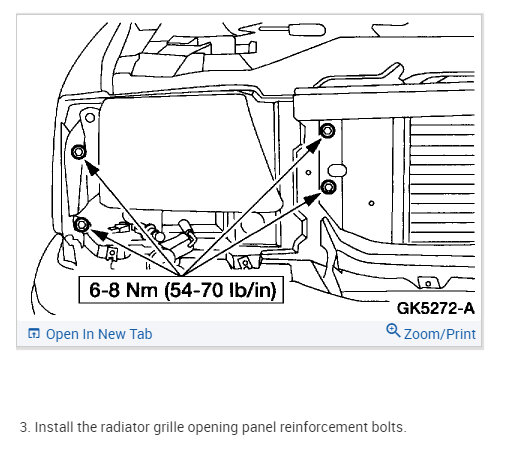

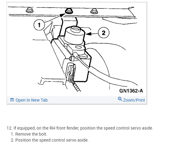

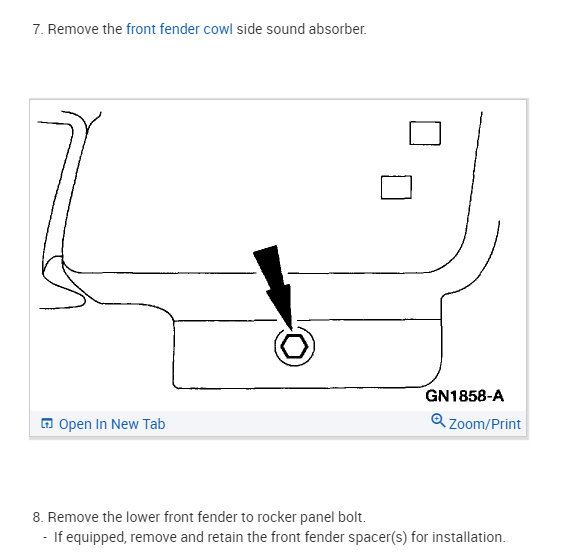

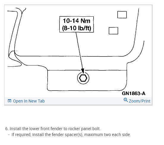

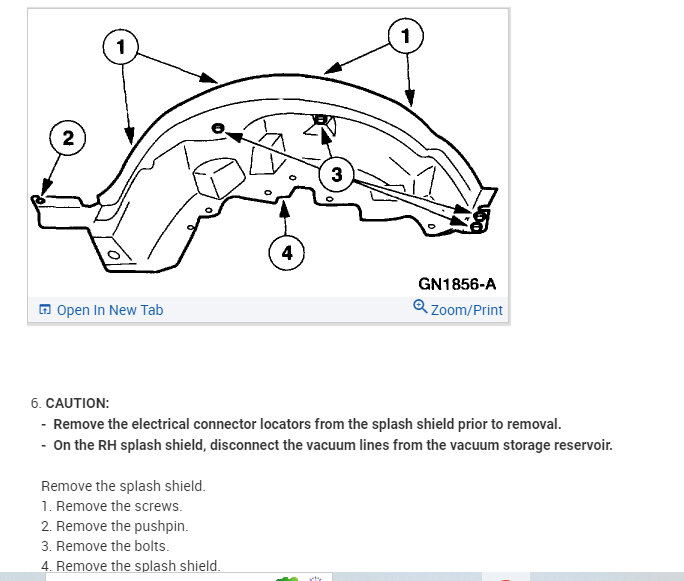

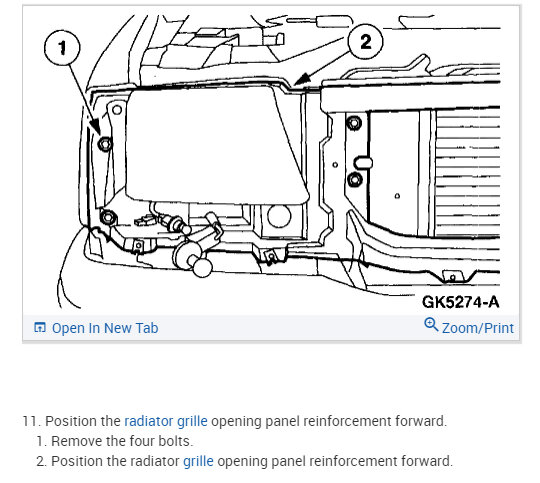

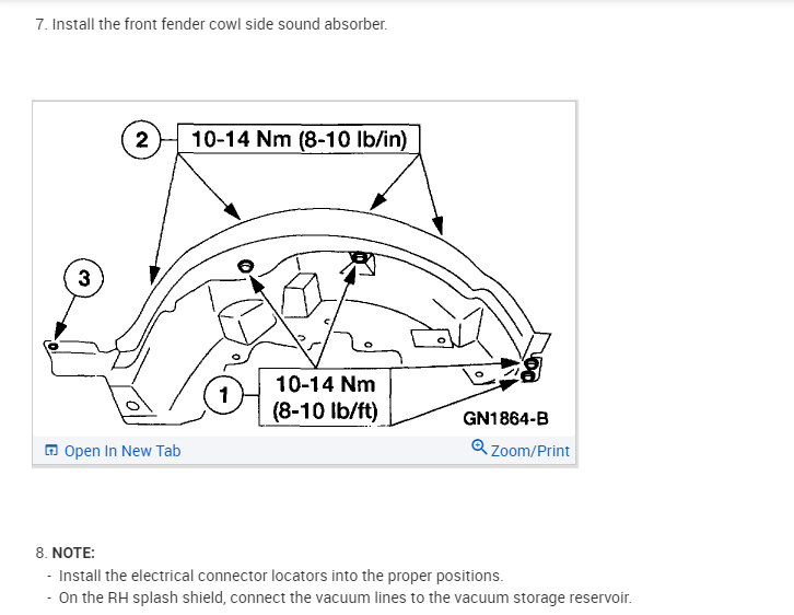

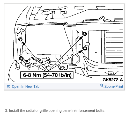

Would the passenger side front fender from a 2000 4.0l v6 ford ranger xl fit on a 2000 3.0l v6 ford ranger xl I’m just not sure if there would be any differences in the holes for the windshield wiper fluid and anti-freeze reservoirs, air filter housing, and cruise control motor.
May 25, 2023 at 7:55 AM
  • 110,244 POSTS

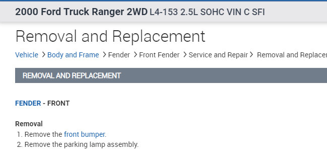

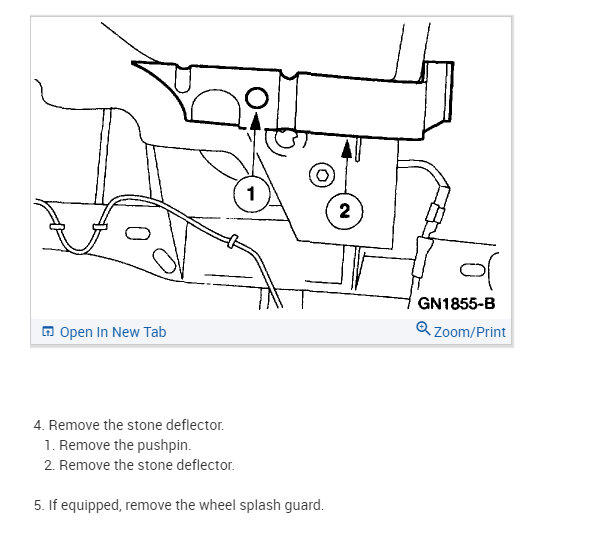

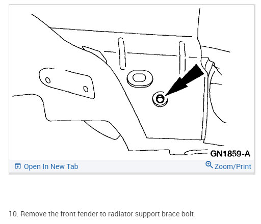

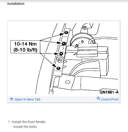

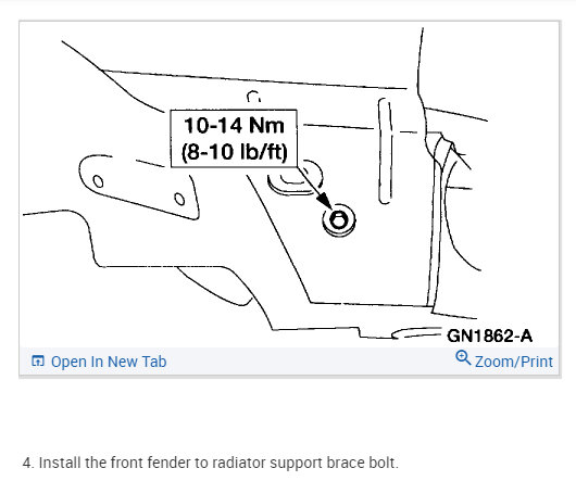

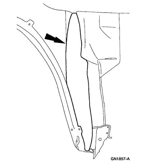

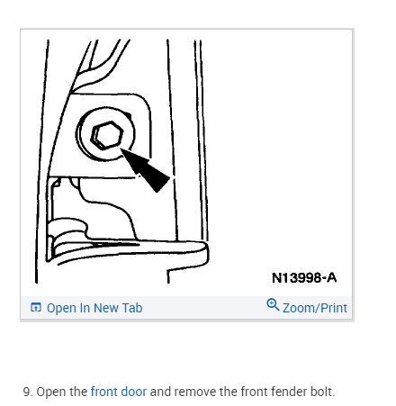

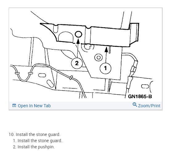

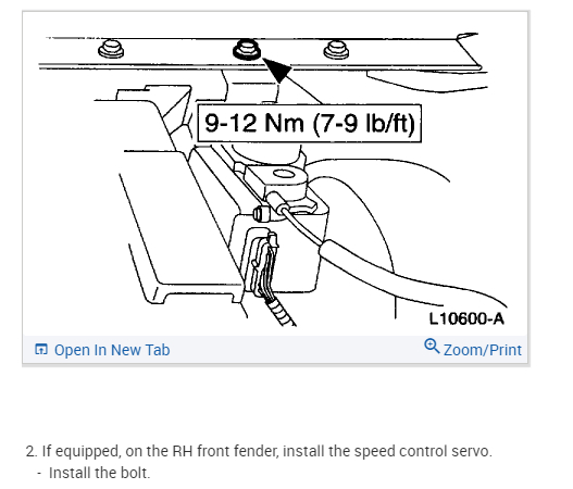

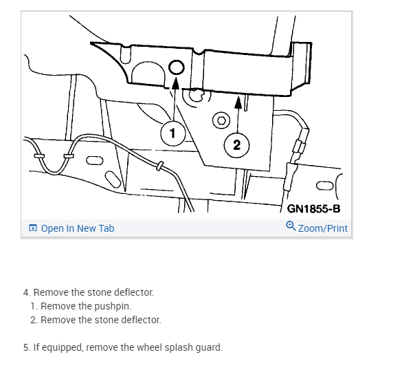

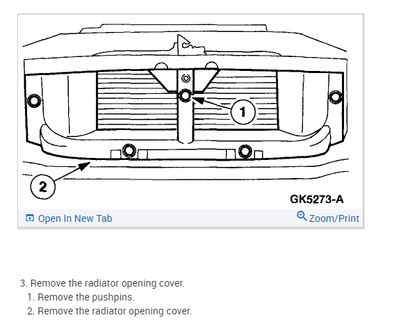

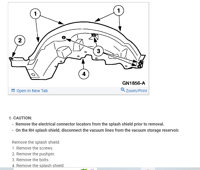

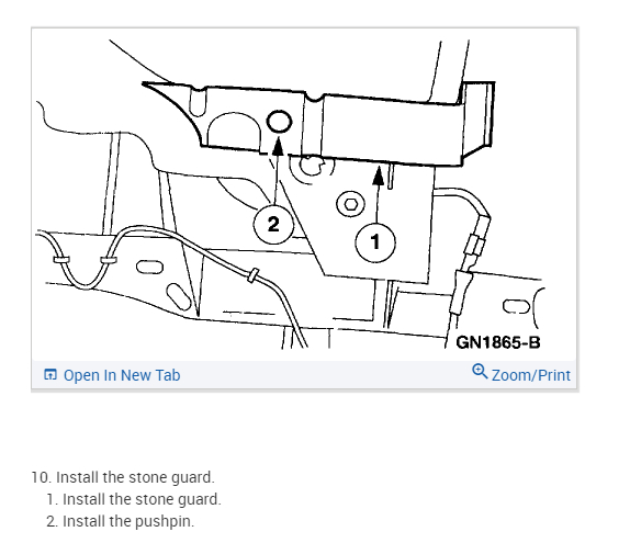

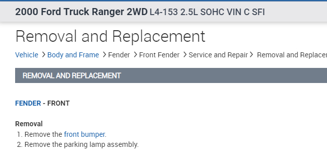

From what I'm reading, the same fender was used from 1998 to 2011, so I have to say yes, it should fit.
As far as replacing it, I don't know if they are needed, but I attached the directions below, so you have a guide.
I hope this helps. Let me know how things work out for you.
