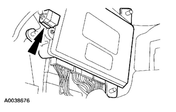

where is the FEM (front electronics module) located?
Jan 6, 2017 at 6:46 AM
DOCFIXIT
Experienced Mechanic
18,828 POSTS
Behind left kick panel ie. drivers side.

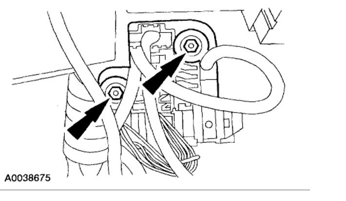

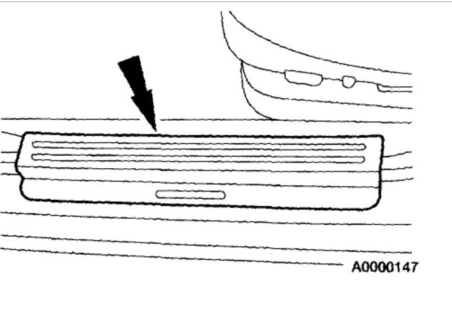

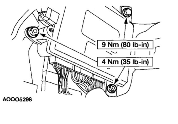

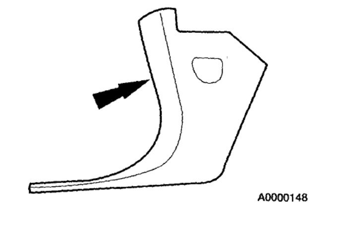

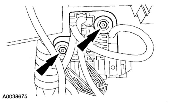

Location of FEM behind left kickpanel, how do you remove kickpanel
Jun 29, 2017 at 4:21 AM
55,594 POSTS
Here are some diagrams (below) that will help you get the job done.
