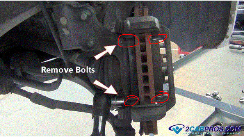

Also, when you have the caliper removed, inspect the caliper mount where the pads are placed. See pic below. So many times, the mount will rust under the hardware causing the brake pads to stick and not move. The result can be brake drag.
I circled the places to check in the pic. I always take a small file and clean all rust and debris from those locations before installing the hardware.
See pic below.
