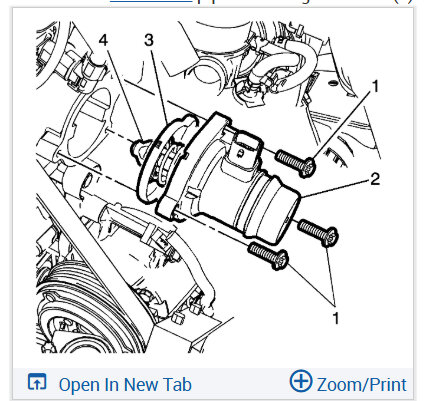

Started overheating. Was told water pump. The water pump was replaced. Still overheats. When starting it from completely cool and let run, it does not overheat but when you drive it for about 5 minutes it will start to overheat.

Yep, this happens when the thermostat goes out. Also, when the engine is overheating can you hear the radiator cooling fan kick on? Here is a guide to help and the location of the thermostat so you can change it out.
https://www.2carpros.com/articles/engine-overheating-or-running-hot
