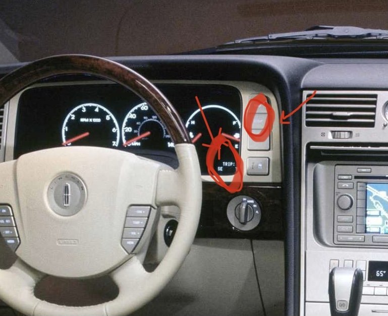

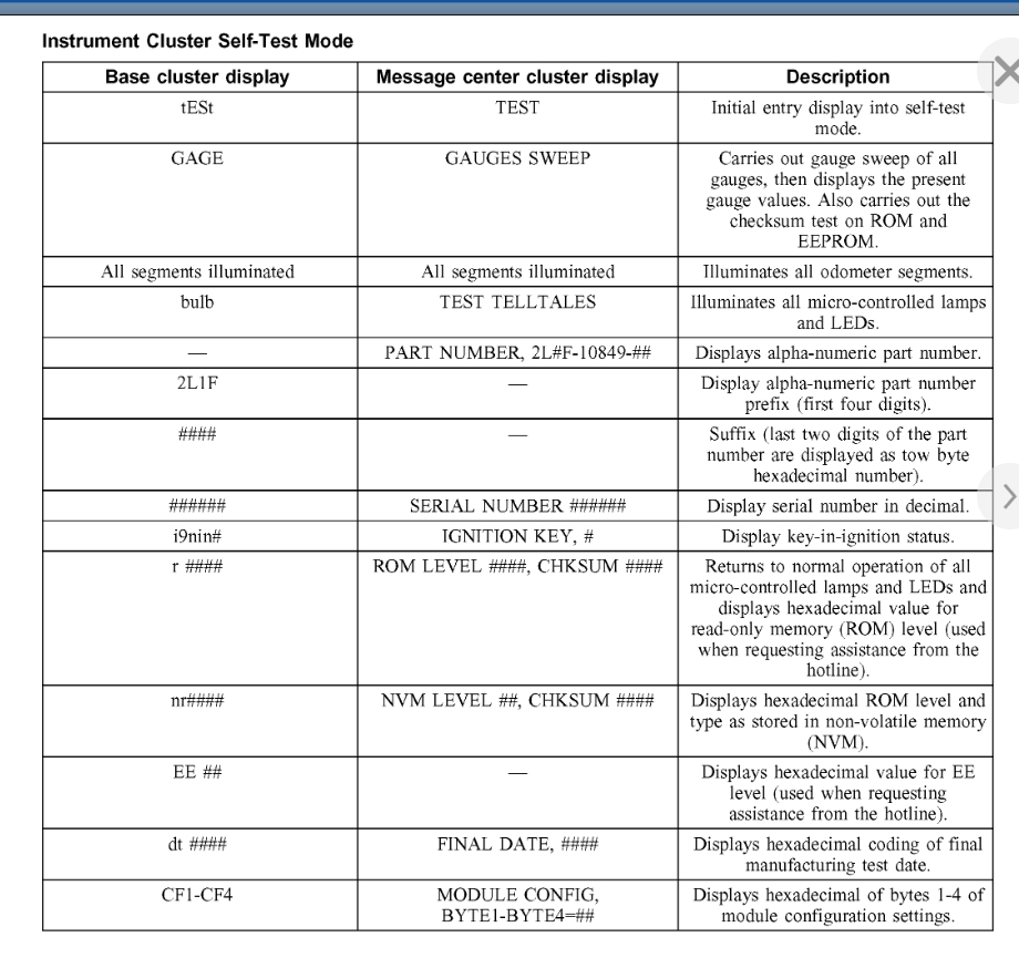

The “Setup” menu is not on the radio. The button is located next to the gauges, right hand side, behind the steering wheel, and the options are displayed in the message/information screen which is located on the bottom side of the gauges. It is the same screen that milage, trip etc., displayed. (Please refer to the attachment).
So, it is not related to radio at all.

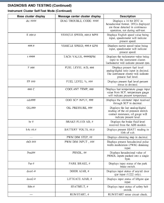

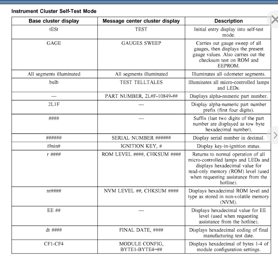

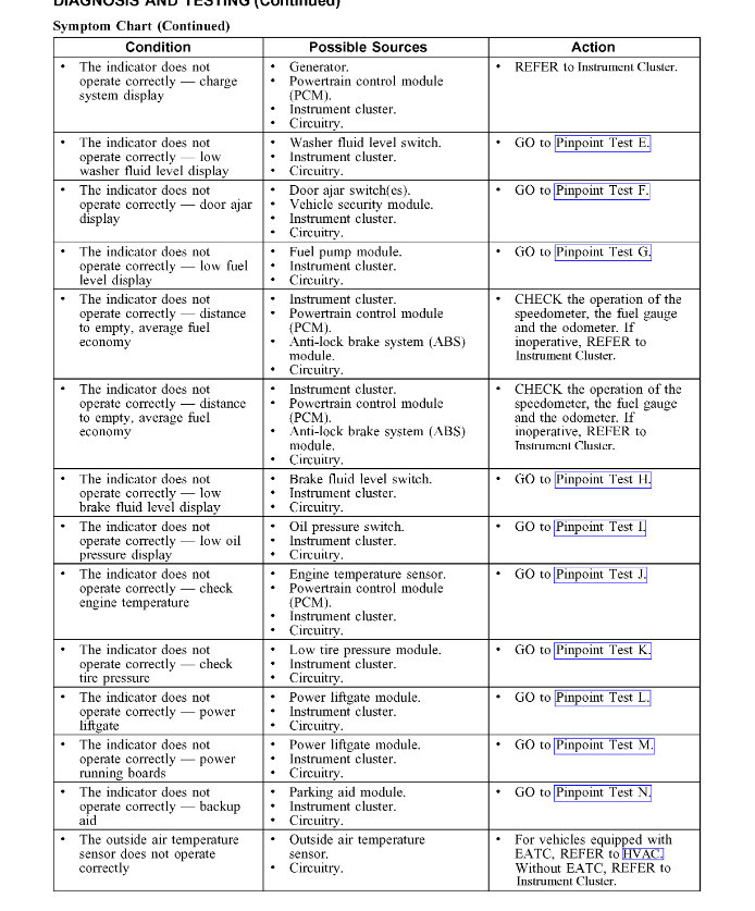

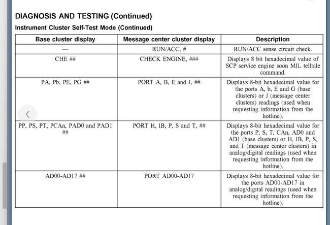

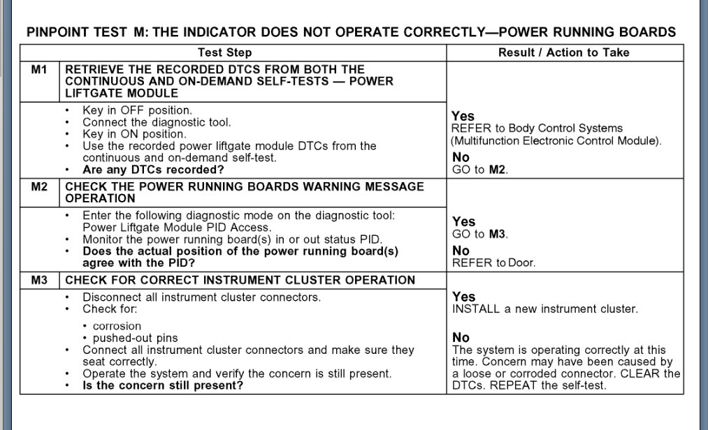

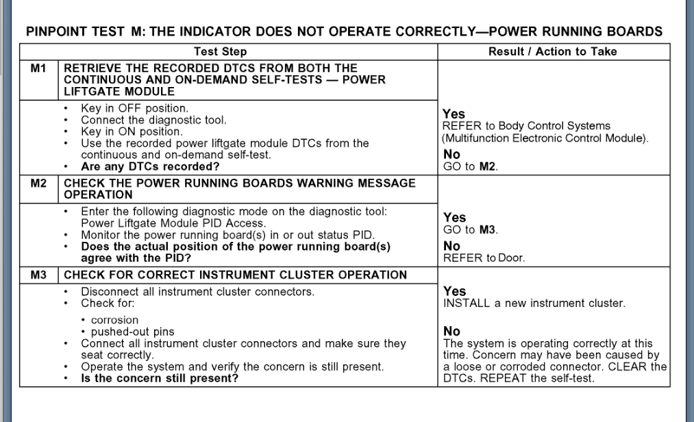

So, on this system, the message center logic is contained in the cluster. So, if this is not correct there is some testing that we can run through but since there are a couple options that appear to be missing, points to a cluster issue.

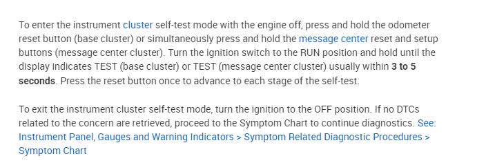

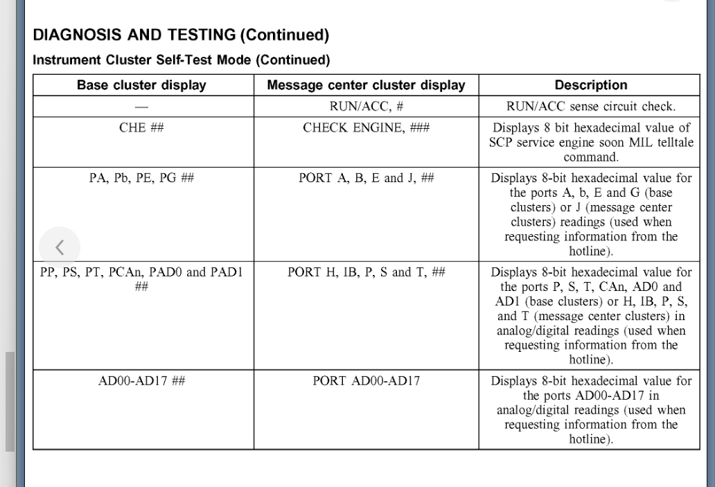

So, I would start with checking to see if there are any message codes in the cluster.
The last page below is how to access this test. Clearly if we have codes then we will need to follow these so I would start with this.
