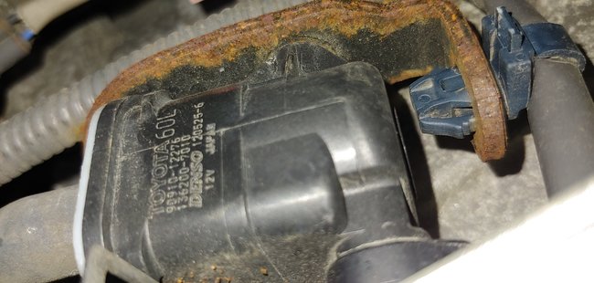

This is a picture of the valve. I read that I can disconnect the power to it, and take one of the hoses off and check for vacuum. If I feel any then it's supposedly no good but I'm not sure if that's an accurate test or which line to disconnect and check. Thanks.
Mar 1, 2021 at 3:54 AM
  • 110,244 POSTS
If you remove one hose, the other shouldn't allow a vacuum to be drawn into it with the electrical connection disconnected. If you run battery voltage through the valve, then you should have vacuum through the opposite port. I'm not to sure if what you read is accurate.

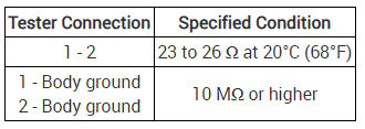

Do me a favor. Here are directions from the manual for testing it. Take a look through them and let me know if it is something you are comfortable doing. The pics below correlate with the directions.
2012 Toyota Truck Highlander 4WD V6-3.5L (2GR-FE)
Purge Valve - Inspection [08/2011 - ]
Vehicle Powertrain Management Emission Control Systems Evaporative Emissions System Canister Purge Solenoid Testing and Inspection Component Tests and General Diagnostics Purge Valve - Inspection [08/2011 - ]
PURGE VALVE - INSPECTION [08/2011 - ]
2GR-FE EMISSION CONTROL: PURGE VALVE: INSPECTION; 2012 MY Highlander [08/2011 - ]
INSPECT PURGE VSV

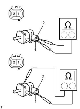

Check the VSV for an open circuit.
Using an ohmmeter, measure the resistance between the terminals.
pic 1
Standard resistance:
pic 2
If the result is not as specified, replace the VSV.

I don't have an ohm meter or anything of the sort. I've been chatting with a mechanic who suggested that I remove the vacuum line from the purge valve to the manifold and then block off the line. He said if my RPM improved, then the purge valve was faulty. I tried this and the RPM did improve. I should be getting a new purge valve tomorrow via FedEx and I'm just going to swap them out. The vacuum leak definitely seems to be coming from the purge valve. The pulsating occurs at the valve, but the pulsating is less noticeable as you trace the hoses away from the valve. The valve itself isn't vibrating or shaking but you can feel the hoses pulse pretty noticeably. And also when I disconnect the purge valve vacuum line to the manifold, the vacuum leak sound goes away. The vacuum leak sounded like a "puff puff puff" sound. As soon as I took the purge valve line off the intake manifold, the noise went away. This is pretty much the only testing and observations I have. That and my MPGs went from 18.6 to 17.3. Thanks!

Hi there! I did end up changing the purge valve. It was very easy and the vacuum leak sound I was hearing has gone away and the pulsating vibration from the hoses at the valve has gone away. So I think the vacuum leak issue is resolved. It still seems slightly underpowered though, but I have new spark plugs on the way, so at 140,000 miles, I'm sure it won't hurt to replace them. I'll keep you posted if anything changes or I have any other questions!

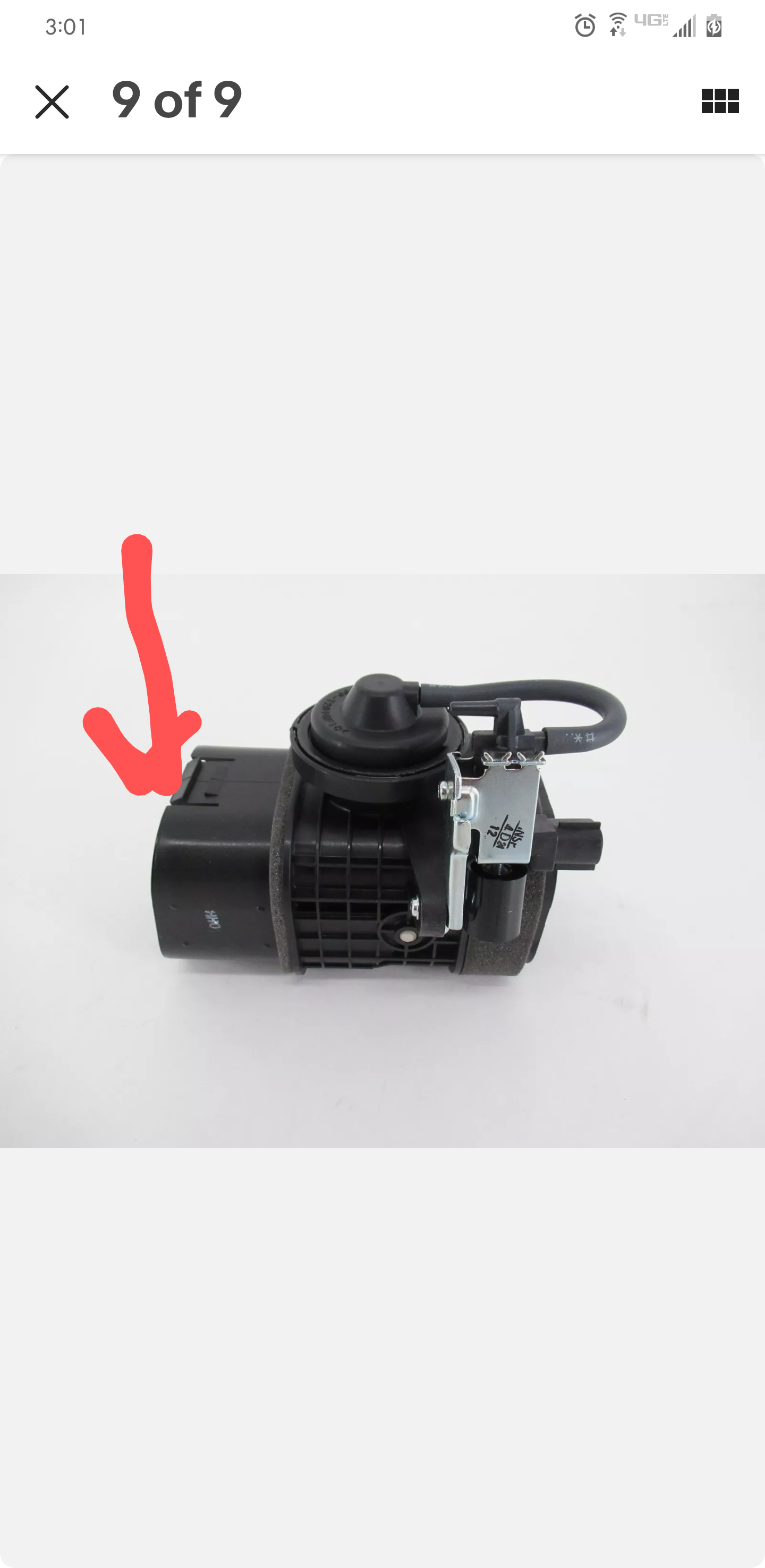

Good afternoon! I have a new set of plugs going in on Wednesday as well as intake manifold gaskets. I replaced the purge valve with a new one and it solved my vacuum leak. In the process I noticed that the housing for the air control valve was broken and as a result, it sits very loosely in the air intake. I've ordered a new one and look to replace it soon. I was hoping you could send me directions on how to change it. Most of it is straightforward but I want to make sure I undo the clip inside properly. I'll send a picture of the part I'm replacing and show you the clip I'm talking about. Thanks!
Mar 7, 2021 at 4:17 AM
  • 110,244 POSTS
I have to ask you to repost this new question. I will be happy to help. Please understand, we try to keep the threads specific to one topic. That is why I am asking.
Simply copy and paste your questions.
I hope you understand. Also, is the pic part of the air intake tube between the air filter and throttle body? Let us know if that is the mass air flow sensor.
