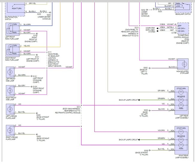

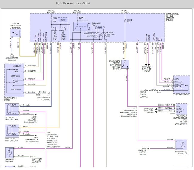

I have a titanium diesel estate. When I indicate right full beam comes on, when I indicate left the voice control is activated. The steering wheel control module has been replaced and a new stalk has been urged and it is still the same. Any ideas would be great. The wiring and earth's have also been checked.

It sounds like you may have a problem with your smart junction box, start by checking all of the fuses though, here is a guide and a diagram to help you get started.
Please run some tests and get back to us.
