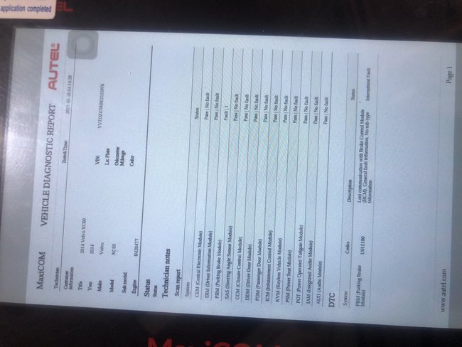

With this mail, here his attachment of the last diagnosis report done by local technicians.
Thanks,
Muhimu
Aug 1, 2021 at 2:05 PM
  • 110,241 POSTS
The only fault indicated is the parking brake module. Are you having any issues with it?

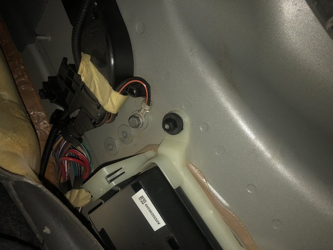

Also, I attached a pic below of the ABS ground. It is located in the left rear wheel housing. It would be a good idea to check that as well.

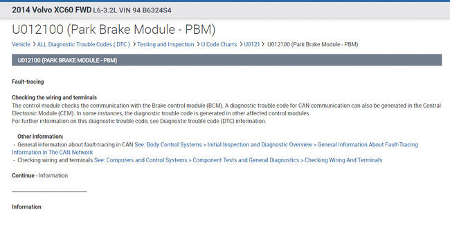

Also, is the U012100 the only code that is still present? I attached the diagnostics below for that code which is related to the parking brake module.

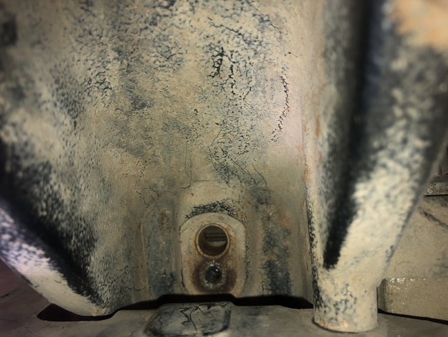

2) I measured the voltage from the right side sensor and no any voltage coming our. Surprisingly the same sensor is giving the voltage when we swapped to the left side 3,65 mil volts(see the attached picture No 1).
3) I checked the surface of connection of sensor is nice and well clean(see the attached picture No 2).
4) I checked the ground as your instructed but it intact (see the attached picture No3).

It sounds as though the sensor is good. Have you checked wiring at the connection? Is there any dirt or grease on the toner ring that would prevent the sensor from producing a signal? Also, have you checked the wires between the sensor and the module?

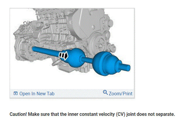

I attached the directions specific to this vehicle. Note that the right axle has a carrier, so make sure to check that as well. See pic 1.
The remaining pics are the directions from the manual. I hope this helps.

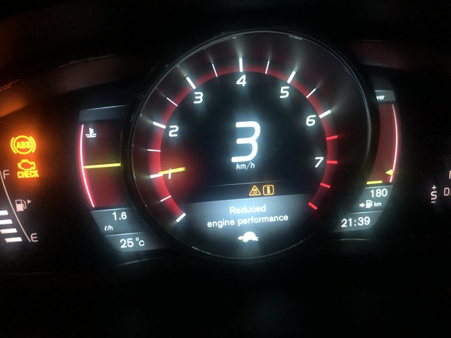

It’s seams the noise comes from drive shaft and I decided to order the new drive shaft both side as well a carrier bearing too. The items could take few weeks due to COVID situation. While i am waiting the price quote, can you also suggest the reliable source of part suppliers?
Also i have one msg coming up says(Reduced engine performance)see attached picture. This just comes whenever you start the car and driver for few distances from 1 to 2 kms. Is this can be related with speed sensor or it’s something else?

The reduced power could be a number of things. In this case, you really need to scan the computer in the manner I mentioned above. Otherwise, it will become a guessing game which usually results in a lot of wasted money.

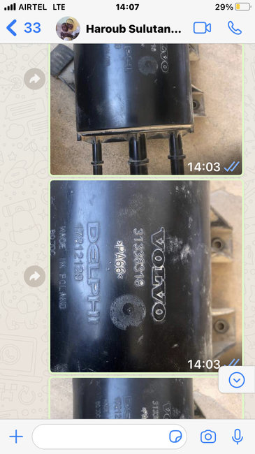

Another thing which come to my mind is the changing the fuel filter, it’s looks my car doesn’t have ordinary filter as seams comes with something calls canister filter (see attached picture). Is this replaceable?
Is the factional as fuel filter? Please help.

A canister filter is replaceable. Take a look through this link. It explains how it's done.
https://www.2carpros.com/articles/how-to-change-a-fuel-filter
