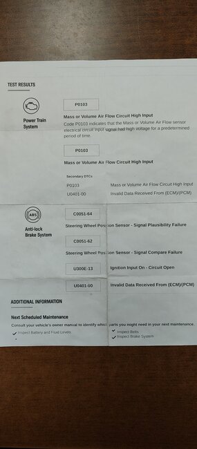

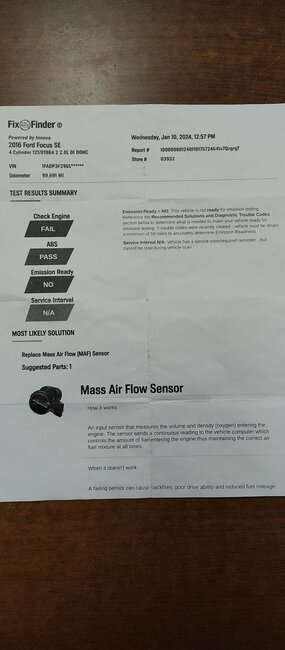

These are the codes pulled at AutoZone.
Jan 16, 2024 at 4:44 AM
  • 55,694 POSTS

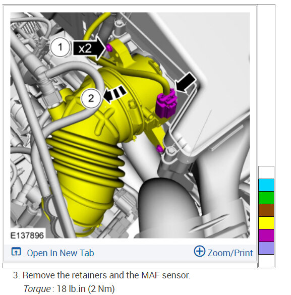

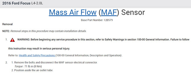

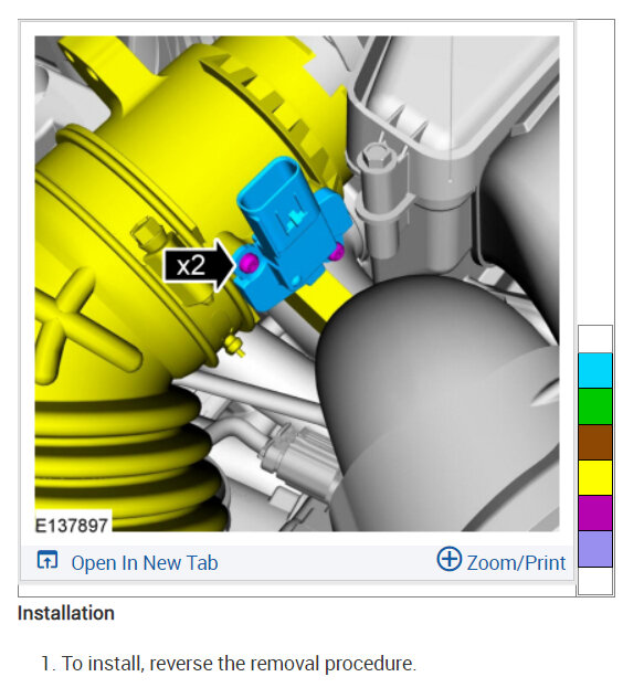

Allright, that is pretty straight forward, I would get a new MAF sensor, here is the location. Don't forget to clear the codes once the repair has been made. Check out the images (below). Let us know how it goes.
