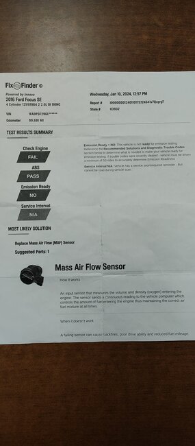

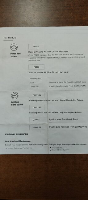

These are the codes pulled at AutoZone.

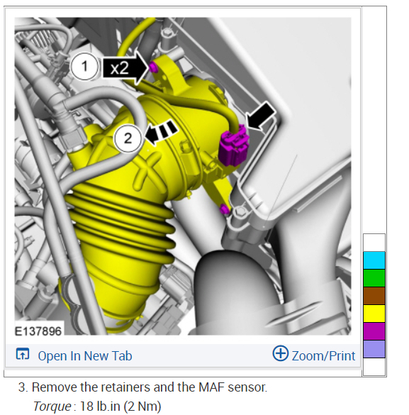

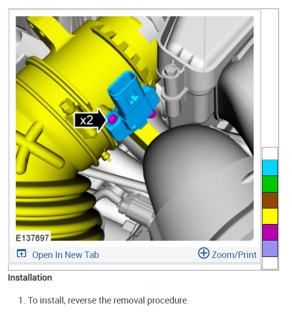

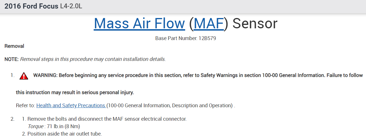

Allright, that is pretty straight forward, I would get a new MAF sensor, here is the location. Don't forget to clear the codes once the repair has been made. Check out the images (below). Let us know how it goes.
