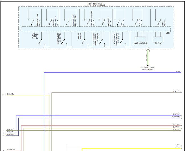

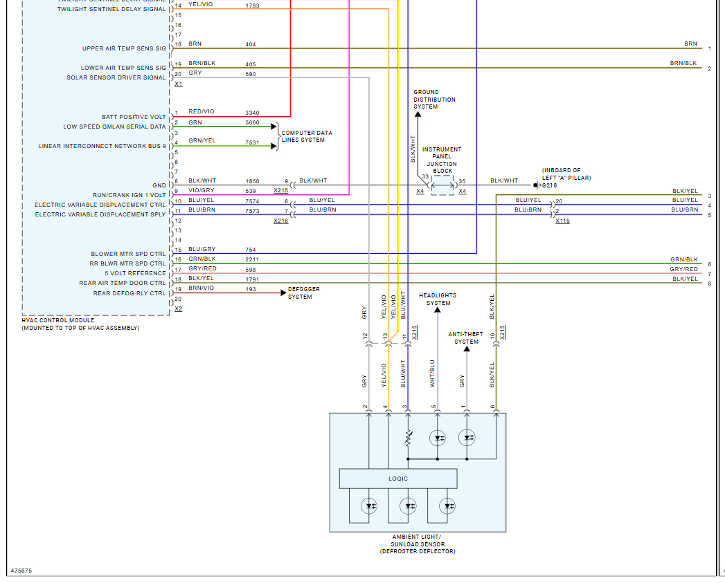

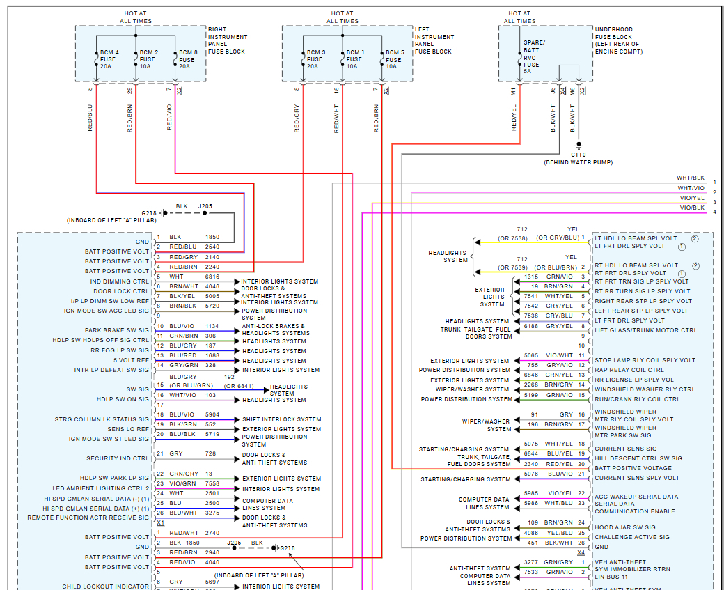

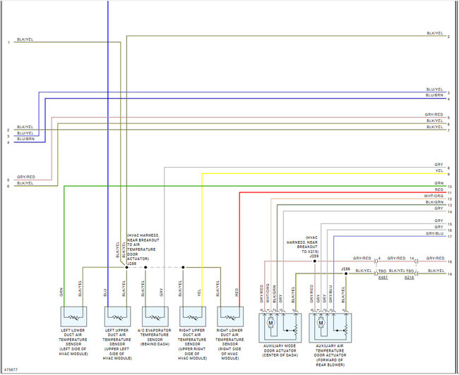

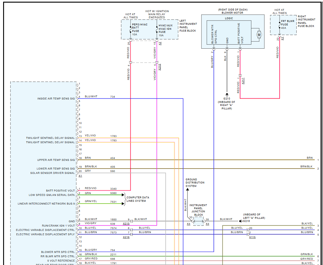

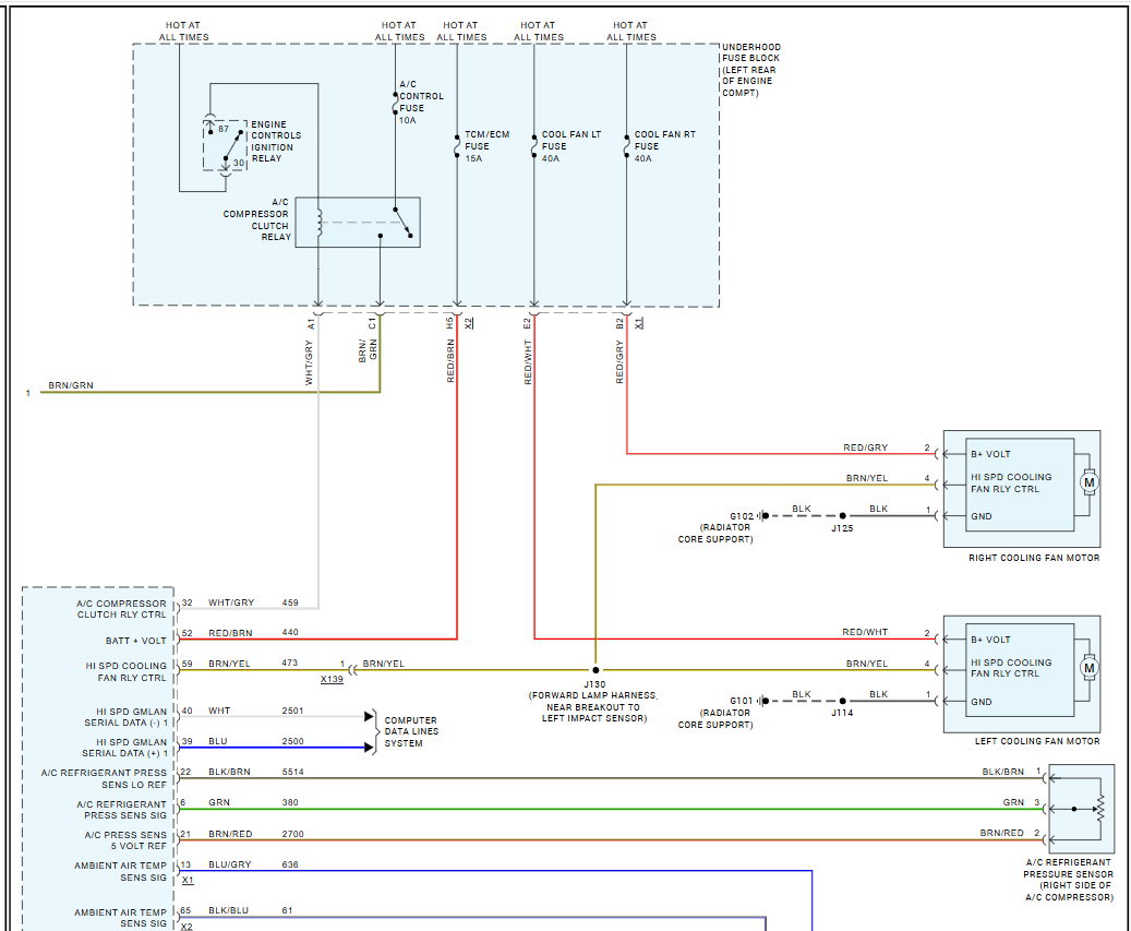

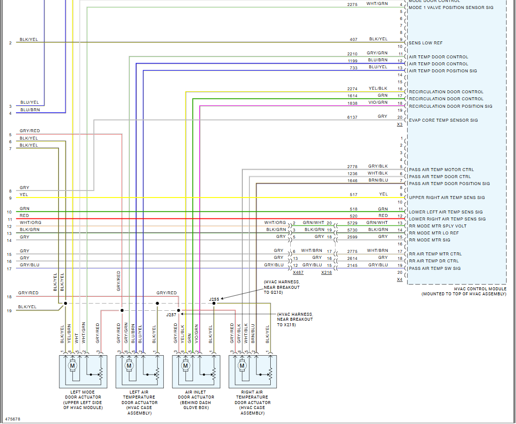

I have a problem with the A/C. It is not working sometimes. Could you please write wiring diagram for all items connected to A/C sensors and LIN BUS? Where is A/C controller/driver? What does it mean U1511.00? When I connected the car to scan tool there was information, that there is not connection to AC/LIN. What shall I check or do? I am waiting for your reply.

The first thing I would do is check the battery voltage which should be 12.4 standing, this guide can help:
Replace the battery if it fails the test and clear the codes.
U1511: Lost Communication With LAN.

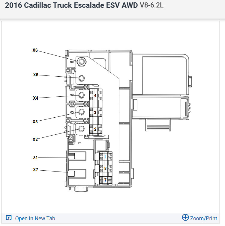

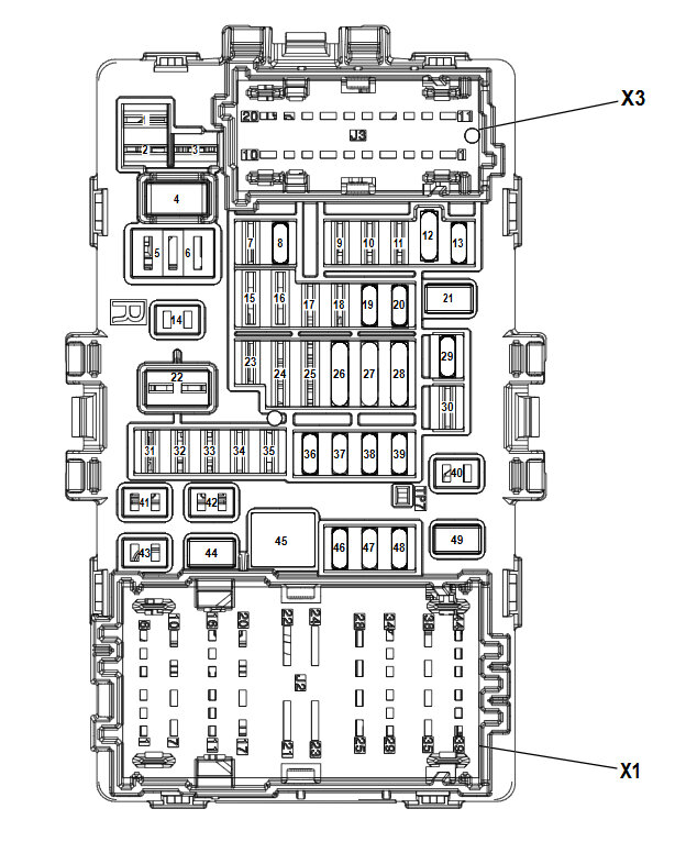

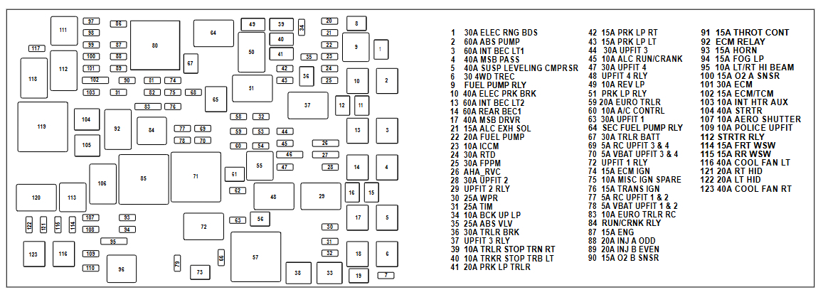

Next, I would check the fuses using this guide:

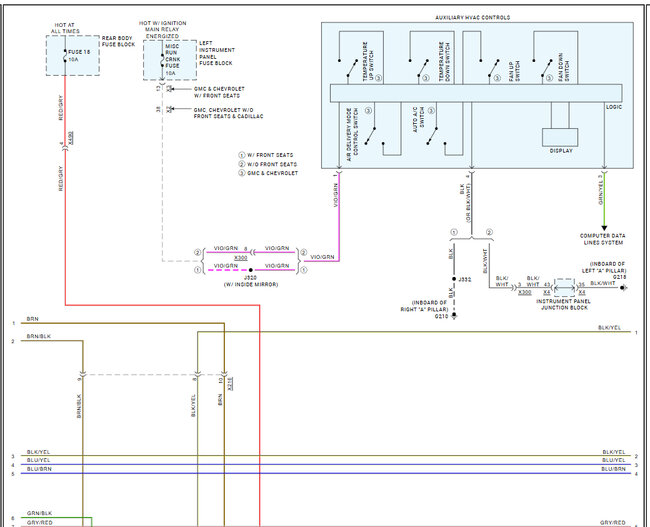

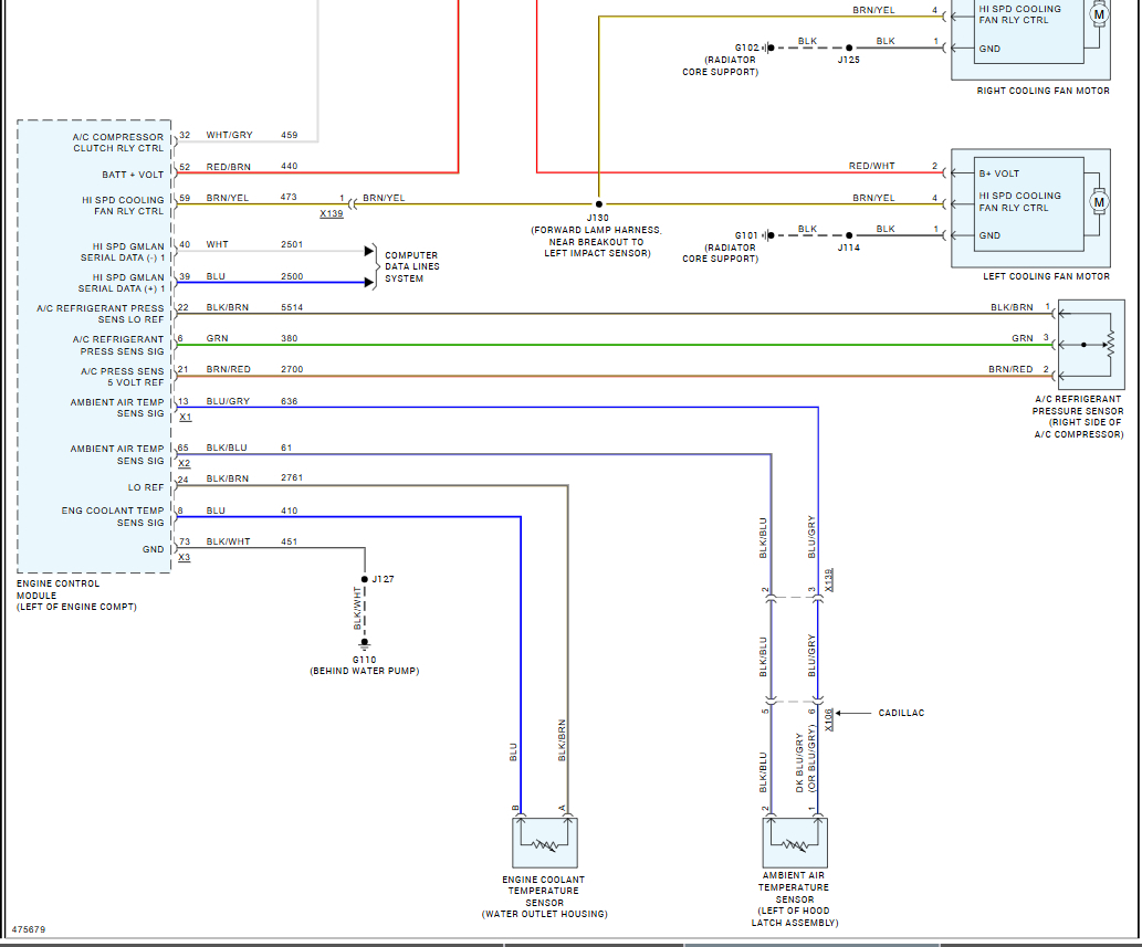

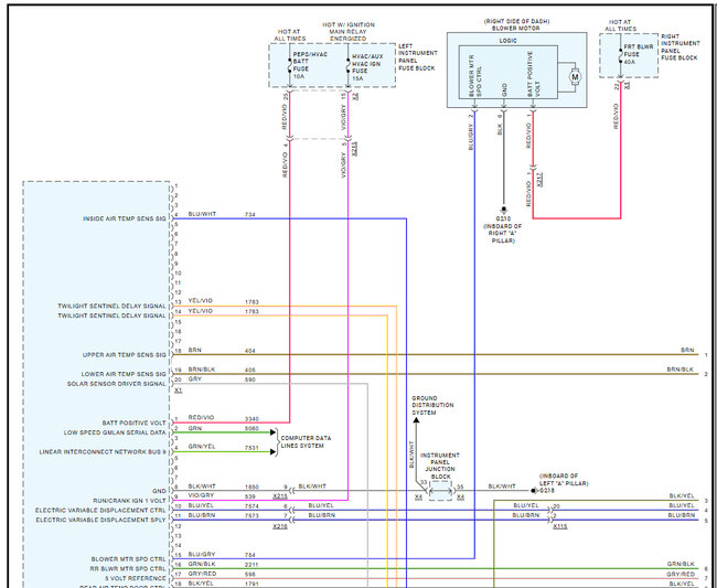

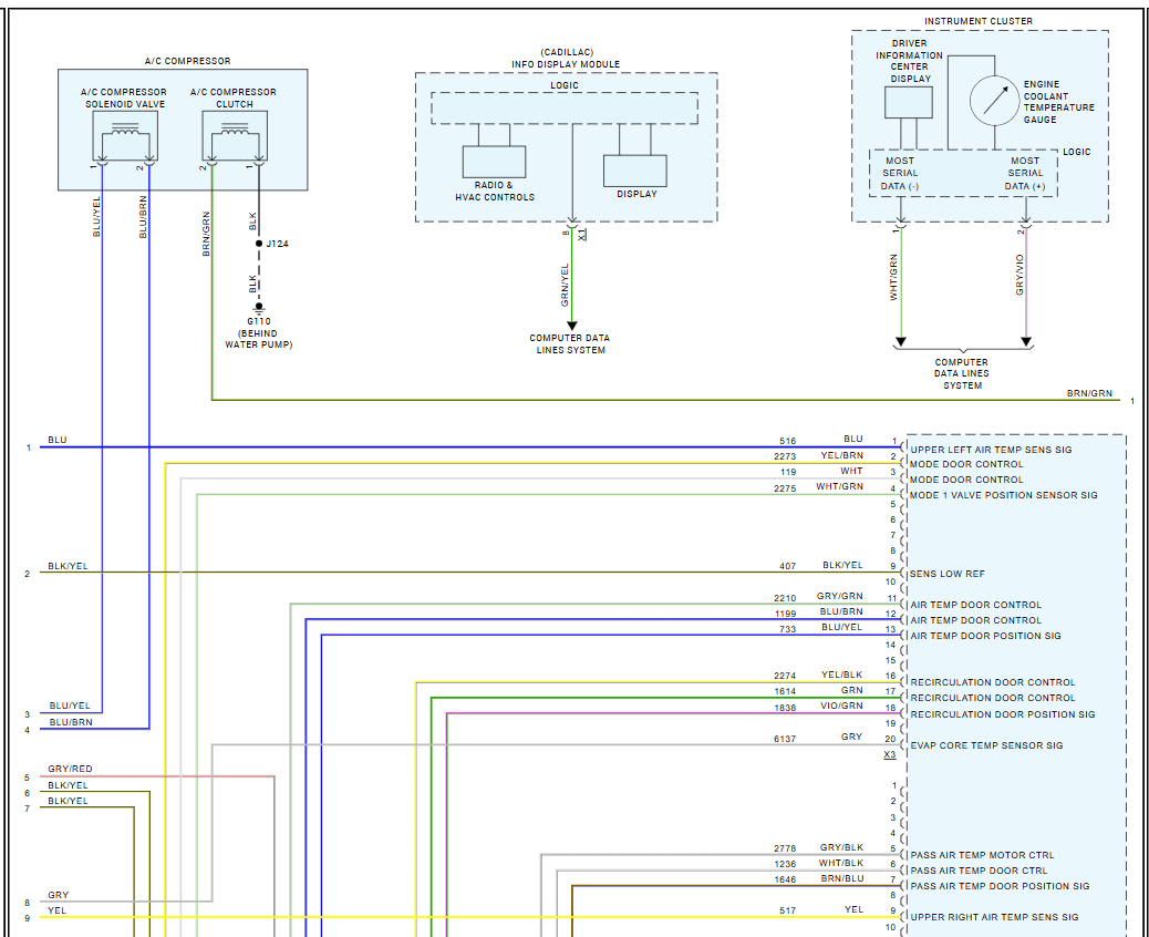

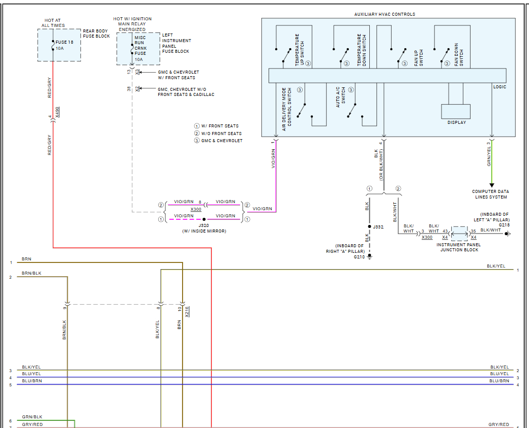

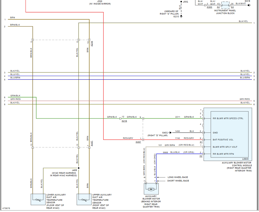

Here is the fuse locations and I have included the AC system wiring diagrams so you can see how the system works, and the sensors involved. Check out the images (below). Please let us know what happens. Please check the fuses with the key on.

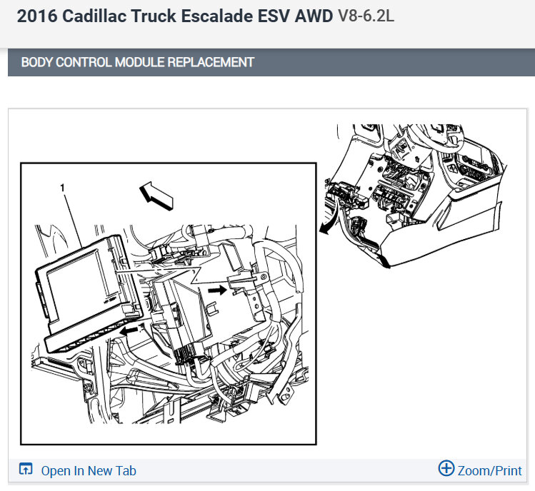

I was going some research and the EBCM can be out which might cause these issues. Here is the location of the unit so you can get a preprogrammed unit by searching Google or Ebay. Check out the images (below). Please let us know what happens.
Dec 2, 2024 at 1:54 AM

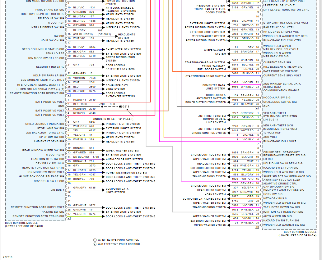

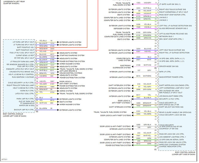

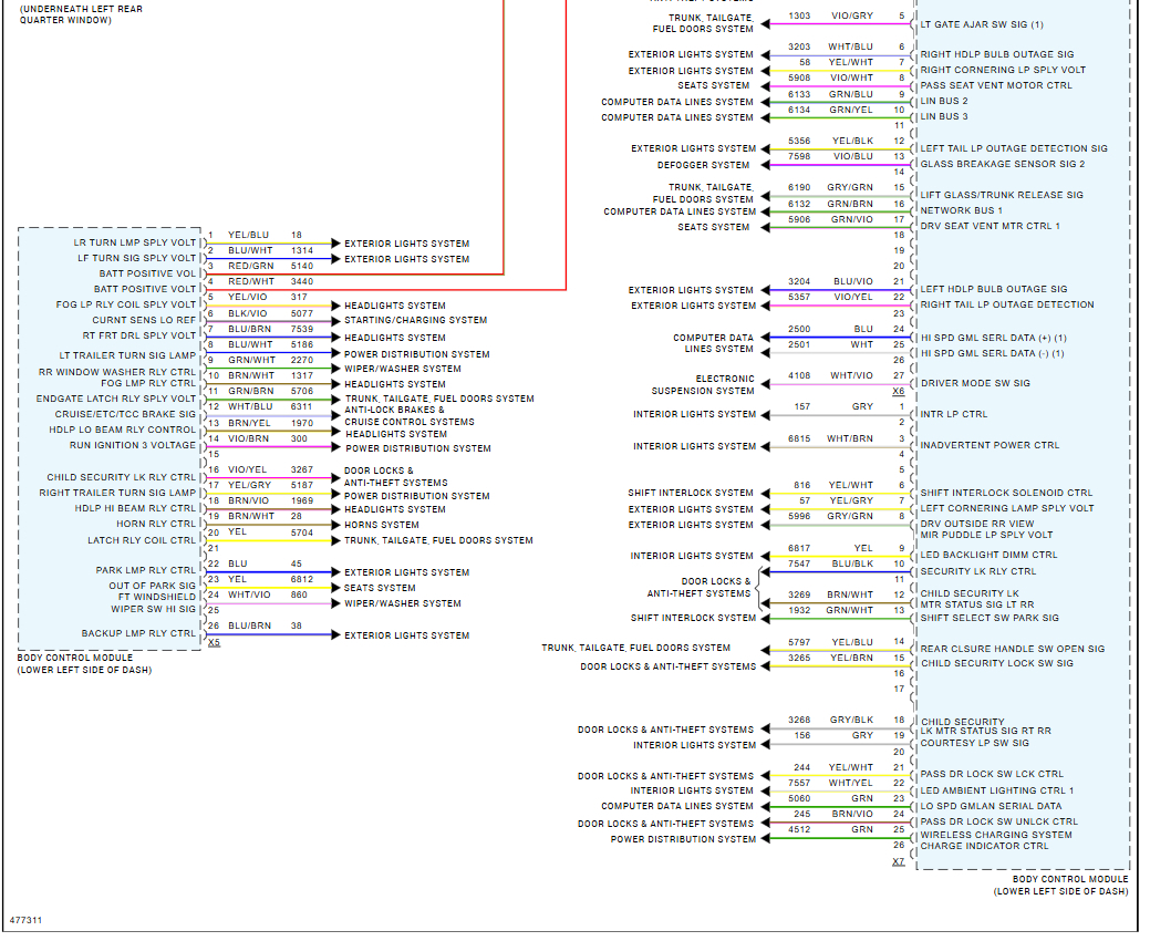

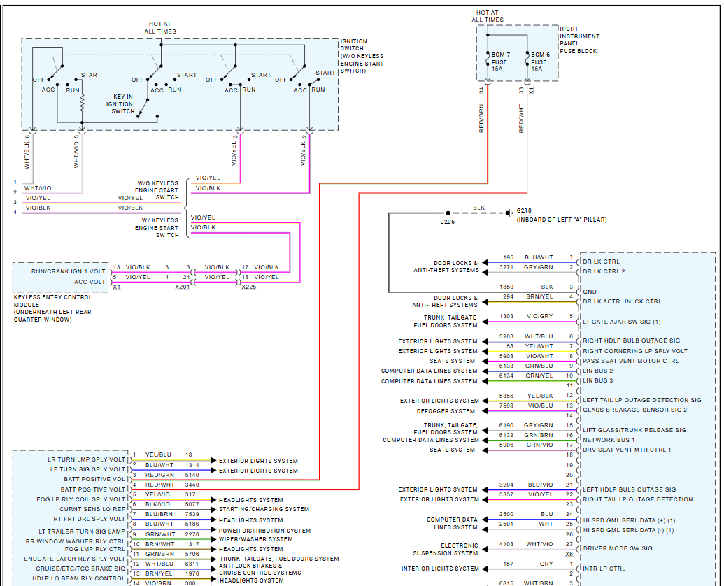

2. Could you please add wiring diagram between front bumper and EBCM? EBCM have some different connectors. Which one connector (plug) on EBCM goes to front bumper.
Dec 2, 2024 at 3:24 PM

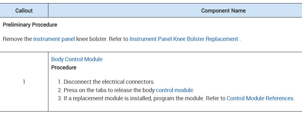

  • 55,421 POSTS

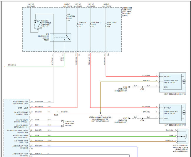

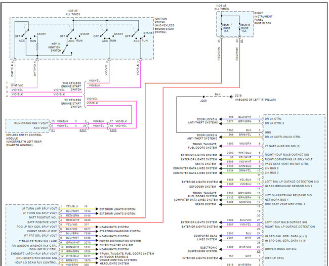

The replacement BCM needs to be programmed before it will work so you can't just plug one in. You can get them preprogrammed if you search google or eBay for a service that does so. Here are the wiring diagrams for the BCM, I would recheck the fuses for the BCM as well. Check out the images (below). Please let us know what happens.

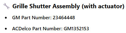

The mechanic found the problem with code U1511.00 - it is a problem with the front bumper active shutter. I do not have an original shutter. This shutter should be controlled by two actuators. I connected other two actuators and the error switched off. I bought the new one shutter controlled by only one actuator and the error is on. But I do not know what is the right part number for shutter with two actuators for my car. The VIN is 1GYS4KKJ4GR132788.
Could you please type the right part number for active shutter with two actuators?
Mar 24, 2025 at 7:56 PM
  • 55,421 POSTS

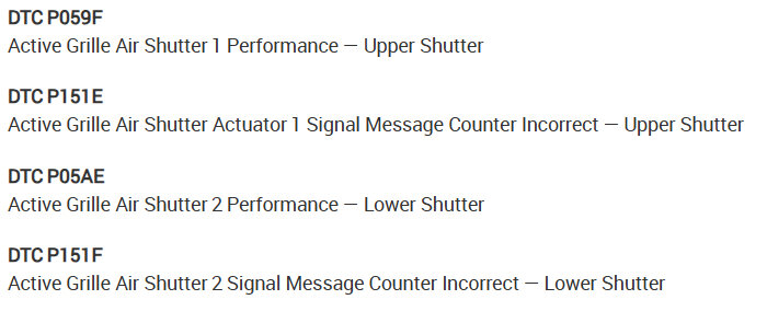

Hmm, no information I have or on the web says anything about the U1511 code being the shutters? Here are the shutter codes FYI.
U codes are for the network, here are the shutter part numbers, please let me know how it goes. Check out the images (below).
Mar 25, 2025 at 4:11 AM
PAWEL_N
  • 178 POSTS
Thak you for your reply. But the number GM1352153 is described as Front Driver Side Interior Door Handle (Standard Line) for Chevy. Are you sure that is it part number for shutter?
Mar 25, 2025 at 4:33 PM
  • 55,421 POSTS
The part number info came from Ai so no. They don't give the part number in AllData. There is only one mention of the shutter on the web for this code. The rest are all over the map. I would call the dealer for the part number, if it works, please let me know I am interested. Be sure to clear the cods once the repair is made.

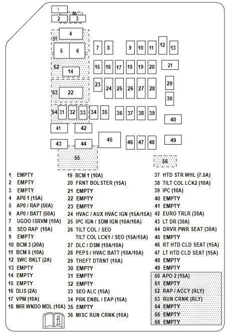

The active grille shutters are not normally set up with one motor on each side. They are usually set up as an upper and/or lower shutter assembly, with the actuator/motor attached to the shutter frame. If your Escalade is equipped with two shutter assemblies, one would be for the upper grille opening and the other would be for the lower opening.
Since the U1511 code started after the collision repair, I would inspect these items:
1. Wrong shutter assembly installed: Some GM/Cadillac applications look similar but are not wired or programmed the same. If the shop installed a single-actuator unit on a vehicle that originally had upper/lower shutters, or installed the wrong part number, the ECM may keep setting a code.
2. Damaged wiring near the impact area
3. Blown fuse or missing power/ground at the actuator. U1511 is commonly communication-related, so if power and ground are good, the LIN wire between the ECM/body harness and shutter actuator needs to be checked.
4. The A/C concern can be related because the shutters affect airflow through the condenser and radiator. If the ECM cannot confirm shutter position or communication, it may set a fault code.

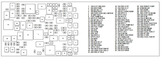

Please check these the fuse location which is the AREO SHUTTER fuse 10 amp in the fuse panel on the left side of the engine compartment. This video can help you.
