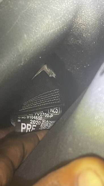

2020 I saw on the seat belt. I have attached an image of it.

That means the belt was made in 2020, so the truck could be either year but possibly the 2021 if that is the VIN from the tag on the dash. Also need to know if it has the memory seats. FYI it also should have a door sticker with the build date on it.
