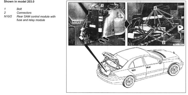

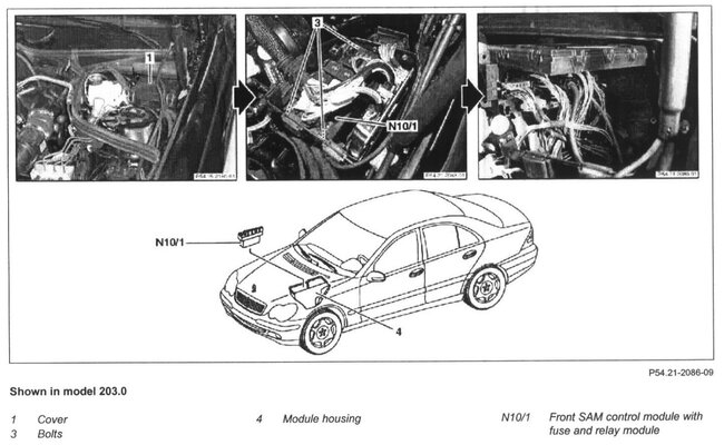

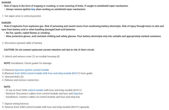

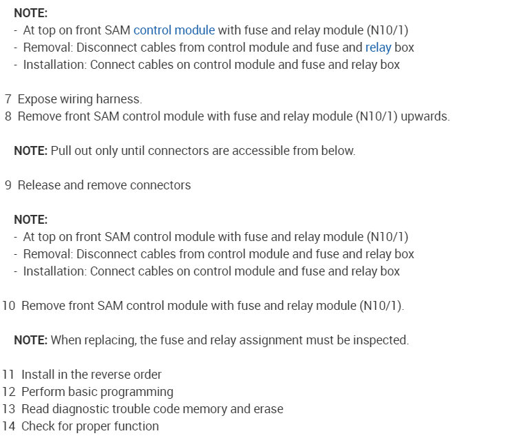

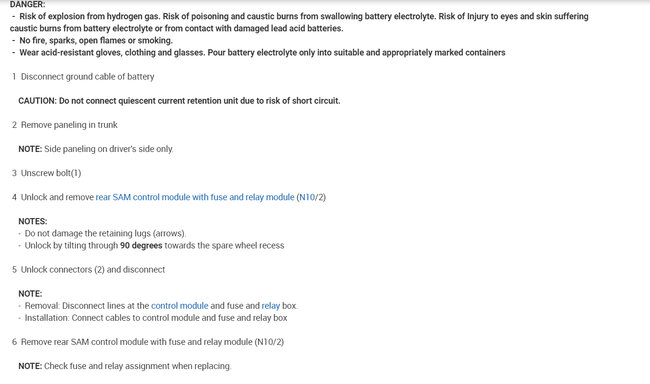

It is common for the SAM modules to go out if all fuses are good, I would try swapping the SAM module out. Here is how in the images below.

Thanks a lot fixed change ECU and ezs and els and now everything back to work.
