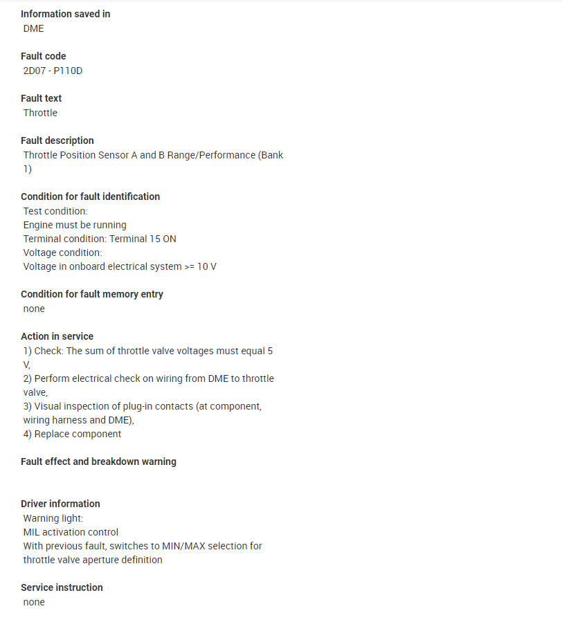

Fault codes: P110D, 2D07, 2CF8
2006 BMW 118I
58,588 MILES • 2.0L • 4 CYL • 2WD • AUTOMATIC
BMW_STEVE
I have replaced the throttle body which has the sensor attached, and replaced the connector to the throttle body but still getting these codes related to the valve, potentiometer and engine control module
Aug 5, 2021 at 11:09 AM
I suspect this is a DME if you have already replaced the throttle and the connector however, here is the testing that we need to run through for the primary code.
I would suggest we start with this and just run through this quick testing because the code is pretty straight forward that it is either the sensor, wiring, or DME.
Plus if you have other codes pointing to the DME then it is pretty safe to think that is the issue.
Please let us know if you have other questions and what you find with this.
