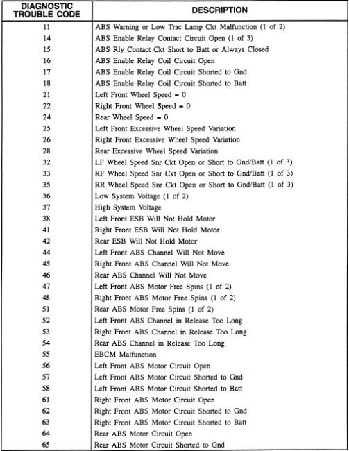

I have fault code 21, fault code 24 NZ, fault code 28, fault code 31 and fault code 59 what do these fault codes mean?

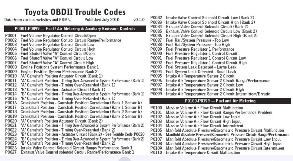

Below I posted all the Toyota fault codes OBD 1 and 2, I hope it helps out.

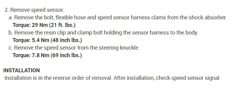

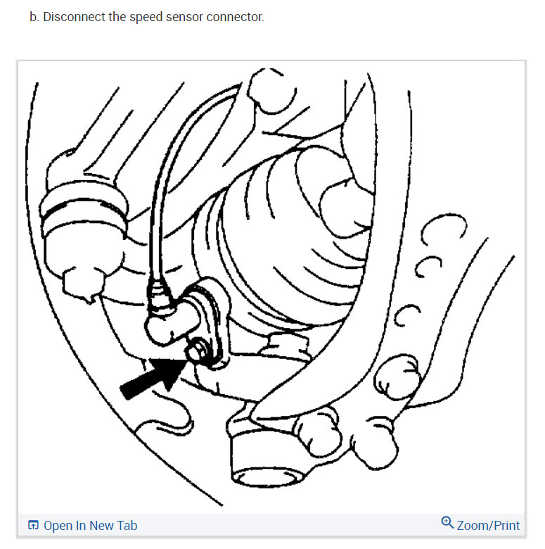

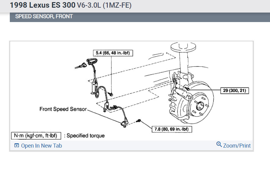

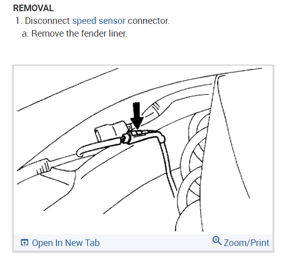

We can confirm the wheel speed sensors not working by following this guide. also I have included the instructions on how to change the sensors in the diagrams below.
https://www.2carpros.com/articles/abs-wheel-speed-sensor-test
