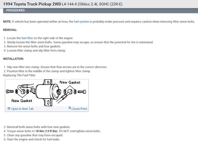

Check engine light comes on only after reaching operating temperature with a distinct loss of power. It just bogs down. Will changing out the air and fuel filters fix the mixture and knock issues? If so, the air filter is not a problem but I’m not so confident about the fuel filter. I could use some guidance. Thanks guys!

So, these codes are for lean mixture and engine knocking, can I ask how the engine sounds when it is running? The fuel filter on these clogs up so I would start with the filters, also can you upload a video of the engine running? If the engine is worn and has an issue such as timing chain guides or piston noise the knock code will not go away. Please let me know. Check out the diagrams (below). Please let us know what happens. The Fuel Filter is Located at the right side of the engine above the starter motor.

I’ve had this truck for 20 years and it has always ticked when running. Filters are on their way, so I’ll get back to you ASAP. Thanks!

So, I picked up my truck Wednesday afternoon after having the fuel filter swapped out (which the mechanic said was pretty clean) and the check engine light came on within a block. I’m going to drop it off Monday morning so he can check it out. Thanks, Rick

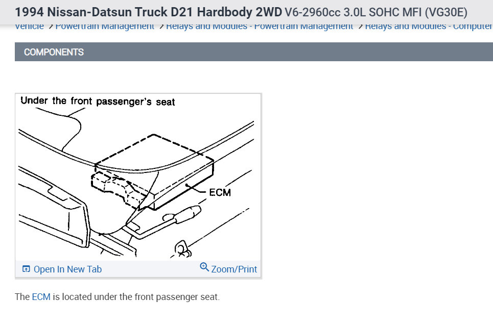

It sounds like the ECU is not working correctly, let me know what they say.

What is the ECU?

Sorry the ECM (engine control module) Check out the images (below). Please let us know what happens.

The mechanic used two different sensors, but the truck would lose contact after about 10 seconds, so he wasn’t able to read the codes. Any ideas?

Yep, it sounds like the ECM is out, I would try replacing it to fix the problem.
