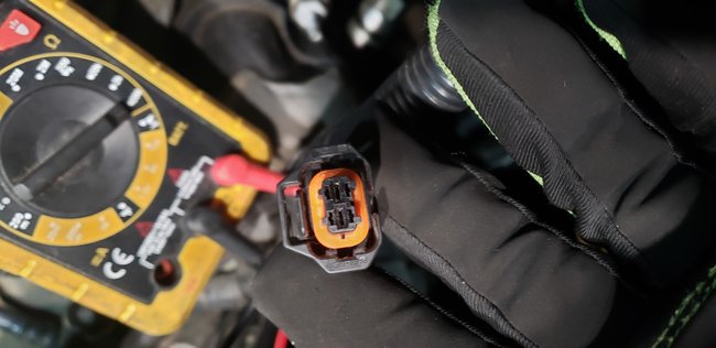

Pulled the pump but doing know how i would see the lobes unless I tore the cover off. DMM I think is junk because i couldn't get a good reading to save my life. Other Dmm wouldn't budge of 1. Tested what i believe is the fuel pressure release valve which read about 9.5ohms which could be the problem if my meter read that right.

The 9.5 ohms is which pins?. And you would need to remove the cover to see the lobes. Did all other tests fall within spec or were you not able to get a good reading?
Feb 10, 2021 at 10:51 AM
BRAD KLEIN
  • 17 POSTS
The 9.5 was just the resistance on the fuel pump itself. What pins after you referring to? Off the ecm? I assumed you were referring to checking the ohms off the connector going directly into the g18 hpfp.
Feb 10, 2021 at 4:09 PM

No because i don't know what pins I'm supposed to check unless your talking about the connector that hooks into the hpfp.

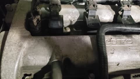

Did not fix. Getting exact same codes. I can't believe i didn't notice this before. Tell me what you think.
Feb 19, 2021 at 4:20 AM
  • 110,244 POSTS
I watched the video two times. I'm not sure what you are seeing. Let me know.

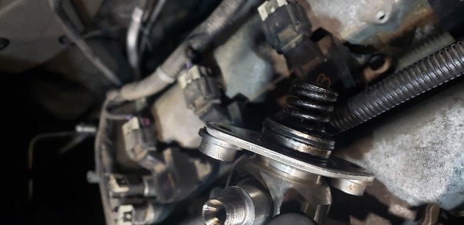

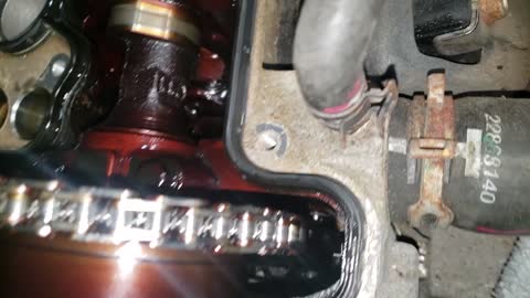

No that's weekday I'll be working on this week. Been researching and finding timing chain issues as well but i don't know if that would affect the high pressure fuel pump. Seems like it would be more related to camshaft. If i were to find its camshaft I'd it better thi replace intake and exhaust since i'm in there?
Feb 21, 2021 at 1:55 PM

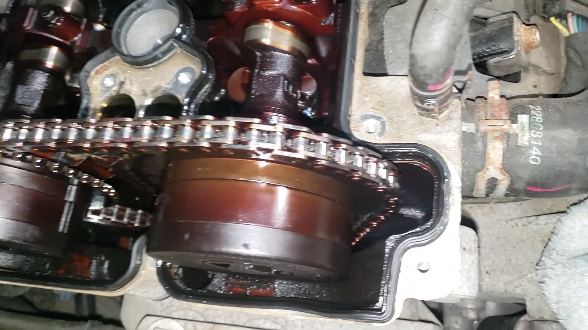

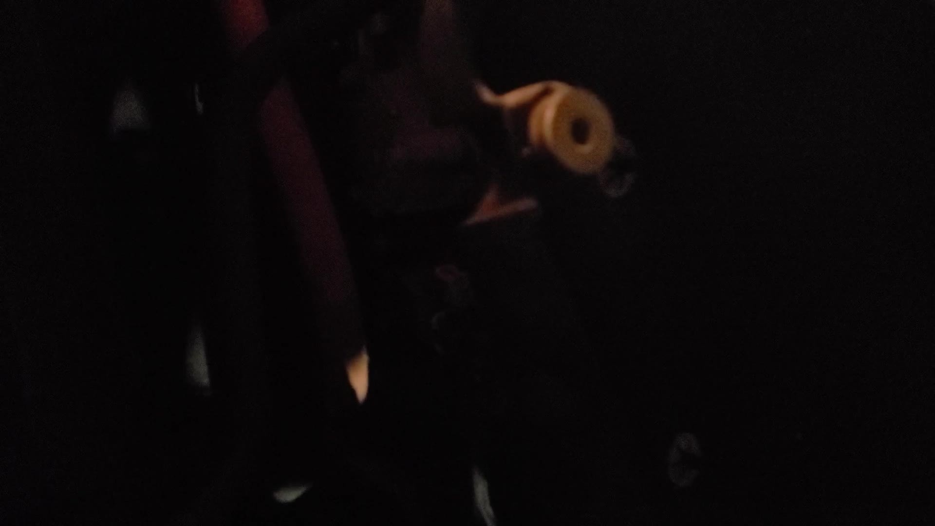

BRAD KLEIN
  • 17 POSTS

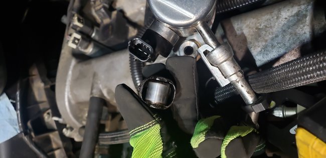

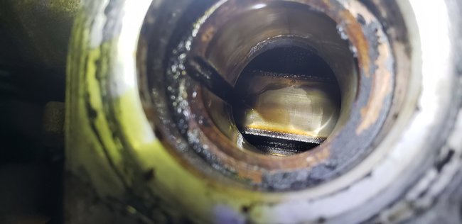

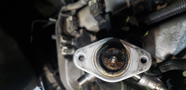

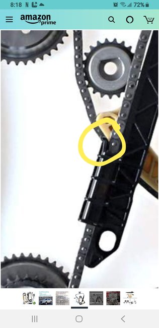

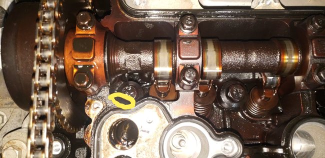

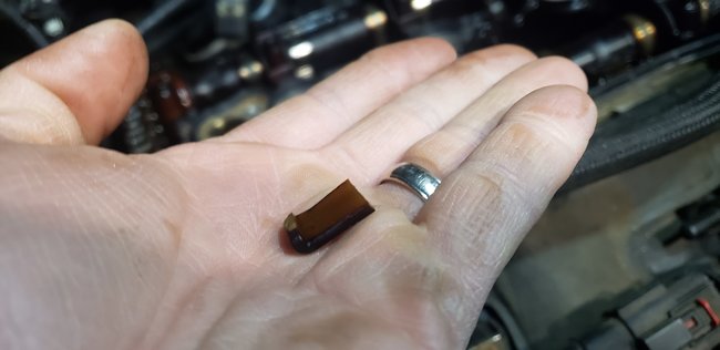

Lobes appeared to have normal wear. Timing chain felt firm. I did find a piece of plastic inside close go the timing chain shaft which i circled in the pictures before. I'm at a complete loss.
Feb 22, 2021 at 6:42 AM
BRAD KLEIN
  • 17 POSTS
Don't know if that's the piece that broke off. The chain seems tight though unless chipped or missing tooth?
Feb 22, 2021 at 9:29 AM
  • 110,244 POSTS
That looks like a piece from one the guide. Actually, the exact portion you circled in the last pic. As far as the cam, there is nothing obvious that I'm seeing. However, without using a mic, it's hard to tell.
