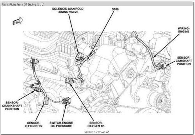

Fault Code P2078 - Intake Manifold Tuning Valve Position Sensor Switch Circuit High
2008 DODGE AVENGER
37,000 MILES
RLCASS
How do I repair or replace the part for this fault code. I would like to correct his problem myself as I am in Korea and dealerships are not located close to me.
vin: 1B3lC56R28N607573
Jul 31, 2013 at 3:57 PM
  • 55,224 POSTS

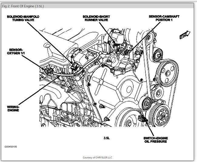

Hey RLCASS,
This will be problem with variable intake valve being shorted out in which case it needs to be replaced or the intake actuator valve is stuck inside the intake. Remove the valve for inspection and replace it if you can find nothing wrong, you will need to clear the codes as well, here is a guide of that and diagrams of the valve below.
https://www.2carpros.com/articles/check-engine-light-clear-codes
Please let us know happens so it will help others.
Best, Ken
