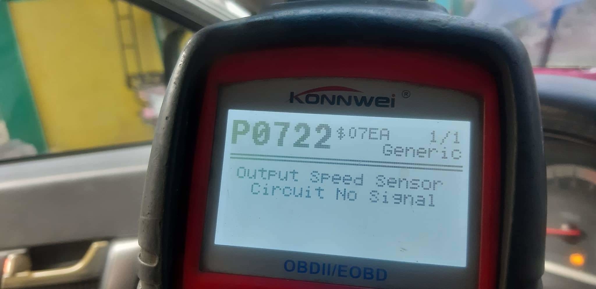

Fault codes P0722 and P0850, where is the Output Speed Sensor located?

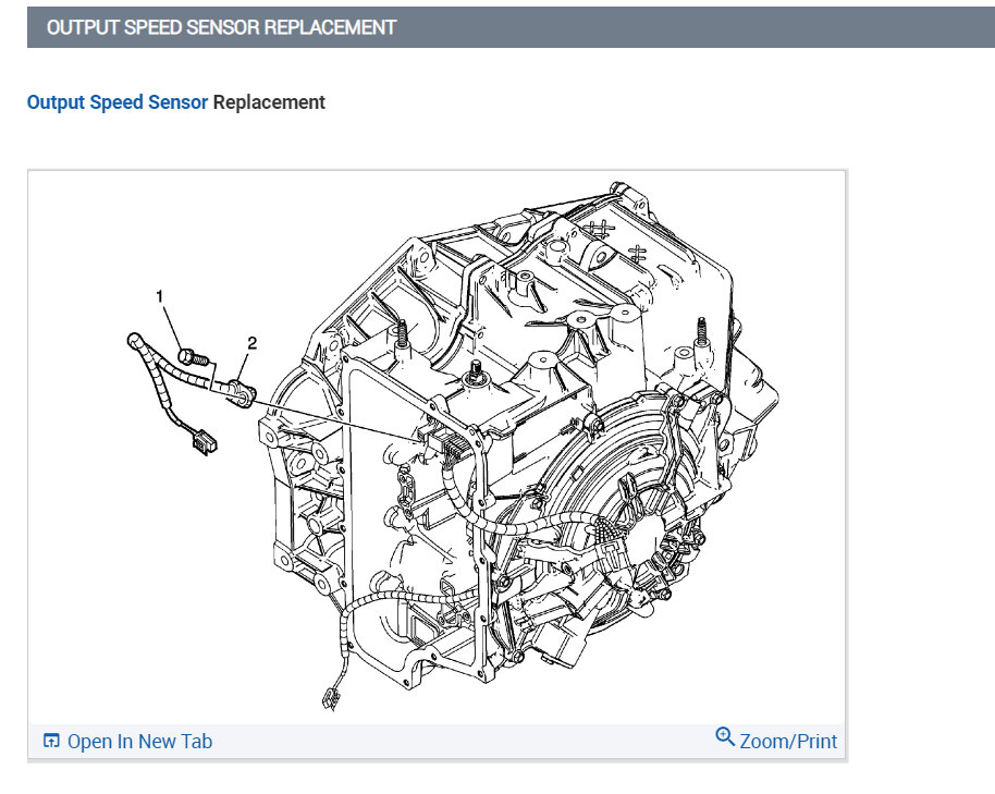

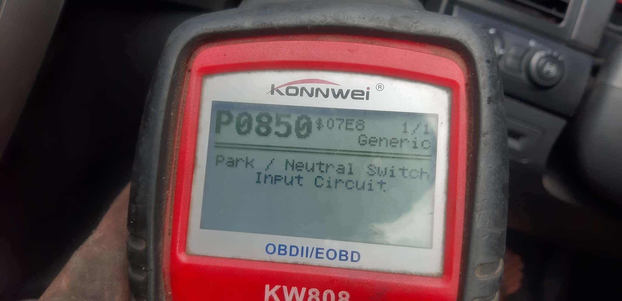

Does anybody know the output speed sensor's location and the Park/neutral switch input circuit? Thank you in advance.

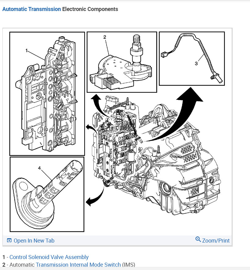

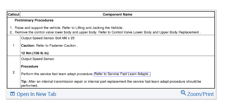

The output speed sensor or VSS is located inside the left side pan so that will need to be removed. Here is the location and how to change the sensor out in the images below. They call the park neutral switch a mode sensor. Check out the diagrams (below). Please let us know what happens.
