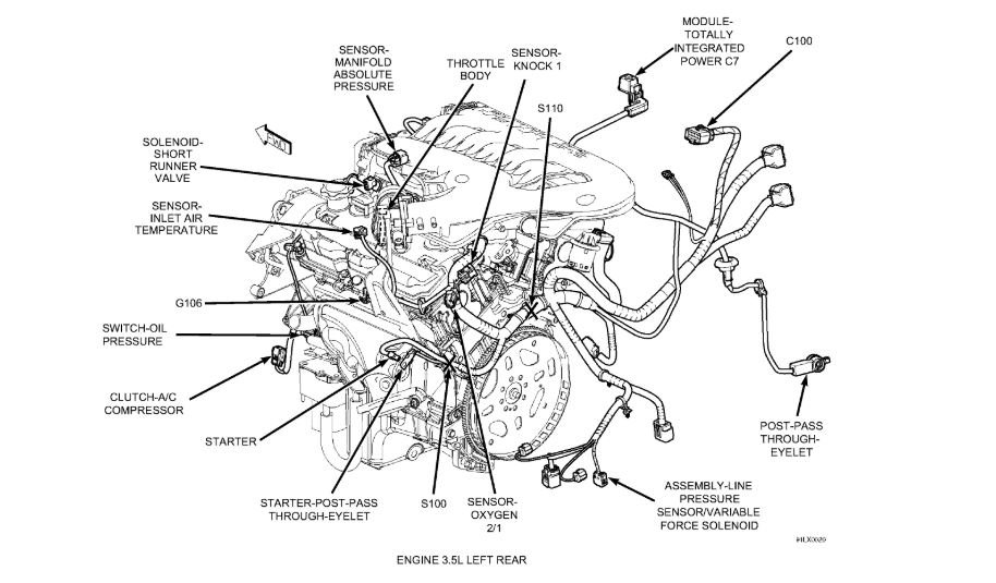

I feel there is problem with my engine after getting engine check light on dashboard. Then I did code check, I got these four codes on dashboard.
Nov 24, 2018 at 4:34 AM
Good morning,
The 1128,1129 codes are for fuel mapping from the PCM. It is not seeing the correct information to control the fuel mapping from the O2 sensors. You may need O2 sensors, but needs to be confirmed. I posted a list of possibilities below that need to be checked by someone with a scan tool.
The 171,174 are for lean condition. It could be from a vacuum leak, low fuel pressure, PCV valve or a mass air flow sensor. Again, all these items need to be checked for the failure. I posted the possibilities below for this as well.

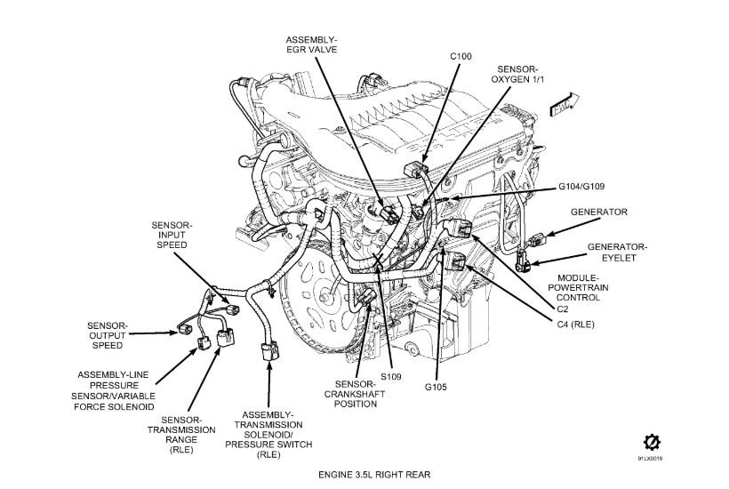

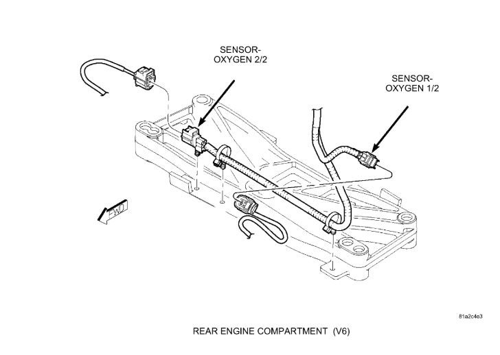

Could you please send locations for all sensors, engine mechanical system and fuel lean system?
Nov 24, 2018 at 10:05 AM
O2 sensor locations attached as requested.
