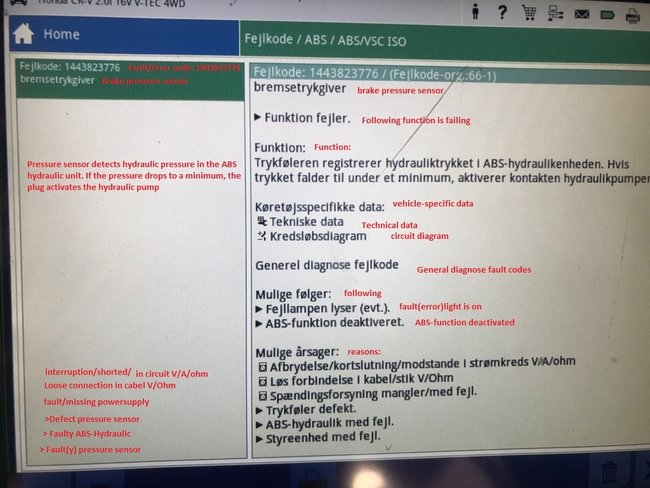

My mechanic is getting following error code, and not sure what to do about it. I have a feeling it might be just a reset, but if so how do we go about it? and if not then any idea what the next step will be? getting a new ABS sensor (pressure) is impossible for this old car, so i am willing to try almost anything. (See screen dump)

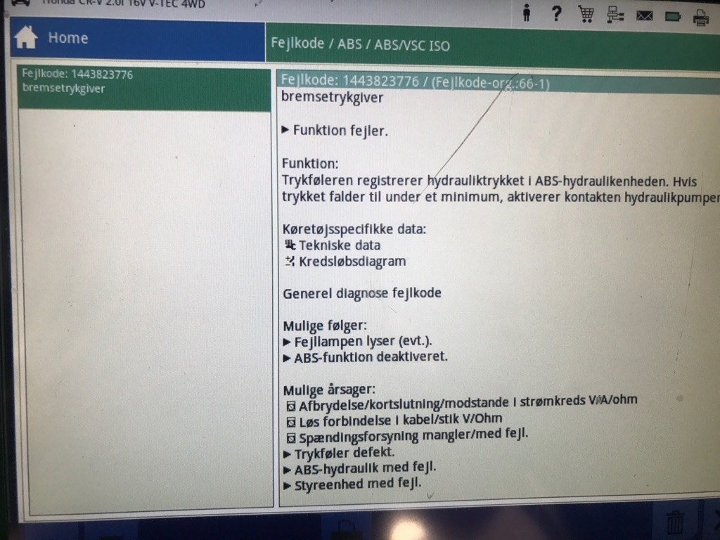

Can you post the code as set? i do not understand what is on the screen sorry, can you translate to English? These guides can help us find the problem or code and fix it

Of course. I have added the same screen dump, just with a translated version. Hope this will help.

Hmm.. I don;t see the code number if you can just give us that we can get the problem fixed for you.

It is the number up in the left corner Fault code: 1443823776

We don't have codes like that here in the US does it have an "P" code equivalent? like P0121?

That is what i noticed too, when i started searching...I thought everyone had the same kind of numbers. I am not sure what the conversion is.. he believe the whole unit has to be change out.. i believe a reset is enough... but I am not sure what the step for a ABS sensor system reset is?

There is no reset becasue the system is real time. All working the light goes out. Can you test the wheel sensors manually? HEre is a guide to show you how.
https://www.2carpros.com/articles/abs-wheel-speed-sensor-test
