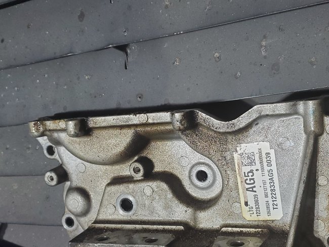

I am having problems finding any answers to this specific engine on the internet. My car listed above has a turbo automatic 6 speed transmission. My vacuum pump on the end of my exhaust camshaft froze or broke and ended up binding up and bending the exhaust camshaft. Beyond finding parts because of GM strike i cannot find out what kind of sealant to use on the side plate going back on and i need to know to torque on such plate the cam bolts and arms on the cam as well as the valve cover bolts. and anything else i would need to know or should know putting everything back together from the timing chain to complete install that normally would be missed.

I'm trying to get it to post. There is something wrong, not sure if it's the post, pictures or what at the moment, but I'll keep trying. The front cover sealant is sensor safe rtv.
Oct 20, 2019 at 10:05 AM
STEVE W.
  • 15,423 POSTS
applied as in image Spot 1 is a 5mm bead, 2 is a 5mm bead, 3 is a 14 mm dab.
Oct 20, 2019 at 10:06 AM
STEVE W.
  • 15,423 POSTS
The cover torque is a sequence. These are new bolts for 1 through 3
1 and 3 first pass to 11lb ft. final pass of 130 degrees
4 to 15 all to 18ft.lb
16 to 19 are 89 inch pounds
number 20 is 18 ft.lb.

That what you were looking for?

Yes sir and cam sprocket bolts and valve cover but you have done a lot already.
Oct 20, 2019 at 10:28 AM
STEVE W.
  • 15,423 POSTS
Cam cover - 89 inch pounds.
Cam actuator bolt - 22ft lb plus 100 degrees.
Do you have the special tool to lock the cam in? EN 50793
Oct 20, 2019 at 10:36 AM

You are supposed to have the timing chain on and set the timing and then use a tool EN-50656 to lock the chain, then the other tool locks the exhaust side.

So you torque the intake cam before you put cover on. in trying to understand when to torque the intake cam actuator cause of the vvt on both intake and exhaust.
Oct 20, 2019 at 1:22 PM
STEVE W.
  • 15,423 POSTS
It's a strange system, but you place the intake cam into the exhaust cam position, then install the locking tool, and install the actuator and bolt and torque it down. Now remove the locking tool and lift and roll the intake cam under the timing chain across the head into it's correct position and as close as possible to it's timing marks. Now you can put the exhaust camshaft into place and install it's actuator and time both cams to the correct spot. You need the locking tool to hold things in place as you torque the bolts. The timing chain lock is normally used when you are taking the cams out, it holds the chain up and keeps it from releasing the tensioner.

Torque on harmonic balancer is only thing else I can't find. Otherwise everything you helped me with was awesome.
Oct 24, 2019 at 9:42 AM
STEVE W.
  • 15,423 POSTS
Using a new bolt torque to 111 ft.lb. then add 140 degrees.
