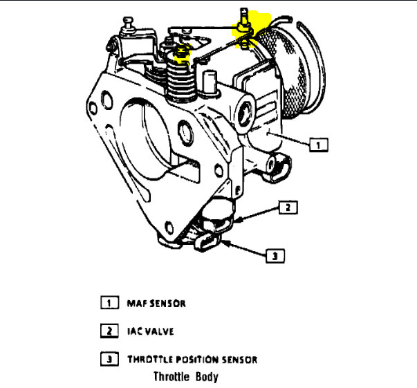

After first starting the engine, idle speed is okay. But as soon as the accelerator is pushed even gently while in forward gear, the idle goes to a fast idle that will drive the vehicle at 30 MPH in 3rd (about 20 MPH in 2nd).
The idle speed will not go down until the car is brought to a stop (which is harder since it is trying to drive itself). Once the car is stopped (in gear), the idle speed returns to normal. But every time the accelerator is pushed again to drive, the idle goes back up fast and won't come back down until it is brought to a stop again.

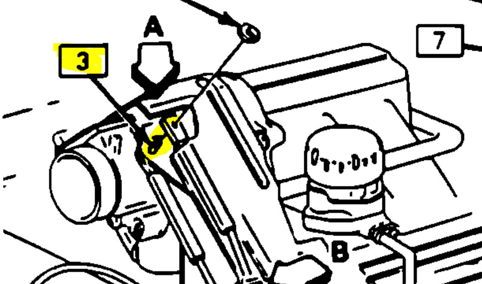

This vehicle has a throttle cable. Have you inspected it to make sure it isn't fraying or hanging up? The cable runs from the throttle pedal, through the firewall, and to the throttle body.
With the engine off, remove the air inlet tube between the air filter box and the throttle body. Have a helper gently press the accelerator pedal and gently release it. Check to see if the cable/throttle plate lever is returning fully to closed.
I attached two pics below. I indicated where you should lubricate the linkage. Try spraying a little penetrating fluid on that area and see if it changes what is happening. If it doesn't, then we will need to inspect the idle air control valve.
Let me know what you find.

I originally took the car in because it had a service engine soon light, and it was idling fast all the time (even when stopped in gear at an intersection). On that visit, they did the following:
Scan the vehicle for codes.
Clear codes: Lean 44
Check for vacuum leak, fuel pressure
Tighten side cover on transmission, adjust spring tension (had catch)
R&R Throttle position sensor, clean throttle body
R&R Mass air flow sensor
(+the usual oil change etc.)
When I got the car back, it seemed better. The service engine soon light was off and it idled slow when first starting and had a slow idle at stop lights, but something seemed off while driving and eventually I realized that the idle was bumping up fast as soon as the gas was applied with the car in gear. It made the car drive itself at about 30mph in 3rd and harder to stop. But once stopped the idle wound down to a slow idle, until the gas applied again. It doesn't happen in neutral (After starting one can step on the gas in neutral and it returns to a slow idle. It only happens in forward gear. I had read online that maybe unplugging the power to the computer and resetting might fix it so we tried that, but it didn't help.
I'm just wondering if you can think of anything else that might cause this. Did it sound like they did the lubrication you mentioned in your first post? Though would that problem affect the idle in both neutral and forward?
