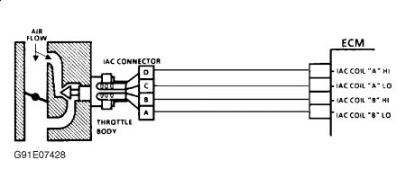

Ok I would like you to check the vacuum hose to the power brake booster and the one to the PCV valve look for any cracks and check for any intake leaks with a spray bottle of water. If all that checks out then I would like to test the IAC (idle air control) motor. First you will unplug it and check resistance between term a and b on the motor not the wire harness. Then between term a and c then a and d the resistance should be 40 to 80 ohms if not replace that motor. If it is in spec then you need term b and c then a and d should be infinite if not replace motor. Here is a pic for the term locations and let me know what you find.

Thanx again--the ohms on my crap meter only reads in "x1k" which shows around 50 from A to B , the rest don't show. But I just bought another 1993 olds 98 reagency with the exact same motor and I'm getting the same reading. Since I first had the idle valve replaced when all this started- I'm going to assume it was and it is good. All other vacuum lines look OK. Chuck
