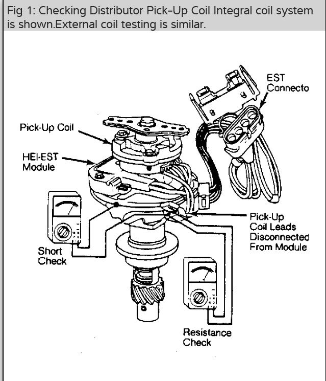

Began with fast idle that could not be adjusted with the throttle set screw.
Now cold start takes longer and after it has been run, may not restart (no hot start). Engine cranks fine, fuel is reaching the four bbl carburetor (I can smell it and fuel pump clicks with key in 'start' position), choke seems to be off, secondary plate is closed. Cranks like it has no spark (does not catch at all) but once cooled down it will start again. Air cleaner is new. I have never changed any of the sensors. When started, the car runs perfectly. It is smooth, quiet, and powerful.

check pick up coil for resistance and broken wires and have ignition module inside distributor checked auto parts can do that. pick up coil resistance should be 500-1500 ohms try a heat gun on it to see if pickup coil goes high or wait until it quits.

I couldn't remove the rotor. There doesn't appear to be anything holding it (fasteners of any kind). Is there a trick or technique that must be applied to remove it without breaking the board that's beneath it? Do you have a picture of how to install the p.u. coil and the control module?

the first reply had a pic of the distributor which has to be removed the gear taken off then shaft pulled out to access pick up coil. the module is held in by screws.

How is the rotor removed? The old ones just used to pull out. This one won't come out by pulling and I don't want to risk cracking the board beneath it by prying it with a screw driver. Would some penetrating oil help loosen it up? Or would it contaminate the distributor parts? It's held quite firmly... is there a screw holding it (it feels like it's fastened in place but there's nothing visible)?
The picture doesn't show the module. Is it accessible from the top without removing the distributor?

the module is accessible with out pulling dist rotor cap should pull offtry moving one end then other like wiggling it off.

OK... so here I am again. Drove it for 4 days... smooth as silk, then wouldn't start again. I have new coil and cap (new coil is what solved the problem until it came back). Must change both control module and pick up coil to ensure system will deliver spark I think
1. Must the rotor be removed to change the control module or can I change it with the rotor still in place?
2. Must the distributor be removed to remove the pickup coil? I read somewhere else that 88's had a newer design that allowed p.u. coils to be removed without removing the distributor (which I dread doing).

I already sent how to remove pickup coil and dist has to be removed. just try moveing rotor out of way to get to screws

Thank you for all your help and good tips. Just for future reference and if it might help anyone else (I've seen several other inquiries on these cars regarding high idle, some that have claimed to have changed just about all related sensors without correcting the problem) After changing the coil, rotor, cap, control module, but not the pick up coil, the car is now starting reliably and running very smoothly. Curiously, the idle seems to have have come back down to or close to normal. Has the system perhaps been trying to compensate for weak or unreliable spark by forcing the engine to idle too high? Prior to the high idle problem, I had to set the idle higher to prevent stalling, then lower it again because it began idling too high. I haven't had the old parts tested yet so I can't be sure which one(s) were failing.
Before changing out the sensors on one of these, it might be wise to test distributor components in high idle situations or if the car is do for a tune up, just do a complete tune up (because it has to be done anyway) before buying new sensors. Unless one has had extensive experience with these systems, it's hard to ascertain what component(s) is/are causing the problem. The systems seem to be so complex it's hard to know if the computer, trying to do its job of keeping the combustion cycle as efficient as possible, is masking the real problem by causing another problem, in this case a high idle.
