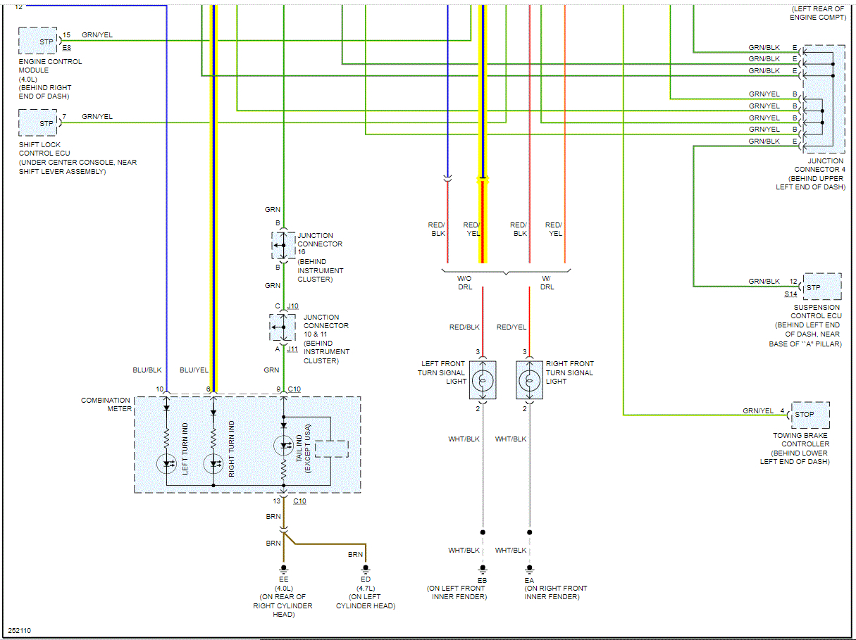

Left side turn signal works fine, right front signal blinks fast and right rear signal does not work. I have replaced the bulb and checked the fuses but still does not work. Also, I did not see any corrosion.
Please help,
Lynn

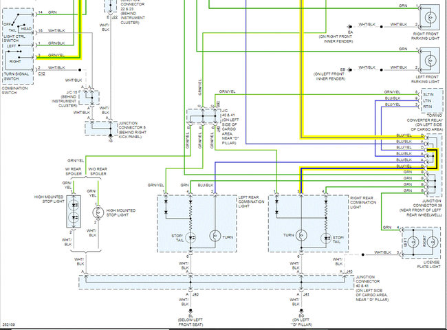

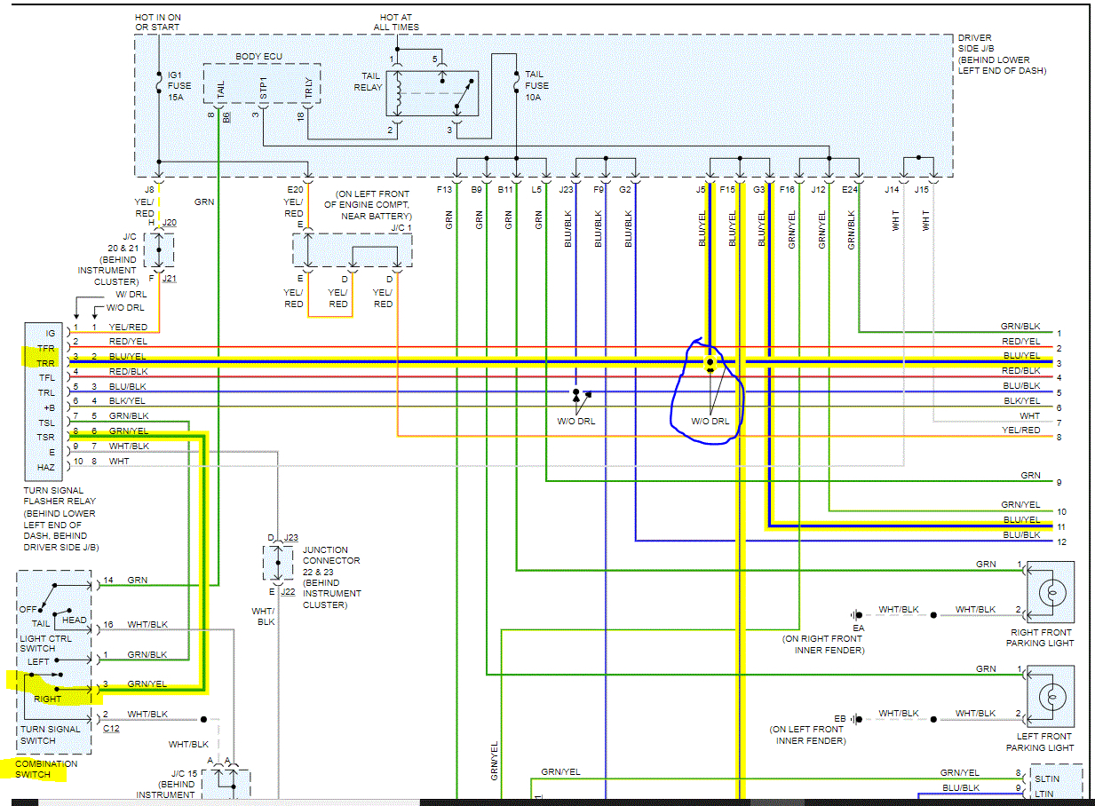

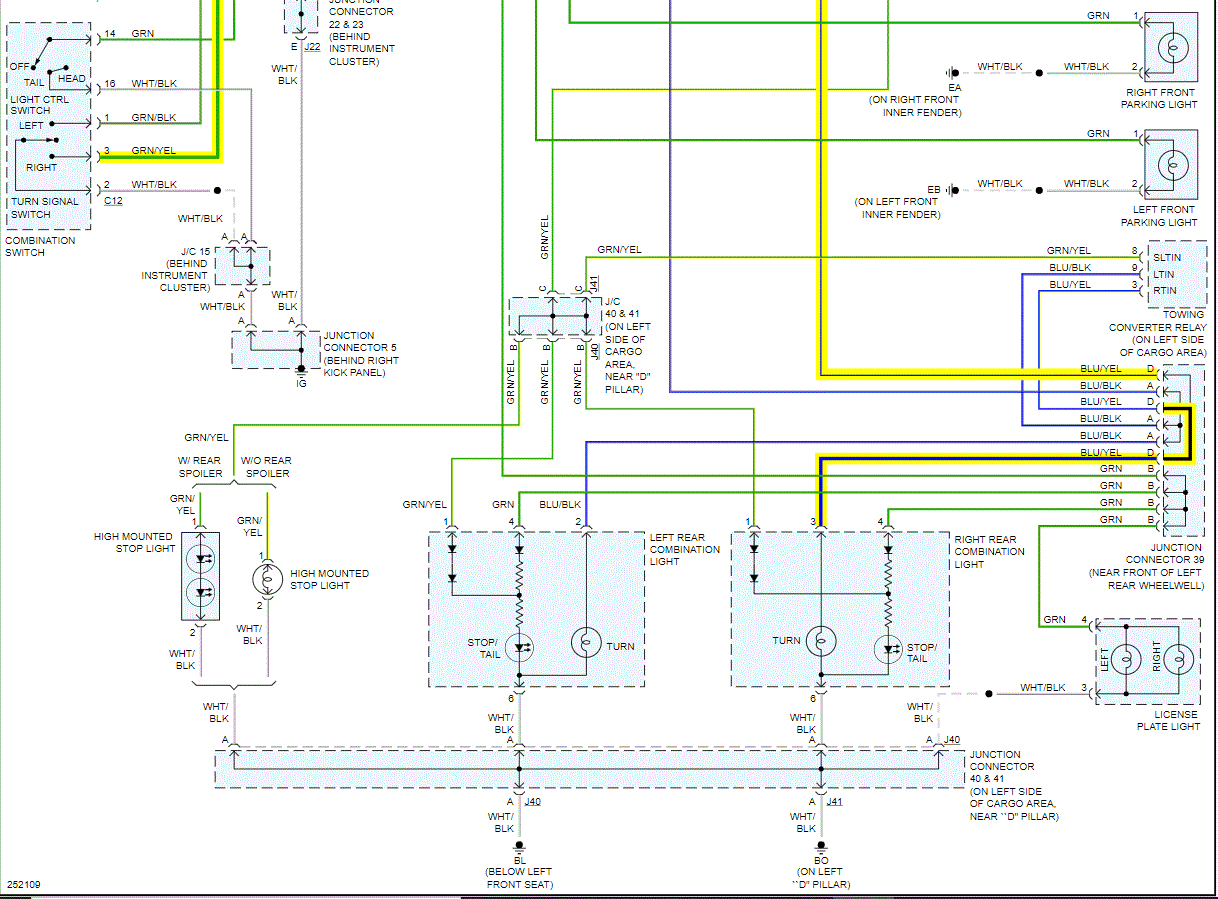

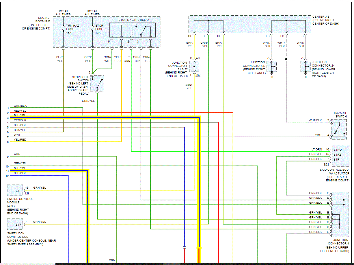

Here is what I need you to do: First, I attached the wiring schematic for the exterior lighting system below. At the signal lamp (rear) will be a blue wire with a yellow tracer. Using a test light or voltmeter, make sure you have a good ground and then with the signal on, check for power at that wire.
Let me know. Also, the wiring schematic goes all over the place. LOL, I highlighted the wiring from the switch to the signal bulb so you can follow them.
See pics below. Note: The original schematic was two pages long. I had to cut each page in half to make them readable for you. However, I did overlap them so you can follow from one to the next.
